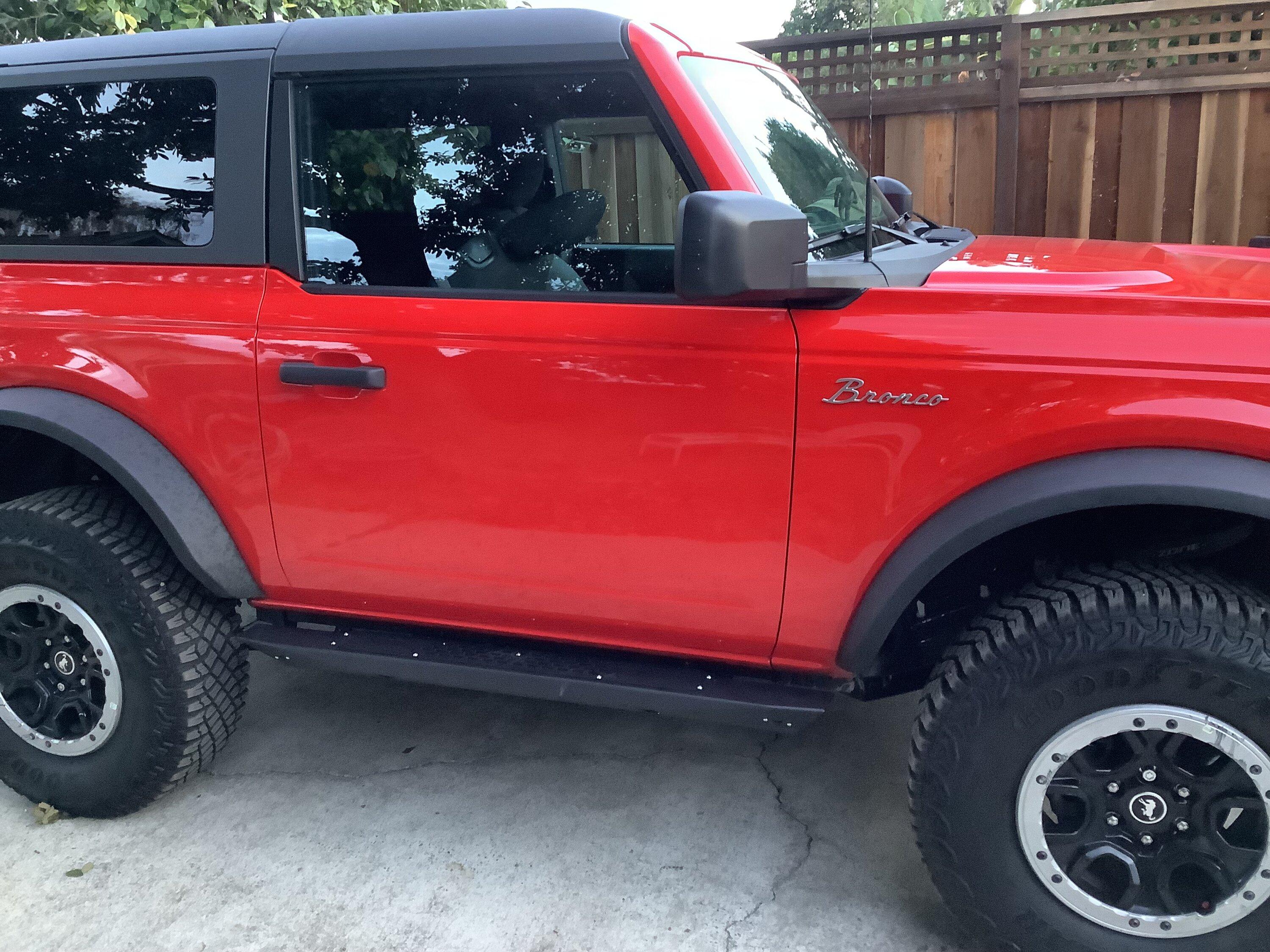

You will need more than a 2” lift to properly run 37”s…I am all set up for 37’s but actually pretty happy with my 3” lift on stock 35’s so in no rush to bump up…
Ford Bronco 35s or 37s…? IMG_0424

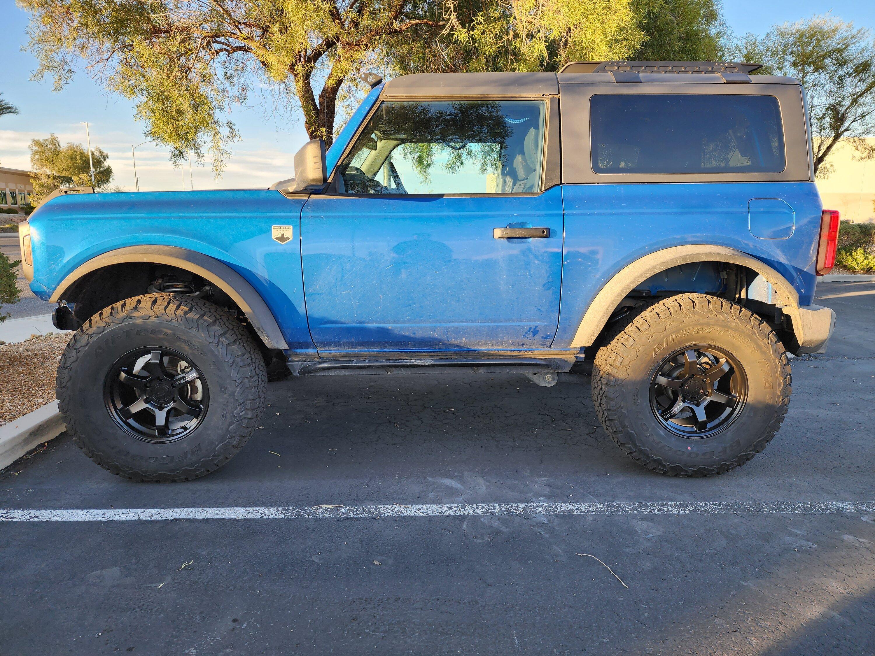

Just finished 2in spring lift and 37s on my SAS 2dr. To me, it now looks as it should have from the factory
New wheels -10lbs and tires still load C, so weight is the ~same. On road manners not far from OEM 35. Rebound stiffer but not by much and I think that will improve with time. 6112 will be better than my setup
Mpg definitely getting hit with larger rotating mass but not sure how much yet
Ford Bronco 35s or 37s…? 20231110_155146
