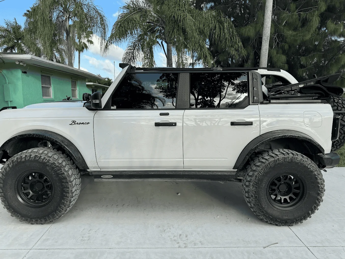

Currently running Icon Stage 3 coilovers, DirtyLife Mesa wheels, 17x9 -14 offset, 37x12.50 STT Pro tires!

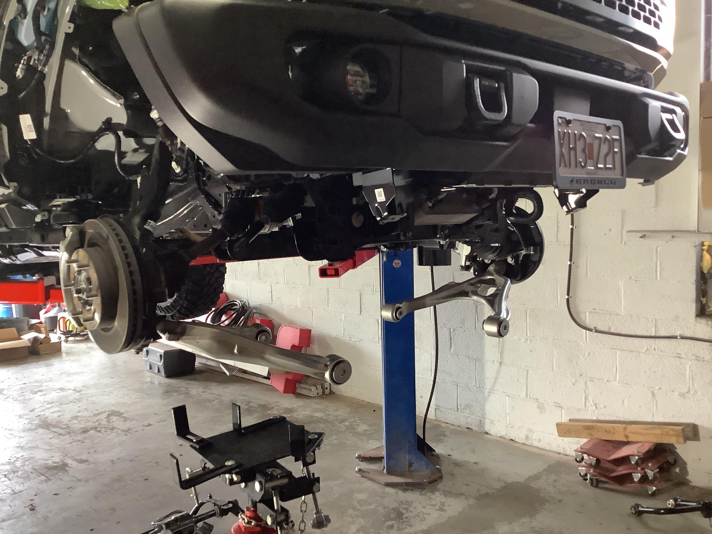

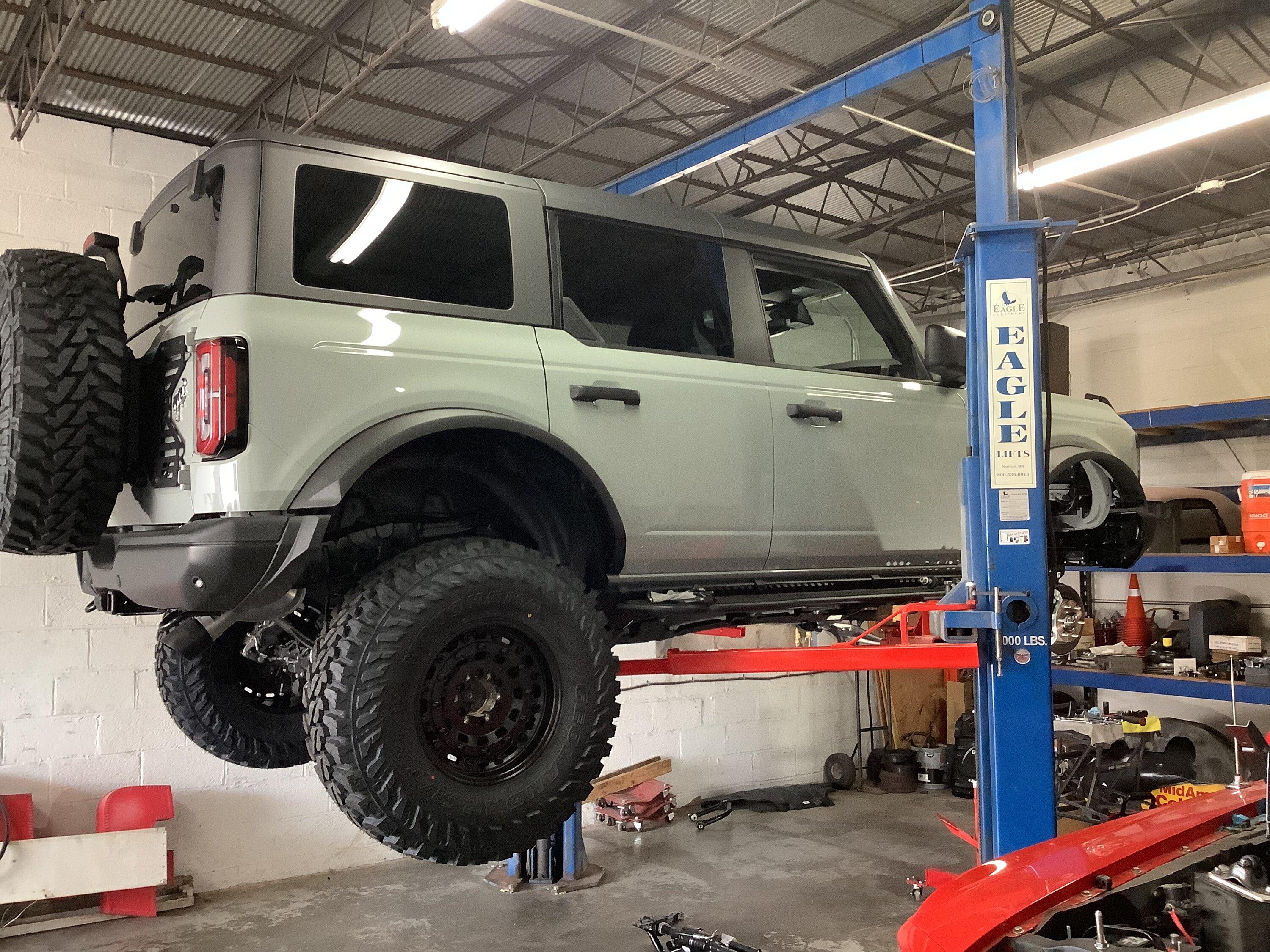

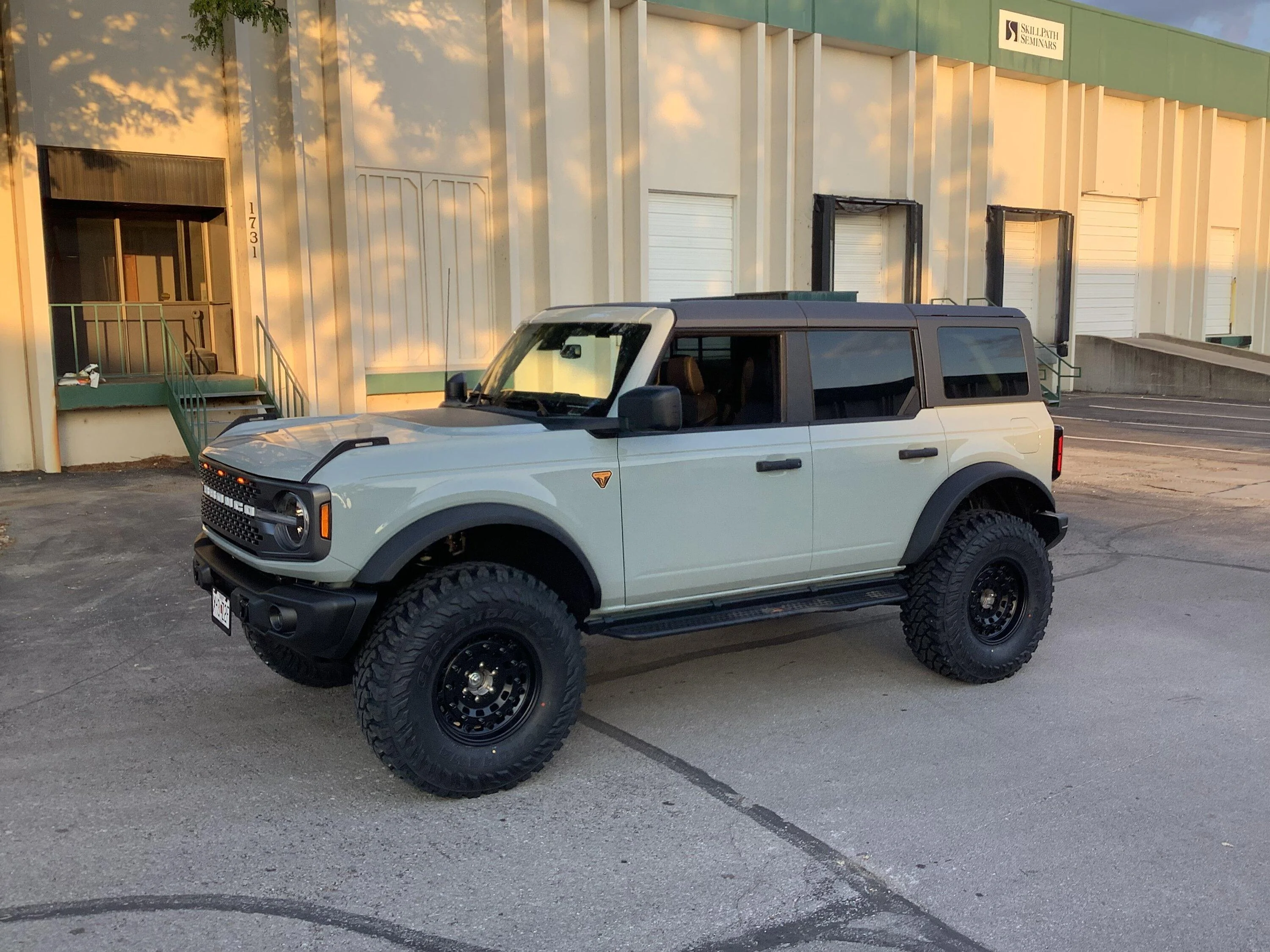

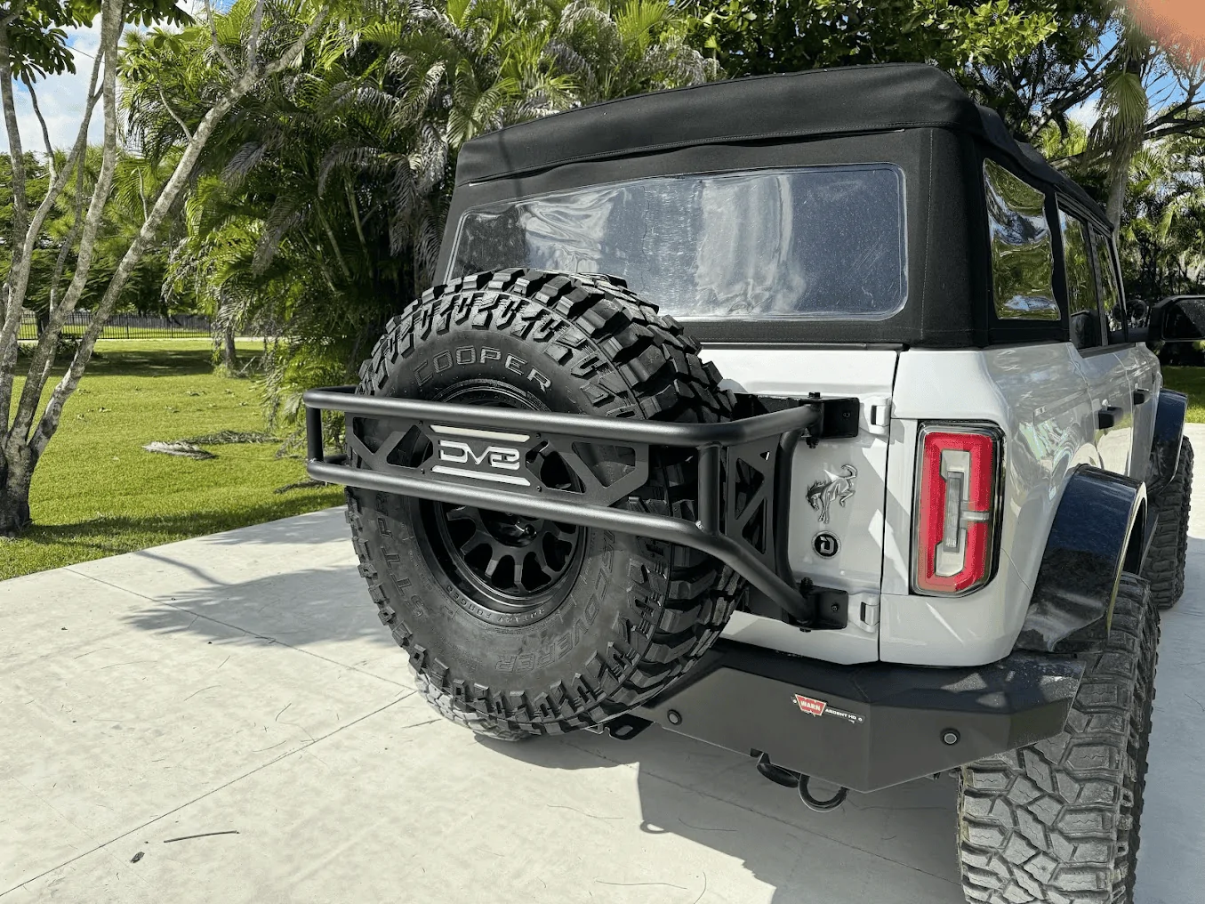

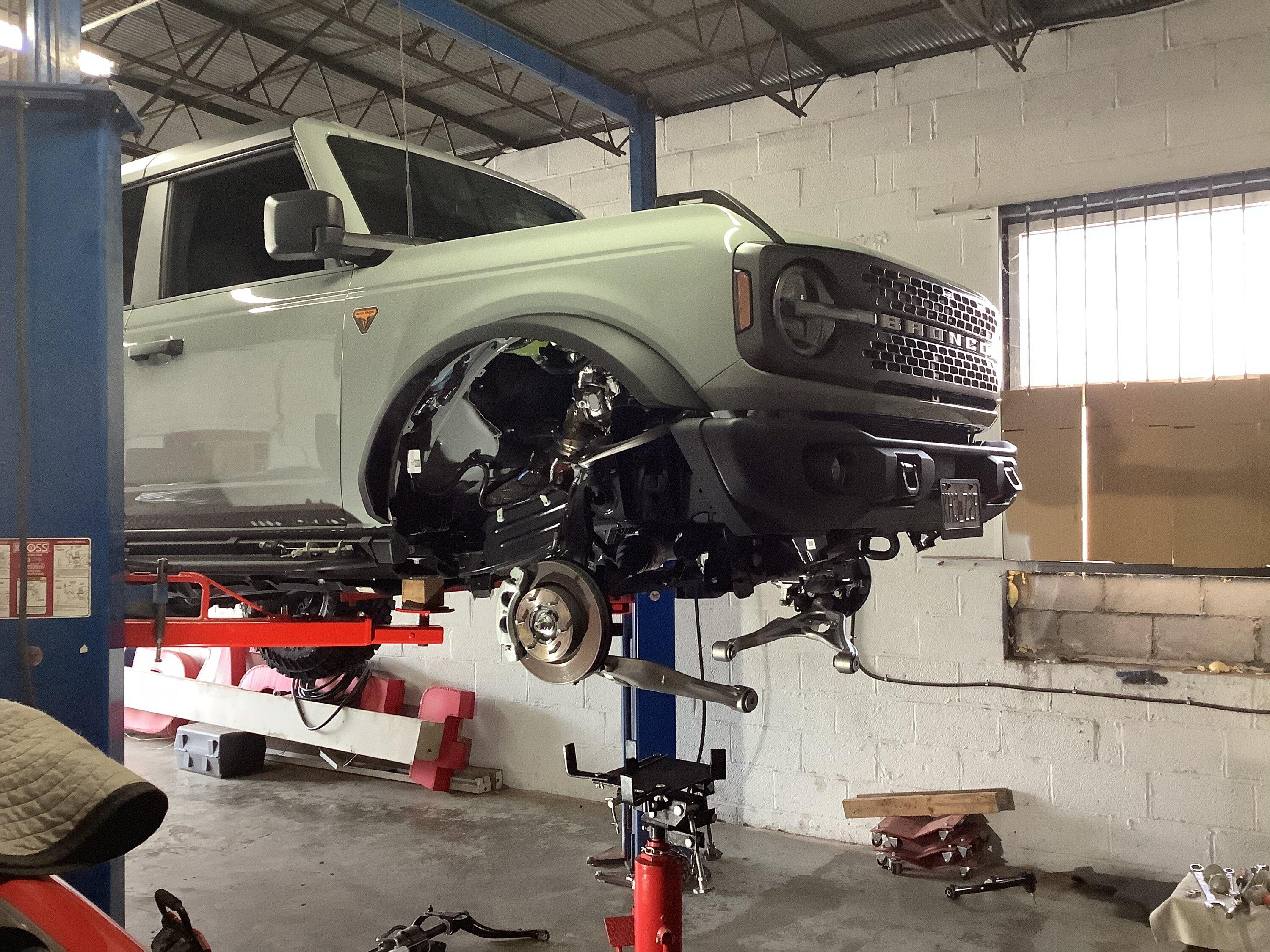

Well, I started as a NoN-SAS but I knew I was going to do my lift. I have the Fabtech lift and I went 37's Love it.
Ford Bronco 35s or 37s…? 1700337705553
Ford Bronco 35s or 37s…? 1700337824504
