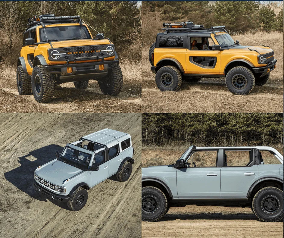

35x12.5 is not a 'move up'. It is the same size as the 315/70R17
315 Goodyear Duratrac is 34.4 x 12.7
35x12.5 BF Goodrich K02 is 34.5 x 12.5
Depends on the tire... Ridge grapplers are 34.7 vs 34.4, others are closer to 35. It's not a big enough difference to matter, but I doubt we can fit 37s.

37s will not fit on stock tire rack. At a minimum you will need a aftermarket rear bumper, 3rd brake light, etc..

I definitely want to move up to at least 35x12.5 tires when the stock 315s wear out...I would think these should fit no problem on a stock bronco (obv Sasquatch).
You will move up nominally in height, depending on brand, you will move up a lot in weight and down in MPG with an E rated tire.

@395N There was also a really good picture of both this Bronco and the 4 door Cactus Grey one that I saw. It showed a really good perspective on the different size between the two. However I can’t seem to find it ?‍♂
There’s just some question about whether the 4 door has 33s or 35s lol.
Is this the one you are talking about?

No but thanks. There was one specific shot from down low that you could see the differences in tire size.
However, since then the tire sizes for these prototypes have been confirmed. 37s on 2door, 35s on 4door. ?

While I am entertaining the option to run 37's, I would not be hanging a 37 off the back. Too much weight jostling around back there. I'm kind of curious as how well the tire carrier will hold up with a 35 on there.?
Aftermarket will solve the swing gate plate for 37's.

Going to run the same Toyo Open Country MT 37s / Method Grid combo as my Raptor on a 2 DR Cactus Badlands.. Took minimal effort and no trimming to get them on (Geiser progressive springs)
