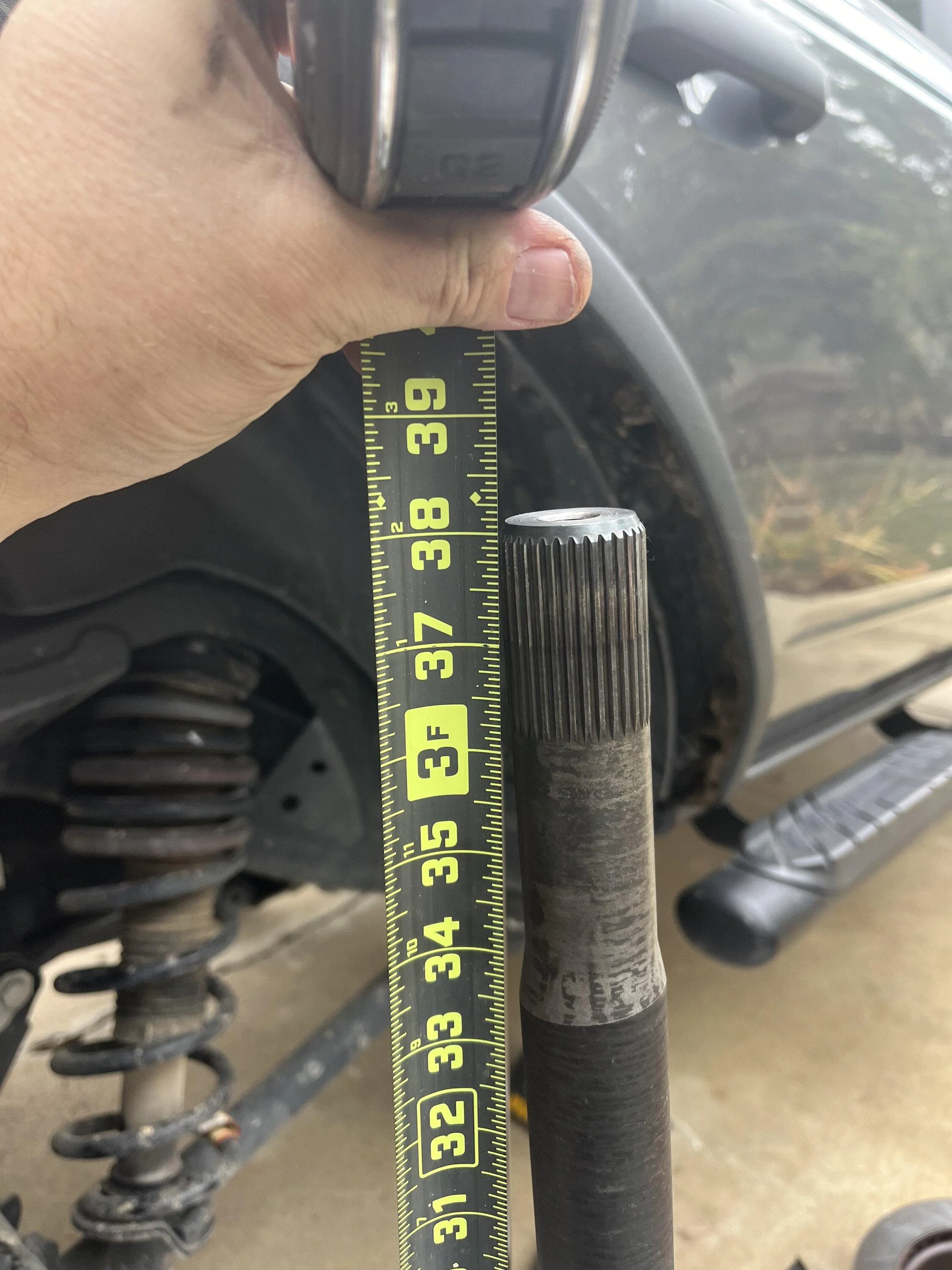

I had the opportunity to pick up a takeoff 4.46 Locker rear end, so I was able to pull shafts from both the Standard and Locker rear ends and set them side by side.
It appears the pumpkin sits a bit to the left on the Locker version compared to the Standard.
Here are the shaft measurements - don't take these to the bank, this is me eyeballing with a tape measure.
Standard
Left - 33 1/4" stamped 92
Right - 37 3/16" stamped 97
Locker
Left - 32 3/8" stamped 22
Right - 38 1/8" stamped 21
Photos - parallax makes the tape not quite look like what I eyeballed it at - again, I wouldn't take it to the bank.
Left shafts - tape on Standard
Ford Bronco 23 Non-Sas BB Adding Rear Locker IMG_1762

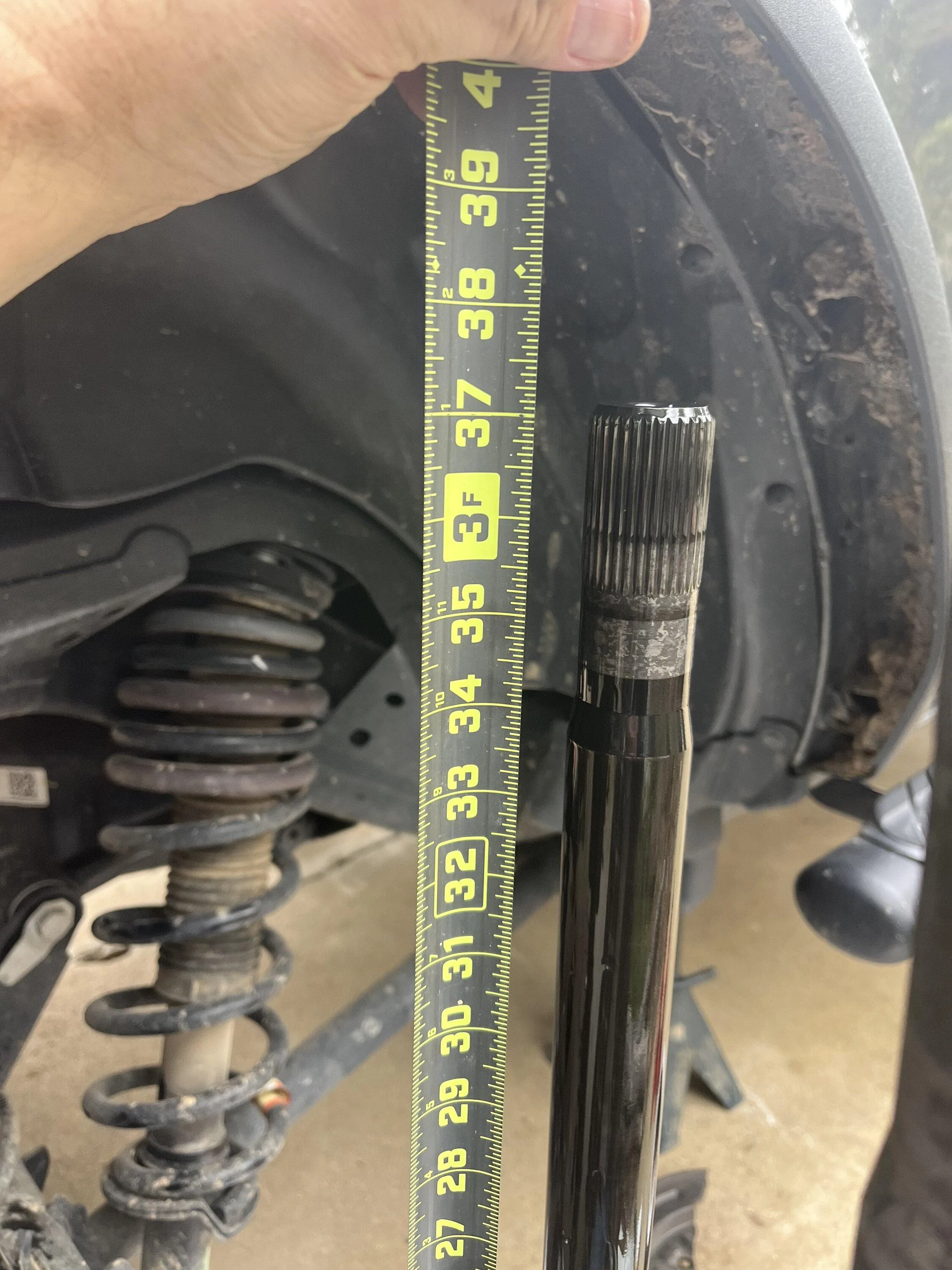

Left shafts, tape on Locker
Ford Bronco 23 Non-Sas BB Adding Rear Locker IMG_1763

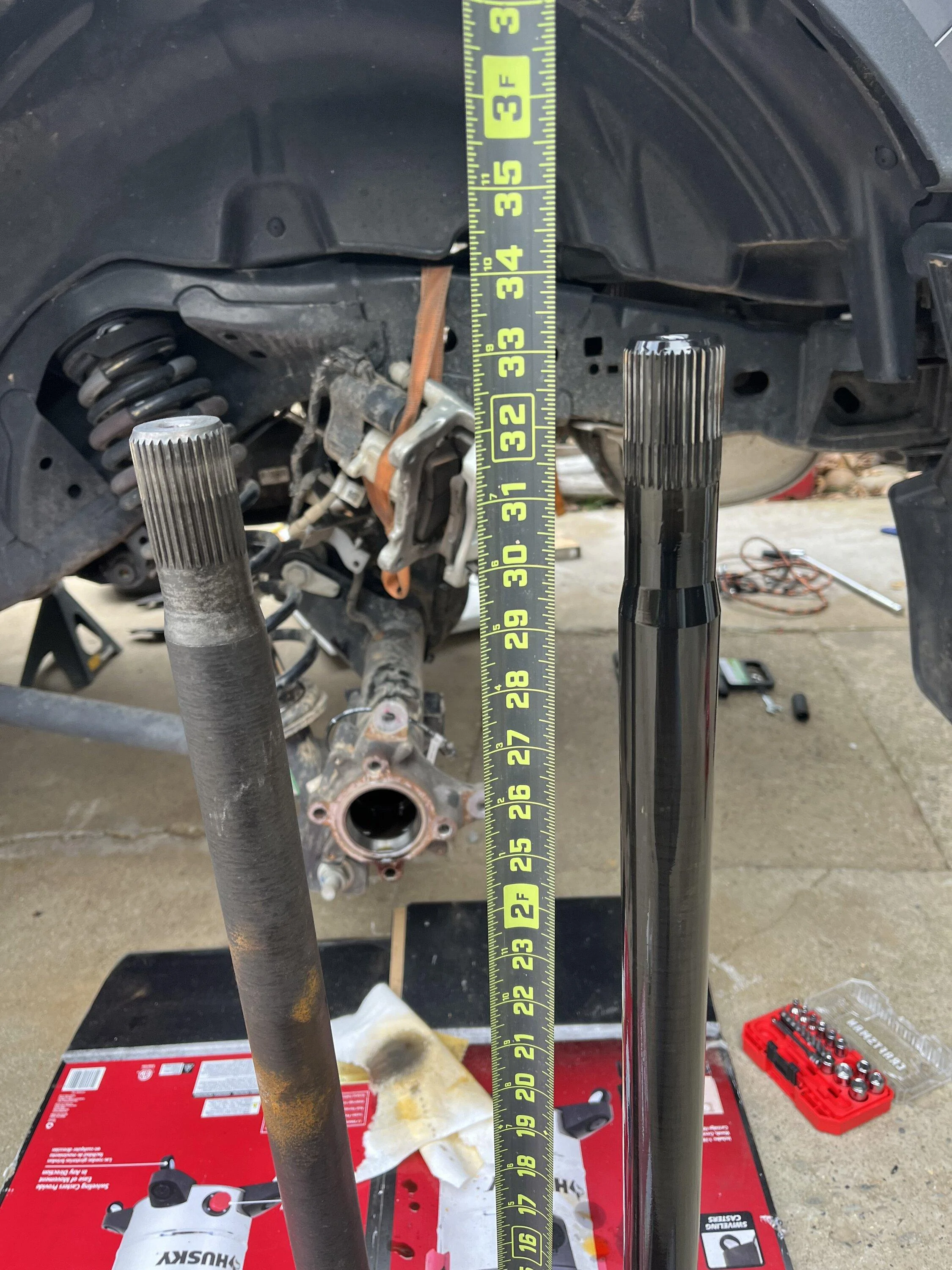

Right shaft standard
Ford Bronco 23 Non-Sas BB Adding Rear Locker IMG_1764

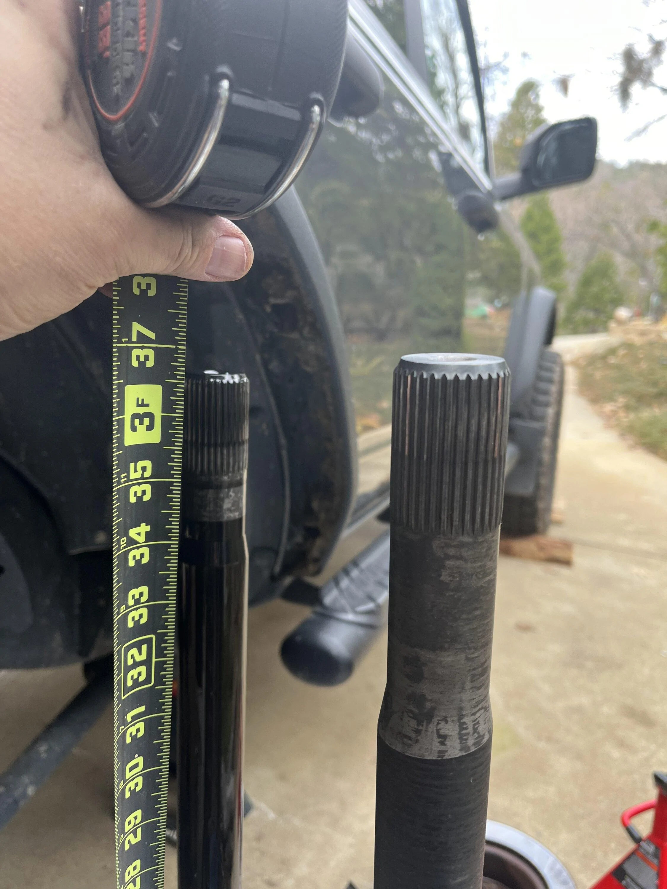

Right shaft Locker
Ford Bronco 23 Non-Sas BB Adding Rear Locker IMG_1765

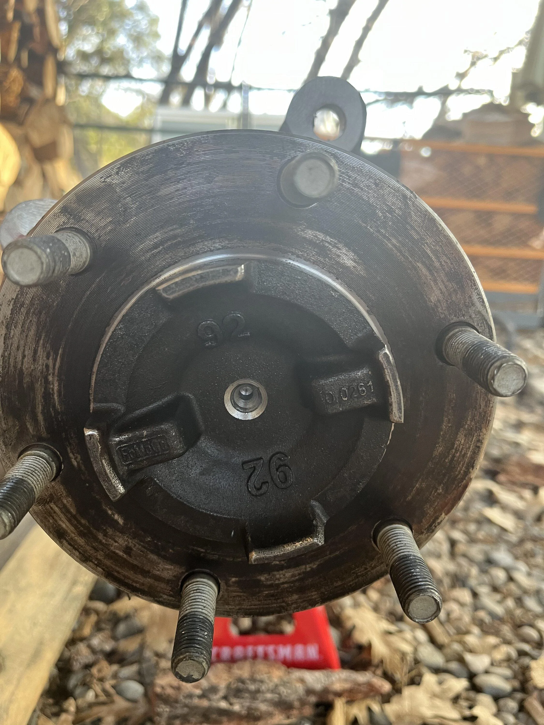

Pic showing the stamp on the hub, this is Standard Left
Ford Bronco 23 Non-Sas BB Adding Rear Locker IMG_1767
