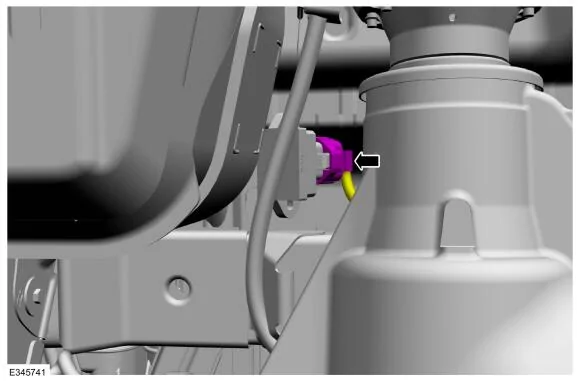

That sucks. Help me out, is this part of the fuel pump assembly or a separate control module?
If separate where is it located?
Basically right above the rear axle/fuel tank area
Ford Bronco 2025 Badlands died, Fuel pump module 1751546177858-s2
