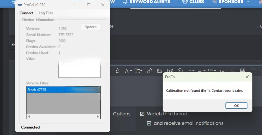

Im installing the tune tonight, well i thought i was, im getting this error message. anyone ever seen it? and yes the VIN is in there, i just erased it because i got scammed this week out of a C-note and i trust no one...........
Ford Bronco 2025 2.3L Ford Performance Tune procal error messag

im only answering this because i asked the same question today. not that it matters!!! i guess the ford cal team isnt done writing my tune software yet...... thats a thing?!?! i have to wait till they finish. i dont get it
