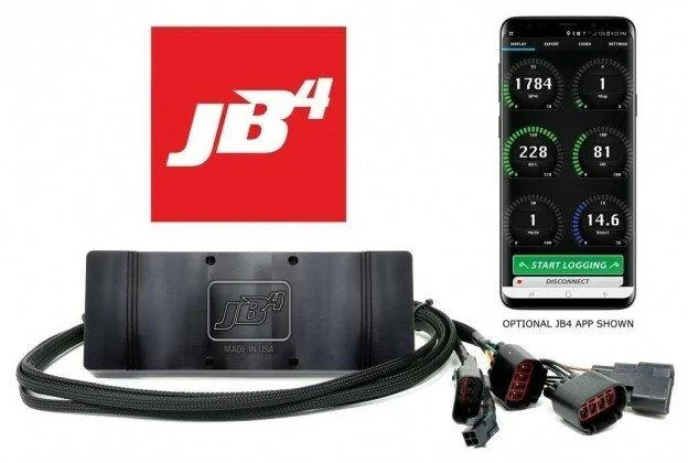

The JB4 will see higher gains than the Ford Performance cal. On the flip side the Ford Performance cal does give you the ability to re-calibrate the speedo for the 35's you put on your Bronco.
Both are great products. Just depends what means more to you. Since you said you really don't care about your warranty and just want to make more power I'd day the JB4 is what you'll want.
We have plenty of them in stock so feel free to give us a shout if you have any other questions or need help placing an order.
Thanks!
https://www.lethalperformance.com/burger-motorsports-jb4-tuner-2021-ford-bronco-2-3l-2-7l.html

If you don't care about the warranty, get a custom tune. The Ford Performance tune is going to be extremely conservative. The JB4 just fools the computer to make more boost. Take a look at the Whipple tune.

The JB4 is what I'm planning on doing. I want to have the gauges, easy logging, easy firmware upgrades, map switching etc. The jb4 has the canbus interface so its reading tons of engine data and will work very well, otherwise I'd probably suggest a flash. I've been running JB4's on several vehicles for many years without issue and the gains are greater than the Ford tune.
