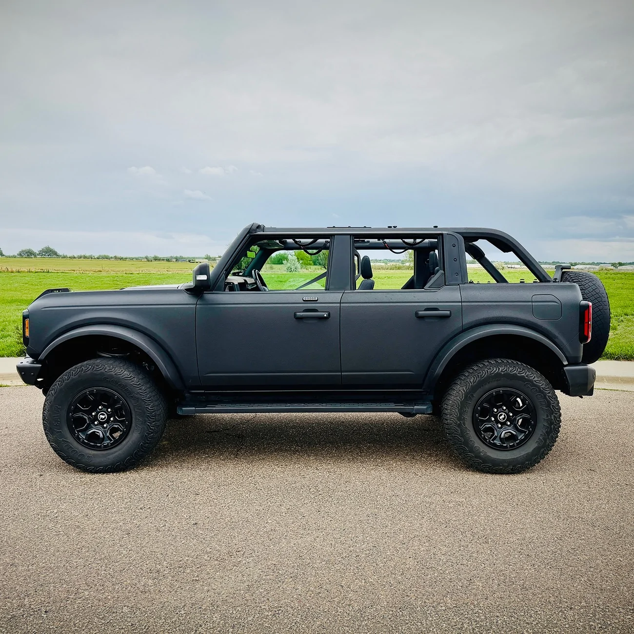

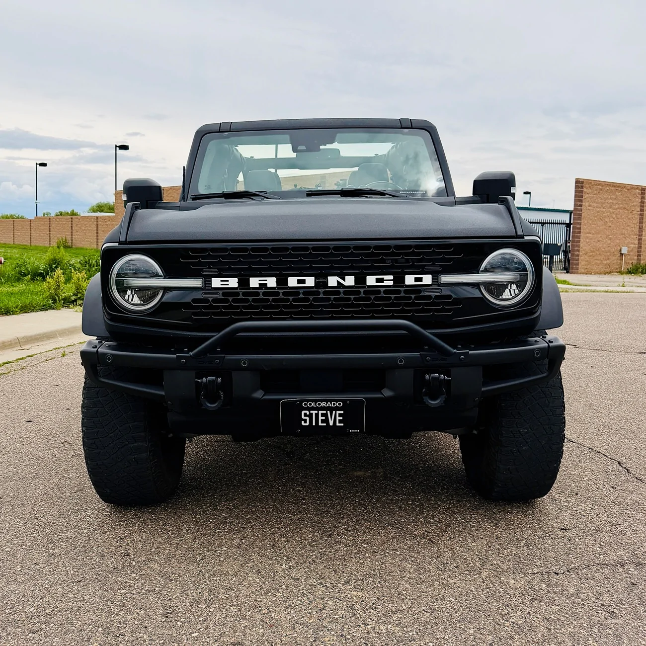

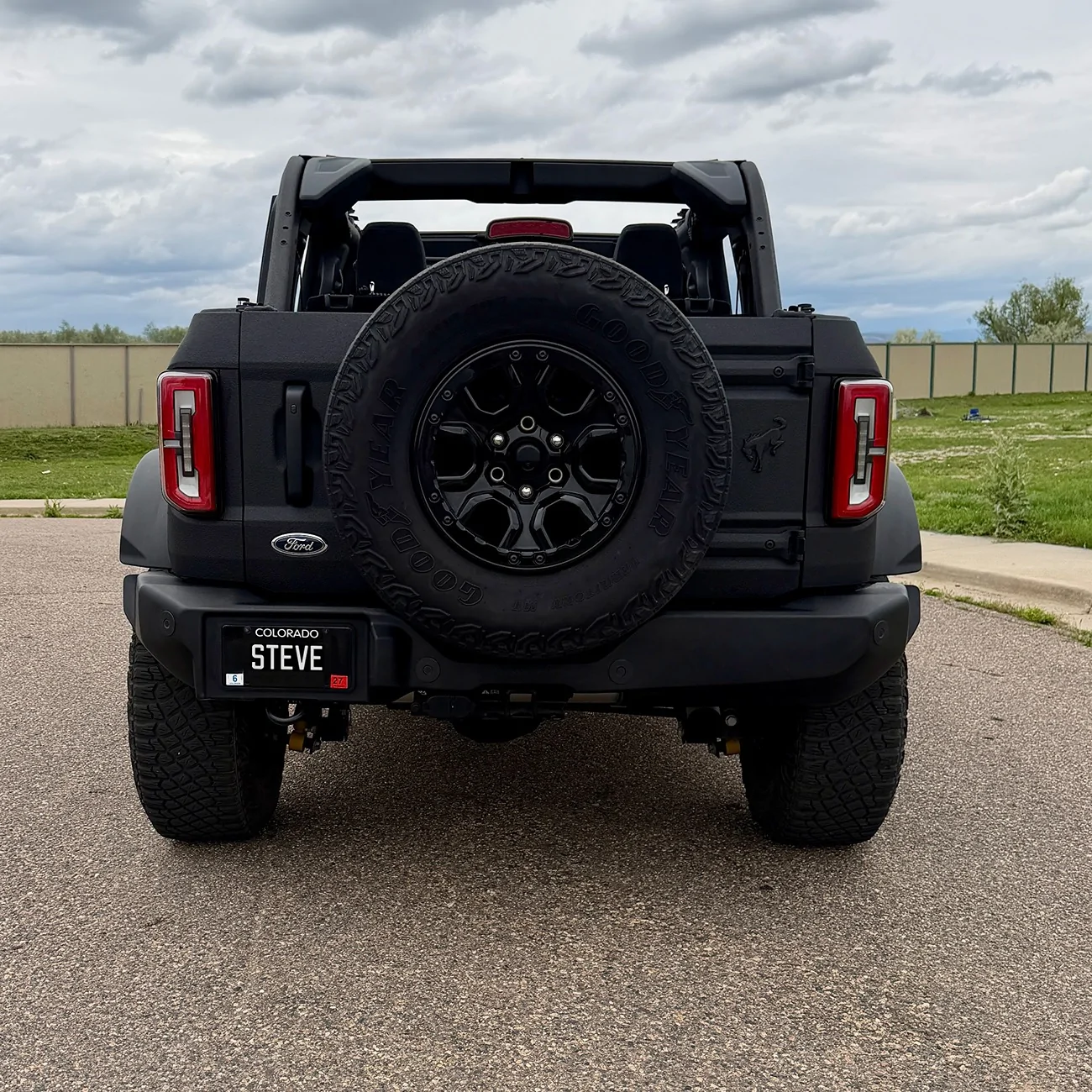

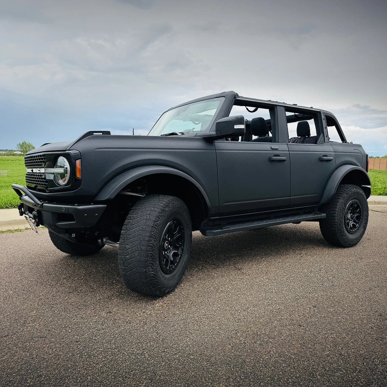

Hello. I’m new here. Picked up a pre-owned Wildtrak last year and absolutely love it. I’m getting close to needing some new tires and am curious about going up in size to some 37s. Looking at the Goodrich KM3 tires. I believe the previous owner added a leveling kit. I’m new to all of this so appreciate any words of wisdom. Thank you.

Putting on 37s is doable, but not the most straightforward thing. What you need to do depends on your suspension. If you have Bilstein shocks (Hoss 2.0), any kit that works with the Sasquatch package works to keep the stock suspension. If you have Fox Shocks (Hoss 3.0), your options are more limited if you want to keep the same suspension. At some point, all Wildtraks went to Hoss 3.0 (Fox), but I'm not sure what year that was. To get to 37s with no rubbing, you have to get a lift (I'm not sure if a level is sufficient), Cut off the crash bars in the front and move the tires out (with either new wheels or spacers). You will also want to reinforce the tailgate for the extra weight of the larger spare, or do a delete, if that's your thing.
I have the Hoss 3.0 and it took:
- Zone Offroad Lift Kit for Hoss 3.0
- JKS Max Tire Clearance Kit
- 1.25" wheel spacers
- Mountains2Metal Tailgate Reinforcement
I have wheeled this setup pretty extensively and put thousands of highway/city miles on it. Everything feels very close to stock and I''ve been very happy.
I can't comment on whether the leveling kit will do the trick, but when you go up in lift, you will likely want to go with beefier upper control arms (they are included in a lot, but not all, lift kits).
Anyway, hope this helps.

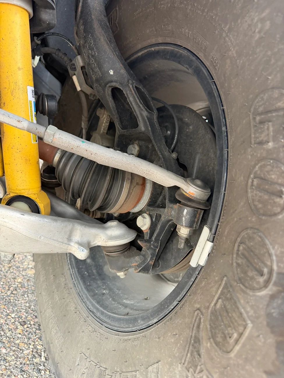

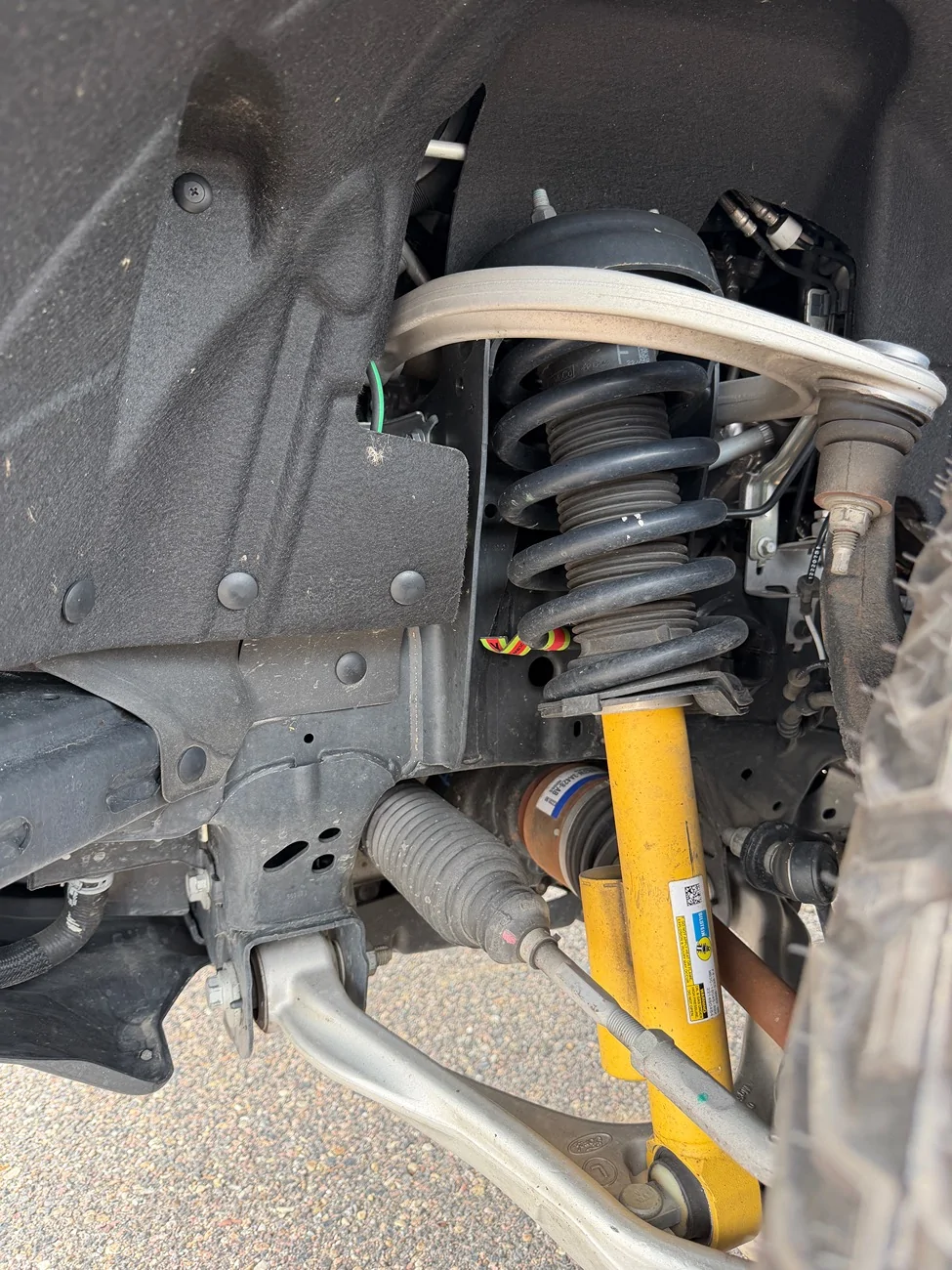

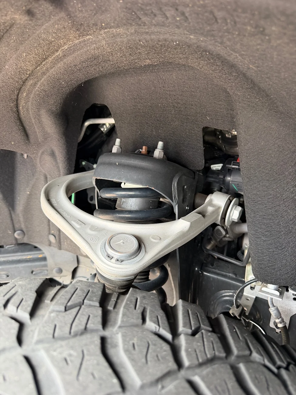

Super helpful. Thanks for taking the time to give me all that info. Here are a couple more pics. I believe I have the Hoss 2.0.
Yup, those are the Hoss 2.0 Leaky Bilstein shocks.
Check the rear reservoirs for the bandaid kit, or if it's leaking. You might get a free replacement set!

Hmm. I’m wondering if I should stick to 35s. If so, what do y’all think is the beefiest looking 35 out there?

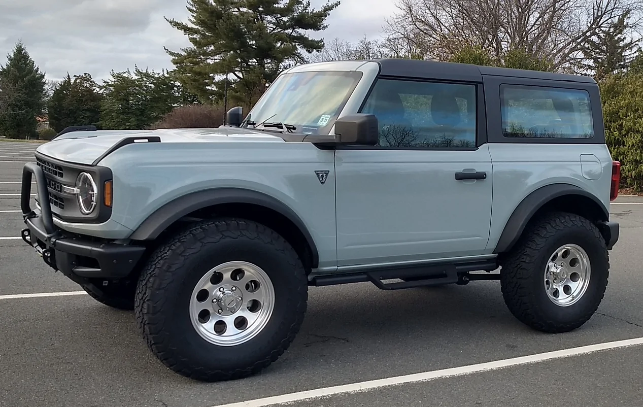

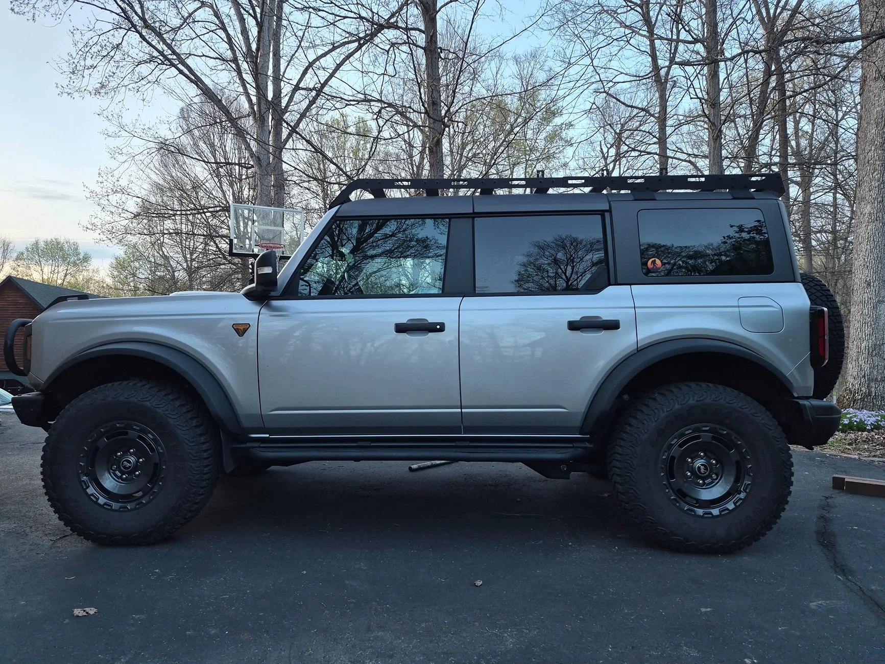

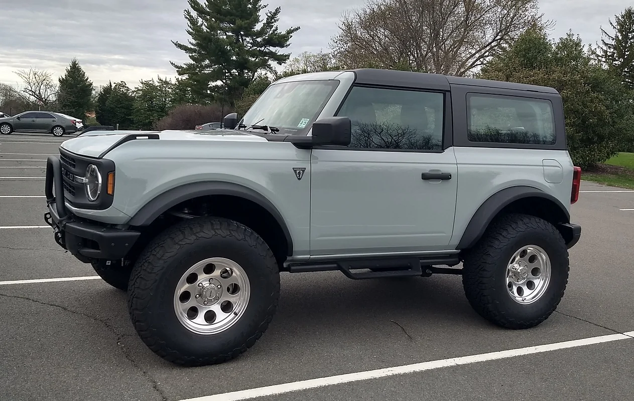

It looks like you might have a level kit up front since it looks almost the same as the rear. Check at the very top of your coilovers just under the mount on the frame for a small spacer. You could probably get away with a small 37 like the 37x12.5x17 KO2 or KO3 but with the stock wheels it might rub on the inside crash bar mounts at full turn under flex. I put the Ko2's on my stock base Sas but I have 17x9 with -6 offset wheels and they rubbed a little. So I went with 2" over Sas/Wildtrack and it works fine.
Stock base Sas with 37's:
Ford Bronco 2022 Wildtrak 35 to 37s? mybronco_37stock3
You look like you have more room up front so I'm guessing a level kit.
2" lifted base Sas with 37's:
Ford Bronco 2022 Wildtrak 35 to 37s? mybronco_37procomp2

Great pics of the front suspension. It does appear you have some extra lift over stock Sas, yet I can't see the evidence of upper or lower level kit spacers. You could have collars installed, which would explain the height. Regardless, you are in the market for new shoes!
