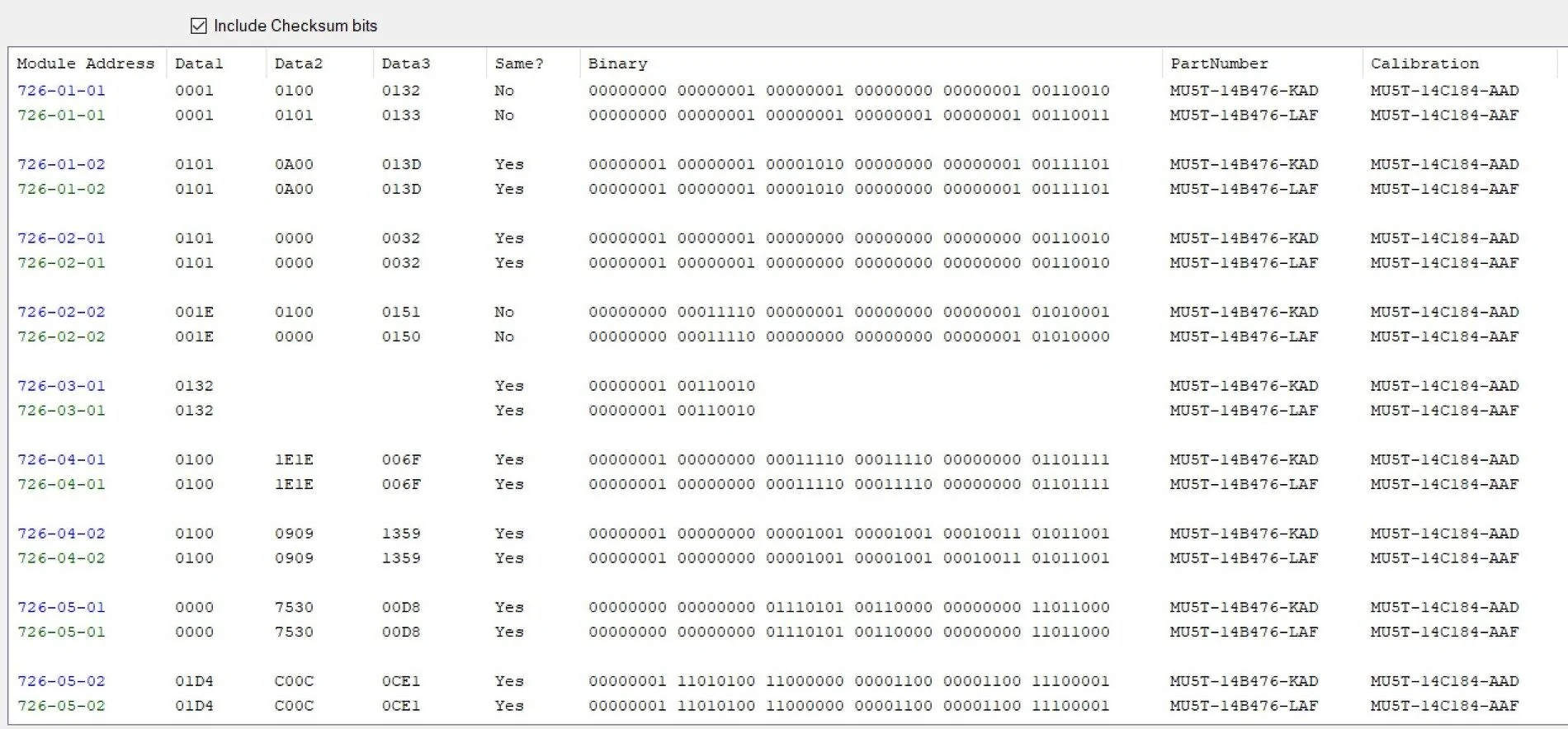

I compared the calibration file from a 4 Door Full Size Bronco to the modules in my 2021 F150 and to no surprise most of the ECU's are the same. There's different calibration strategies to keep in mind, but Bronco owners can get a big head start with their ForScan mods by reading through this:
https://www.f150forum.com/f129/forscan-14th-gen-f150s-481816/#post6669208
The Bronco's IPC has more configurations than the F150, but many settings appear to carry over.
Ford Bronco 2021+ Bronco ForScan Thread Bronco BCM
I used Bronco VIN-1FMEE5DH7MLA63097
So... welcome to the F150 forums everyone.

I tried a few today, but didn't really have much success. I tried three different ones: auto start/stop, seat belt chimes, and double honk when exiting. It still shuts the engine off at stop lights, and still chimes when I don't fasten a seatbelt and begin to pick up speed. Forgot to test the double honk. Am I just not understanding how these work, or did I muck up the process somehow? Any way to check?

When I compare the Double Horn Honk to the F150....they say they are not the same:
Vehicle Num, Module Address, Data1, Data2, Data3, Same?, Binary, PartNumber, Strategy, Calibration
1, 726-41-02 BCM/GEM Body Control Module / Generic Electronic Module (BCM/GEM), 2000, 0000, 00, No, 00100000 00000000 00000000 00000000 00000000, MU5T-14B476-LAF, , MU5T-14C184-AAF
2, 726-41-02 BCM/GEM Body Control Module / Generic Electronic Module (BCM/GEM), 2000, 0000, 01, No, 00100000 00000000 00000000 00000000 00000001, MU5T-14B476-KAD, , MU5T-14C184-AAD

Going back to the original is a good idea. I compared an F150, Ranger, and Bronco. None of the settings that seem to matter (the ones most people would want to change) appear to be the same at all. But hopefully, I am wrong. Or hopefully, someone can point us in the right direction.

OK so I did some more digging because I loaded up the modules again today to do a restore, and it turns out they were already at the defaults. The modules aren't actually being written, and I'm not sure why. When I click on "Write" I get an output in the log that says "Service Procedure has been Interrupted."
I'm using the OBD MX II Bluetooth adapter and a windows laptop. It has no problem connecting or reading. I just can't seem to write the modules and not sure why.
I'll be googling for an answer, but if anyone has any ideas, please throw them my way!

From my initial research, it seems to be a combination of Ford's new 2021 electrical architecture, coupled with certain kinds of adapters. I'll probably purchase a different, wired adapter and try that too before giving up and letting the forums solve this issue. If anyone else has seen this same problem, please let me know.
