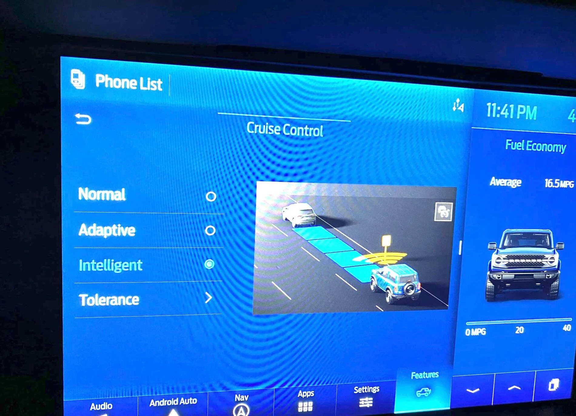

I will potentially try this soon. If I had to guess it's 04-03 x*xx xxxx xx-- changed to 0
Trust me, there's some big stuff I'm trying to get working like Lane Centering/S&G/IACC. I have made some progress but haven't been able to test it out just yet but......
As far as the Lincoln, I know Sync 4 is only out on Navigator right now. It's actually a bigger screen (13.2") and they're listed "Letterscape". There is a new Focus that also has this 13.2" screen and I found themes for both. There is a term "Dashcard" added to them and I found a 12" with Dashcard tied to it so best guess would be try the one for 12". I worry the aspect ratio would be wonky using the 13.2".
It would be in the APIM:
7D0-03-01xxxxxxxx**--03= 12" Landscape (Current)
05=Lincoln Sync 4 13.2" (Dashcard)
06=Ford Sync 4 13.2" (Dashcard)
0A=12" Landscape (Dashcard)

So part of trying to get Lane Centering to work I had to figure out what module we have. For starters, the IPMA (camera in the windshield) is the same across all Bronco trims. Further, the module is the same between a Lincoln Aviator (Lane Centering) and the Bronco albeit insignificant part number variances for branding. Once I observed that I stopped trying to reference the wrong vehicles and began referencing the Lincoln Aviator. I feel like I have made some progress but I haven't been able to test and verify just yet.
In summary, for adding ACC you would need the CCM (Cruise Control Module) which is the front radar antenna and harness, the steering wheel switch, and the patience (someone's) of reverse engineering the coding. Thankfully there is easy enough cross referencing.
