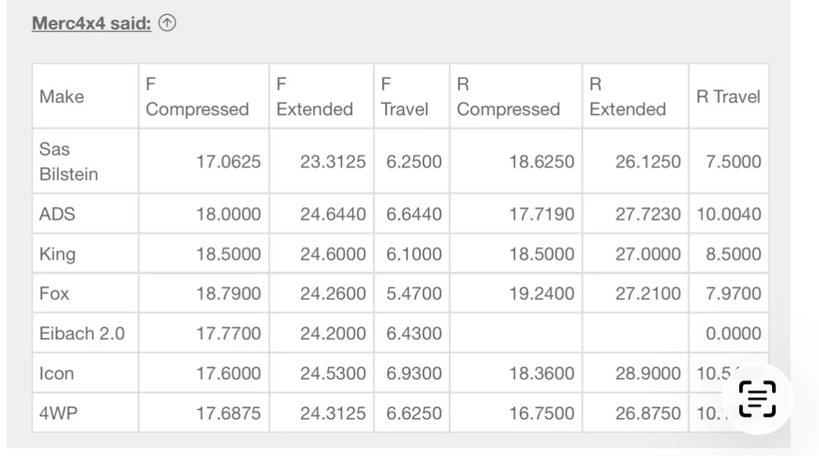

The coilover length, from frame mounting surface to LCA mounting surface, dictates CV angles. In OEM FDU configuration, the maximum allowable length is very close to 24.3”. At which point CV angles exceed allowable and physically begin to bind. This has been accurately verified, and almost all aftermarket coilover manufacturers adhere to this limit.
Stock SAS coilover length at full extension is 23.3”, so a 1 inch long spacer will not cause CV binding. No diff drop should be necessary. A 1” long spacer on top of SAS shocks will produce roughly a 1.6” lift. Average motion ratio at SAS ride height is 1.6. So general consensus is that >1.5” spacer lift is not recommended.
Perch collars do NOT affect coilover length, so they will not alter CV angles at full extension. They do however, alter the shock equilibrium position at ride height. Resulting in greater available jounce travel than rebound. I prefer having my shocks ride near mid stroke so would not opt for a perch collar.

Yup, I agree with Z^. For stock shocks the Zone kit is arguable the best option for a mild front lift. It keeps the axle geo in safe ranges, shifts your bump stops down for larger tires,maintains stock travel.
The perch collars also dont change the spring rate, they just change the preload, so the end of travel (droop) gets much harsher, but the neutral spring rate is the same.
The Zone kit is also adjustable, so you can do increments of .25” to dial in exactly what you want.

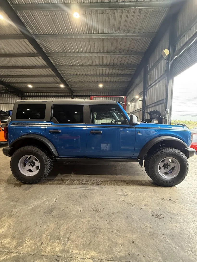

Kit istalled. Got exactly 1 inch of lift. My Bronco measured 40 inches in the rear and 38.5 in the front. (from the floor to the edge of the sas fender) now im 39.5 in he front for just 0.5 inches of "rake"

Looks good, the 1" in the front usually gets it real close to level and usually just a slight rake like that.

Looks as it should! That is the stance I am going for.
