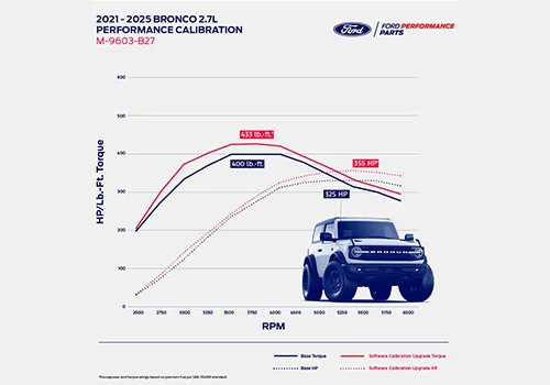

The dyno on the Ford site did not pop up. Are their numbers with stock IC, exhaust, intake? If so still great value. Would love to see the power bands.
Yes. The only tune Ford offers is the procal calibration which is just stock everything minus the new calibration. The numbers really aren't that great for the money compared to custom tunes, but if you're looking for a warranty, it is the only option.

True buy I tried a tu e one from a famous mustang tuner as was a total waste of money....anyway is there a link to dyno?

Wonder what looks like with procal Ford tune....stock not interesting at all

Yep, the 2.3 makes a significant difference, but the 2.7 Ford Performance Tune is meh. I don't think that it really brings 30 hp to the table.
