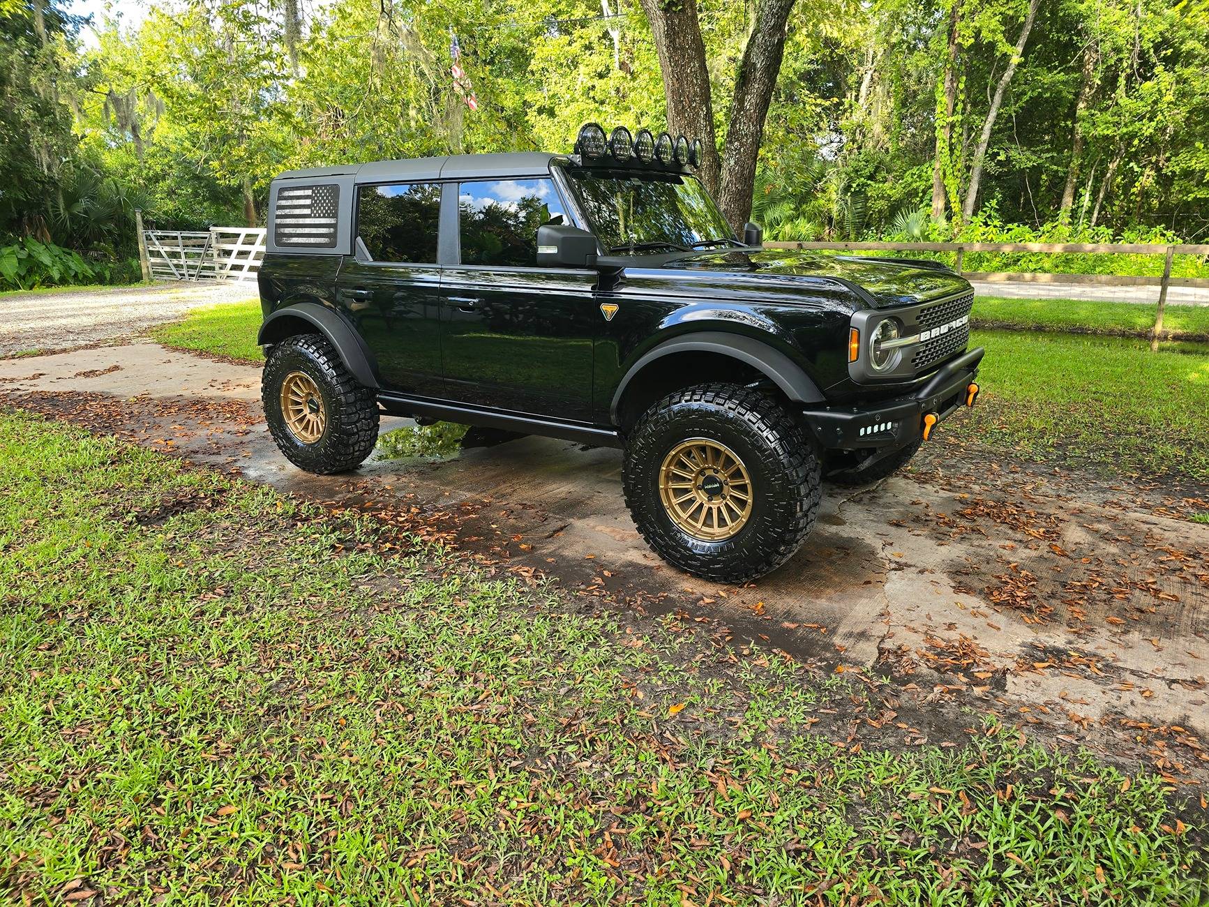

So I asked myself the same question.
I went with the Eibach Coilovers, UCA , 4link bars and Track bar , the added 37" Kenda Klever MT2 on a Zero offset Mayhem wheel . I couldn't be happier . Ride is so much better than Stock SAS , and articulation is so much Better . Any questions, Please ask
