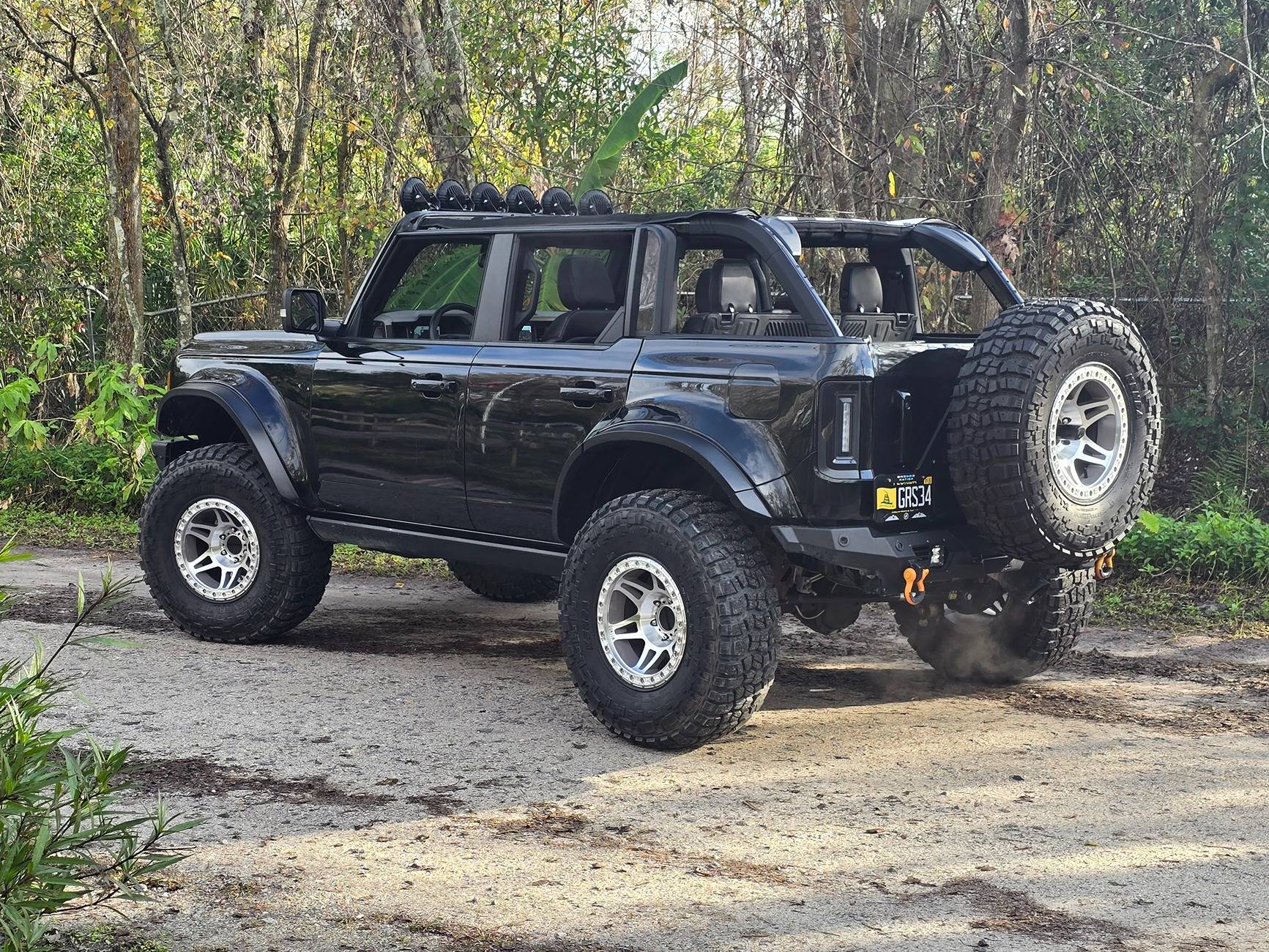

So I asked myself the same question.
I went with the Eibach Coilovers, UCA , 4link bars and Track bar , the added 37" Kenda Klever MT2 on a Zero offset Mayhem wheel . I couldn't be happier . Ride is so much better than Stock SAS , and articulation is so much Better . Any questions, Please ask
What is the benefit of adding the 4link bars and Track bar? Is it needed or just if you offroad hard/often?
Flying Skunks
Donnie
Aug 10, 2023
196
265
23 Badlands Sasquash
Not sure if it was needed , but part of the puzzle that I am making . Now getting ready to go to a Triangulated 4 Link rear . I like the adjustability and the flex .
Ford Bronco Zone 3" lift vs Eibach coilovers 20241231_092114
I have changed it a little since
