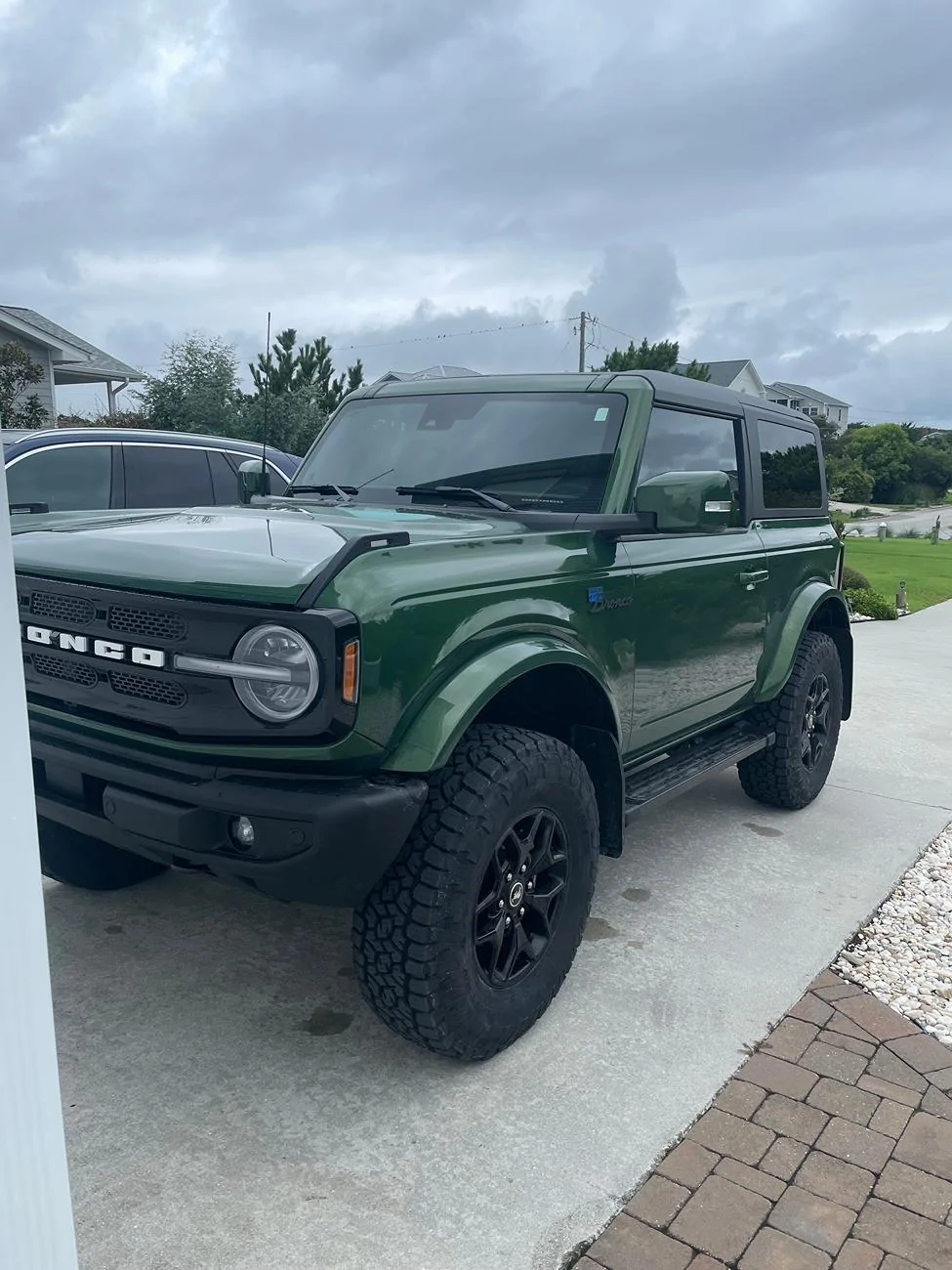

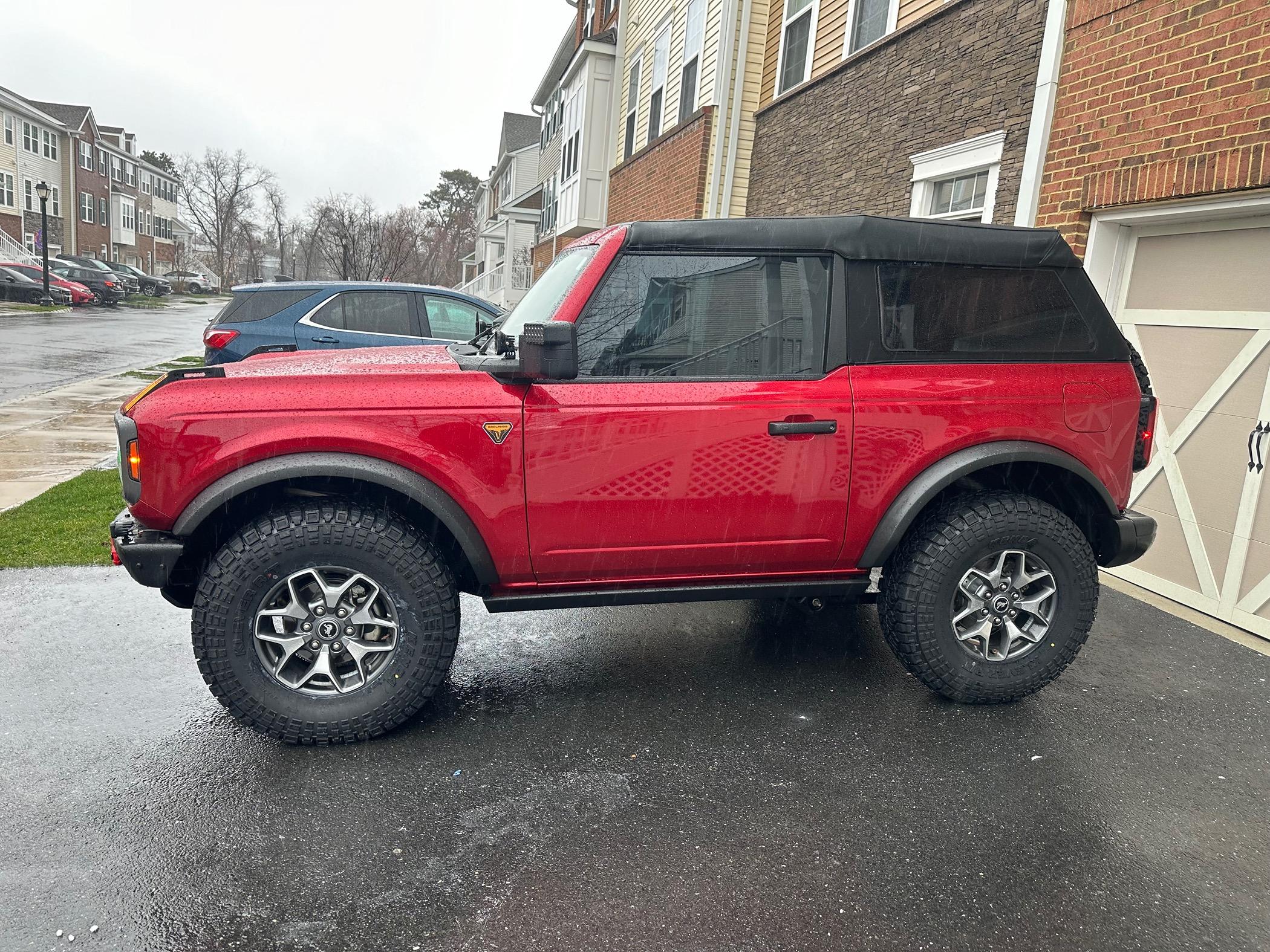

Lifting this week, what should I set them at for a lvl look, 1’ front/0.8 rear, or?
Thanks in advance

Mine are set at 2" front, 1.75" rear for just a slight rake but I'm a 4-door. Eibach claims they come from the factory set to be level. I'd stick them on the way they came out of the box and drive it a few miles before I made any changes.

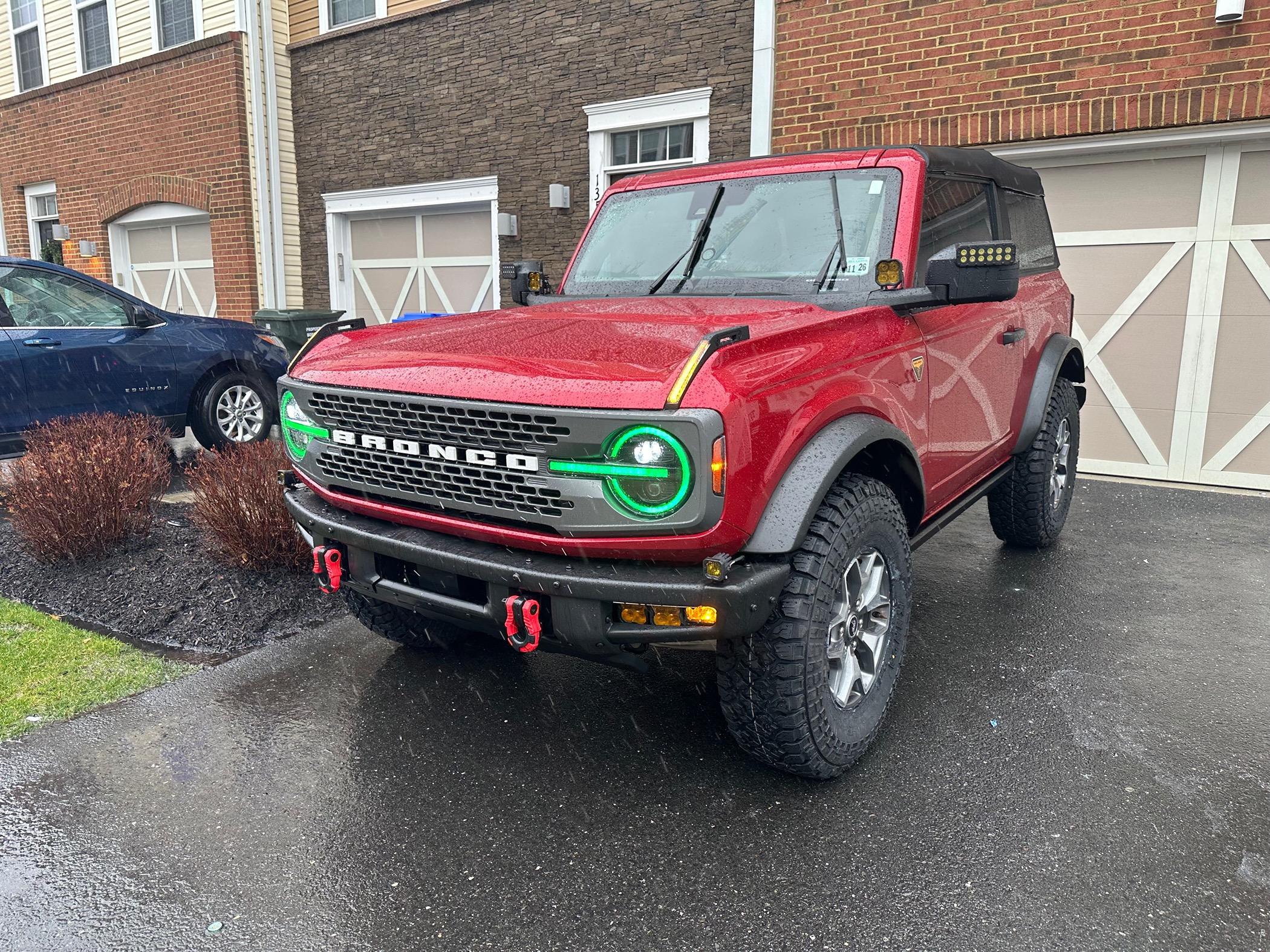

So , just recently installed the Pro Truck coilovers in my Bronco with SAS . My only " issue " is that we had to crank up the coilovers in the front to max to level . And we are about 1/8" low in the front . Wanting to try a few things to bring the front up , and back down the adjuster on the front to soften it up

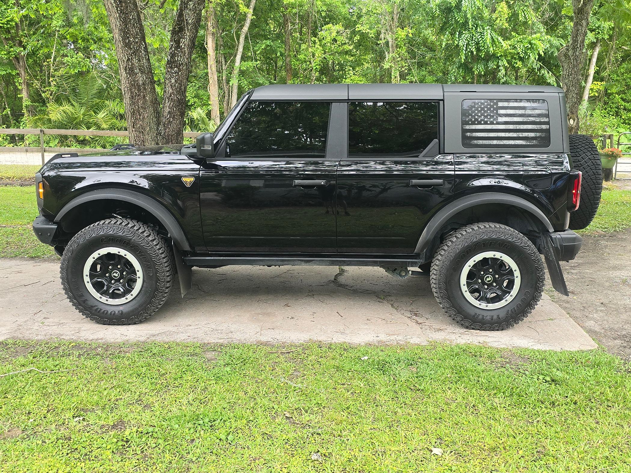

How much spring settle did anyone experience? The shop that did the installation used the out-of-the-box heights, and I'm wondering if I need to wait it out more for the springs to settle or adjust the springs to maybe 1/2 inch lower.
Also, how much of an adjustment requires a new alignment? I don't think I'd adjust these myself, so it's not a big deal but I'm just curious.

Not sure that I have had any spring settle . I will have to measure again .
Adjustment is easy , just remove the weight of the vehicle, and use the spanner wrench

I haven’t noticed any spring settle, but I didn’t measure either. 1/2” probably won’t effect alignment enough to re align, and the only thing that changed much when I installed mine was the camber.
Adjust them yourself. Spray a little wd40 on them helps turn them easier.
