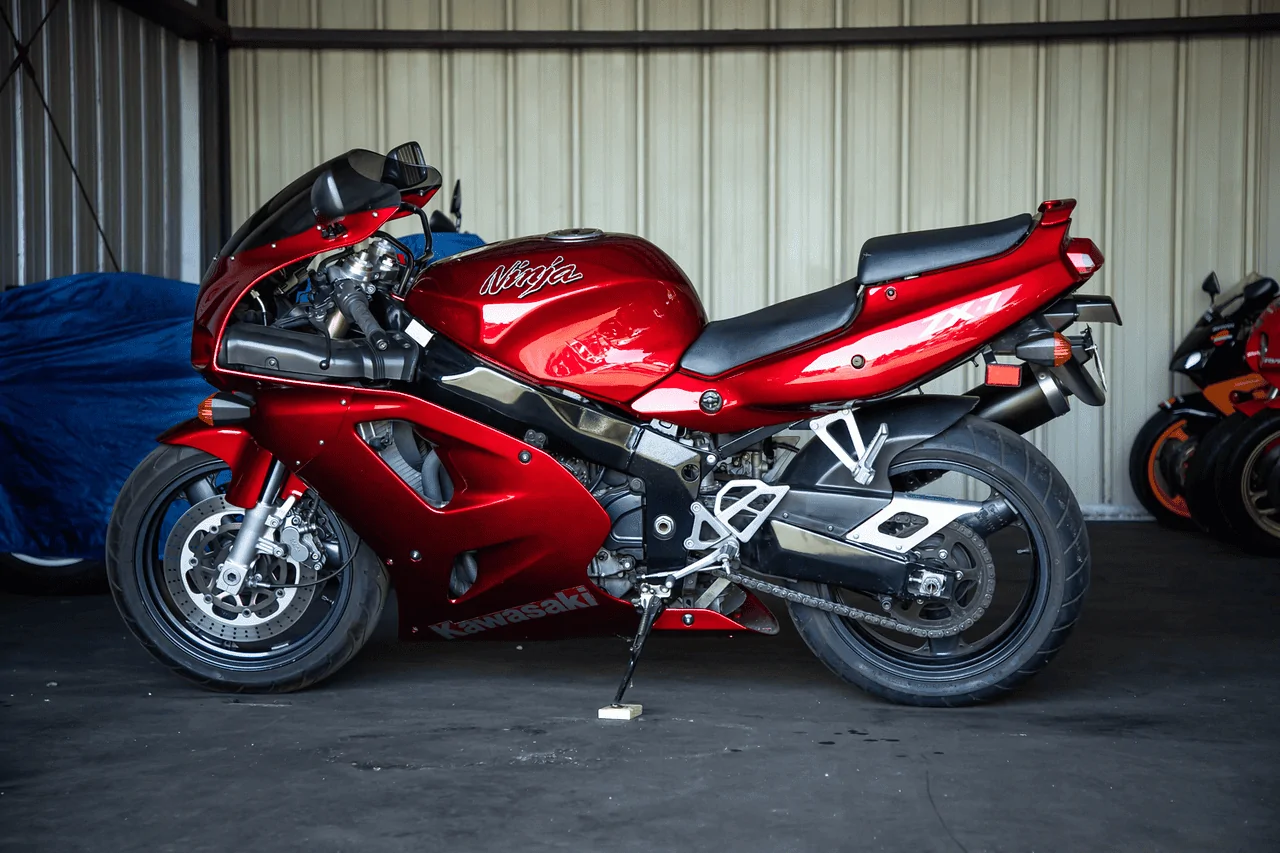

LOL, That reminds me of the ZX-7 I had in around 93-97 while I was in the Marines.
I still long to feel that buzz through the grips as that thing is trying to accelerate out from under you.

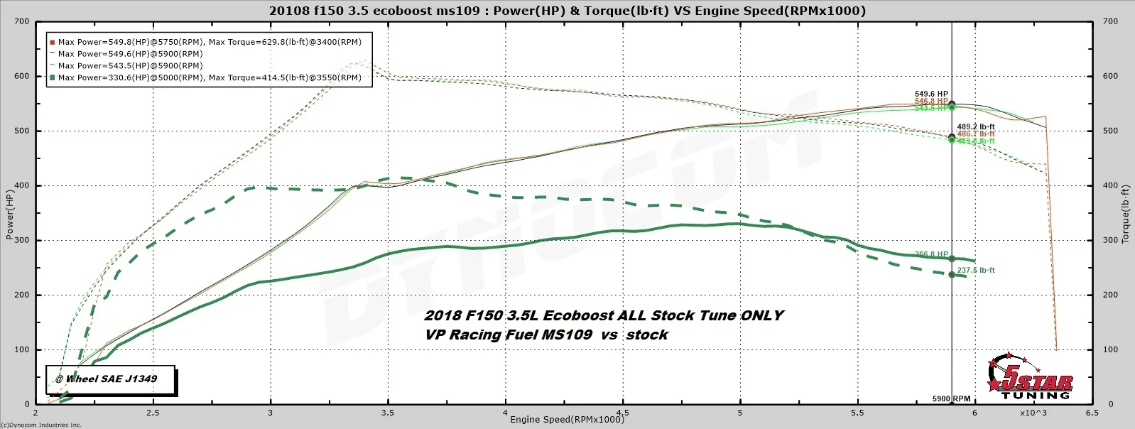

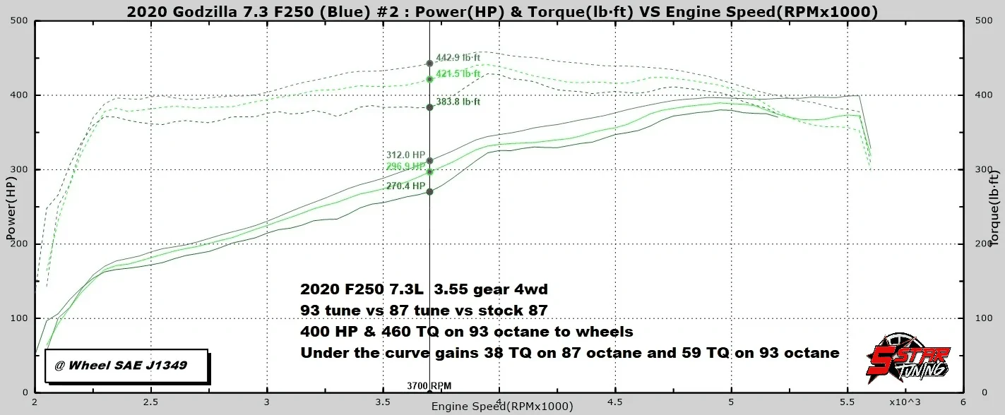

It's extremely difficult to make these low-rpm power comparisons, as dyno results at low RPM are highly dependent on how the operator loads the dyno, especially with turbo engines that need to spool.
That being said, the Godzilla is making 370+ft-lb by 2250rpm. The 3.5 EcoBoost is still spooling and is making 200-250ft-lb at 2250rpm.
Ford Bronco You think we could get Godzilla? 1642602836715
Ford Bronco You think we could get Godzilla? 1642602848674
Because the 3.5 spools up and makes a ton of torque and then tapers off as revs rise, it feels like a very torquey engine - you feel a rush and ride the wave. The 7.3 makes even more torque down low, but power continues to climb through the rev range. This is why it feels like you need to rev it - because power continues to climb. But the power was already there.
The rest of the difference you feel is likely due to being in a different platform - the 7.3 probably has to move an extra 1000lbs. through heavier drivetrain components, wheels, and tires, so it's never going to feel as peppy.
