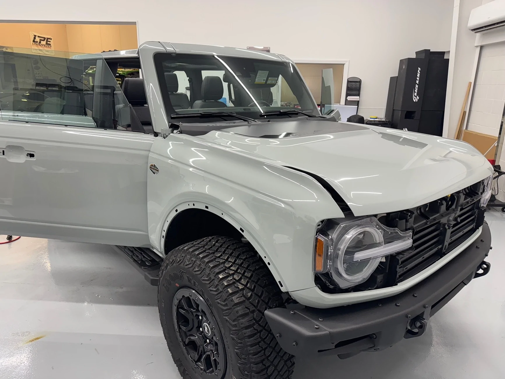

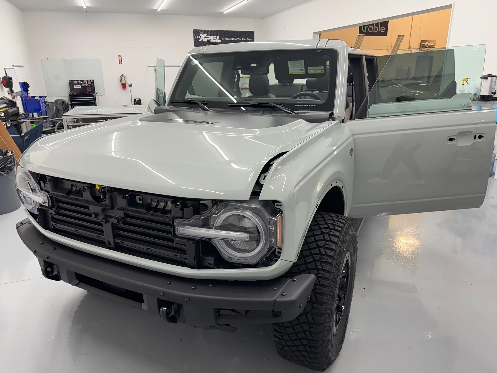

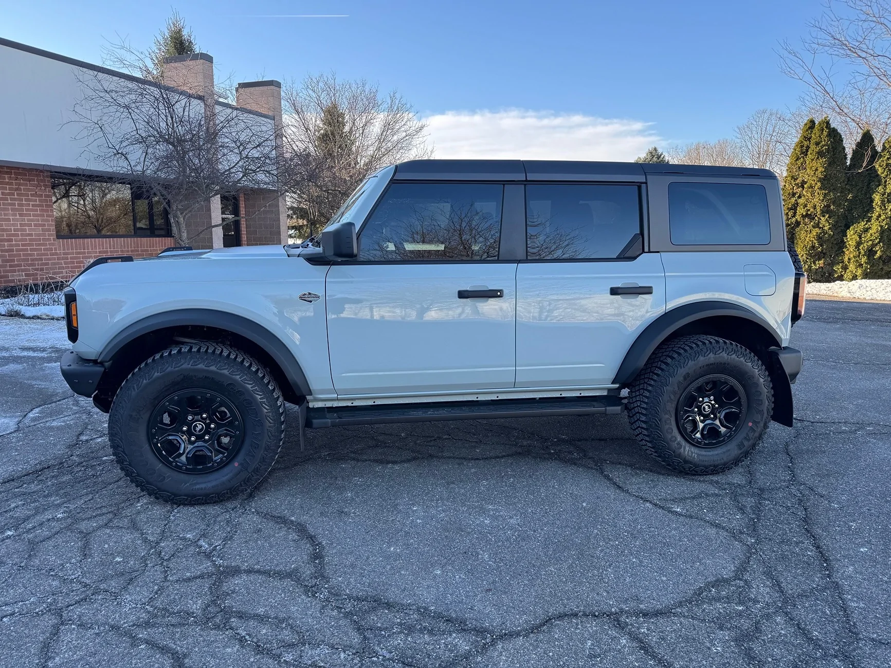

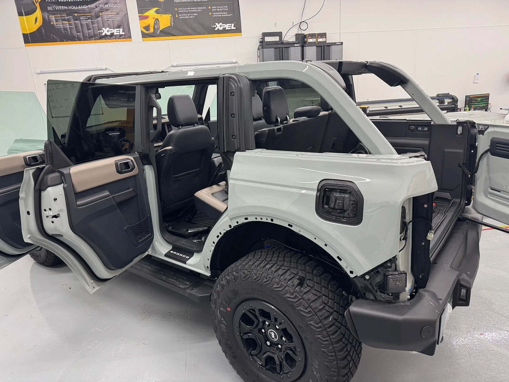

I had mine fully wrapped with PPF (except for the MIC top) last January by the company I work for, so I just paid for the materials (just under $1,000).
I was told with labor it would've been over $5K.
I'm sure you can get it done cheaper, but you often get what you pay for. Our shop takes all the exterior trim off so that they can hide the seams under the door handles, around the door edges, behind the taillights, and under the roof panels. Some shops will cut around those pieces, but the issue then is that those edges eventually collect dirt, they are visible and could eventually lead to peeling.
The film they used is made Stek and is called Stek DynoShield and is impregnated with ceramic.
I've attached pictures.

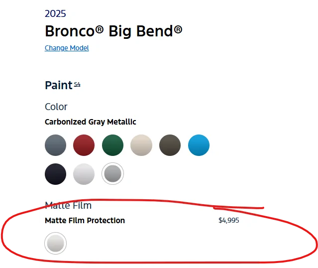

Ford sells it for $4995.

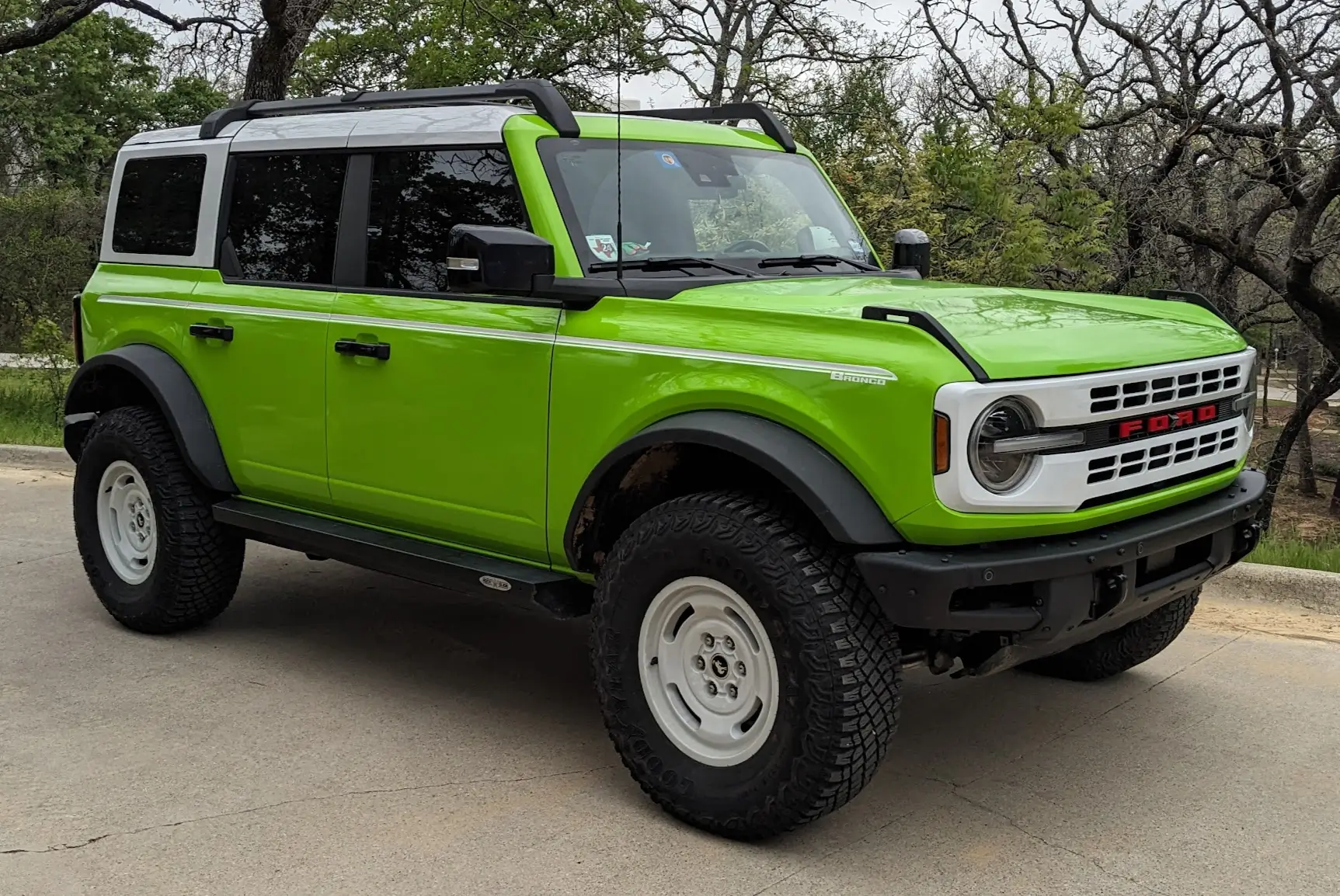

Wrapped mine myself about 3-years ago. Watched a lot of YouTube and was sure to buy extra material. Took about 2 weekends, some trial and error and a few blistered fingers but got the job done and I am proud of the way it turned out. The concave corners above and below the headlights and taillights were the toughest and I spent more time working those small areas than an entire door panel. Above the windshield was also tough, I didn't like the way those corners turned out so I removed the wrap and coated the windshield frame, roll bar and door jambs in black plasti-dip. If you are buying a Bronco to wrap, buy a black one. This way the painted areas that don't get wrapped won't look goofy.
All that said, when my wife's Bronco came in, I paid someone to wrap it. Cost around $3200 about 2-years ago (if I remember right). I would expect it to be more expensive today and it looks like you need to add a CA cost factor as well.
3-years later and my handywork still looks good except for some bubbling turned cracking in the door creases for which I trimmed and then added a blue stripe to conceal:
