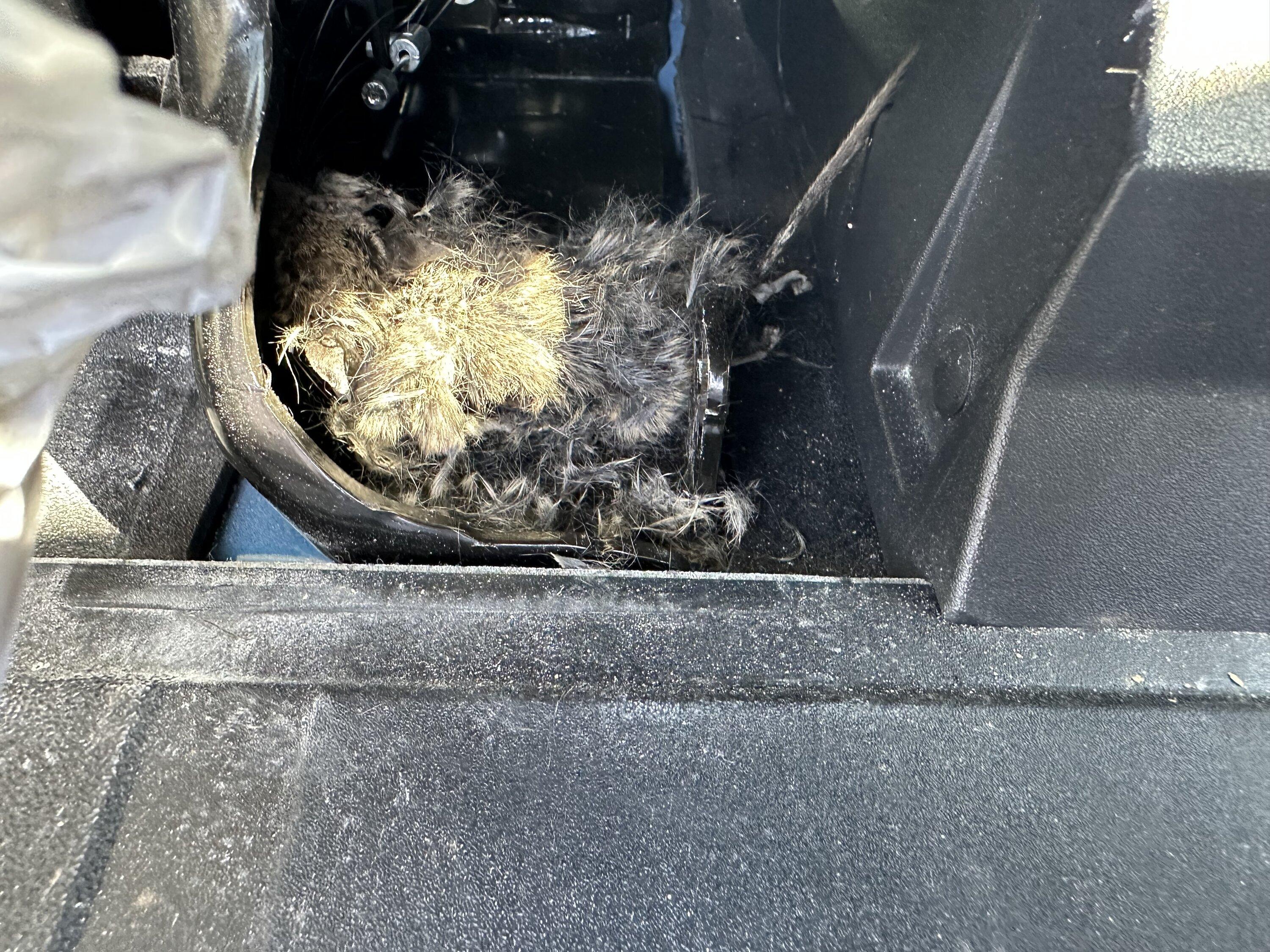

Just got mine back from the local shop. Squirrels built a nest under my hood and chewed through some wiring for the headlights. So annoying!
I think I have seen squirrels too, but rats and chipmunks seem to be what is getting me. We live is pretty heavy woods, so we get them all. At this point, the war is against all of them.
