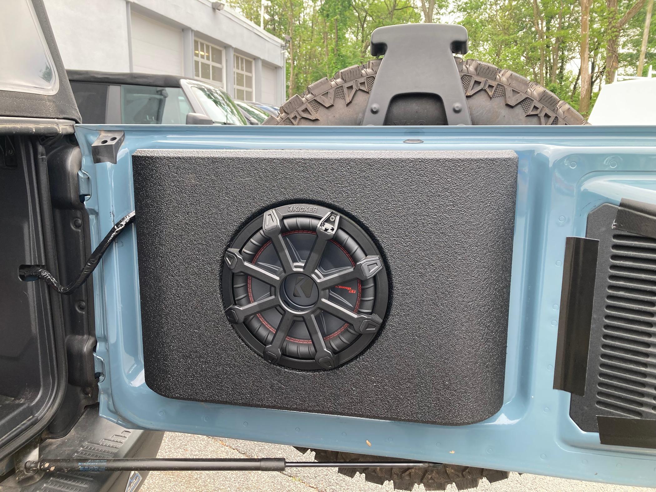

i run co axle alpines deck pods kicker panels with mti tailgate sub kicker pro
i use a amp and processor and dont have to change sub sound ever unless i change genre
Maybe this is part of the problem. I usually have Spotify on shuffle, so the genre is pretty varied. I do the same in other places (using Sonos and other Bluetooth speakers) and don’t have the same issue

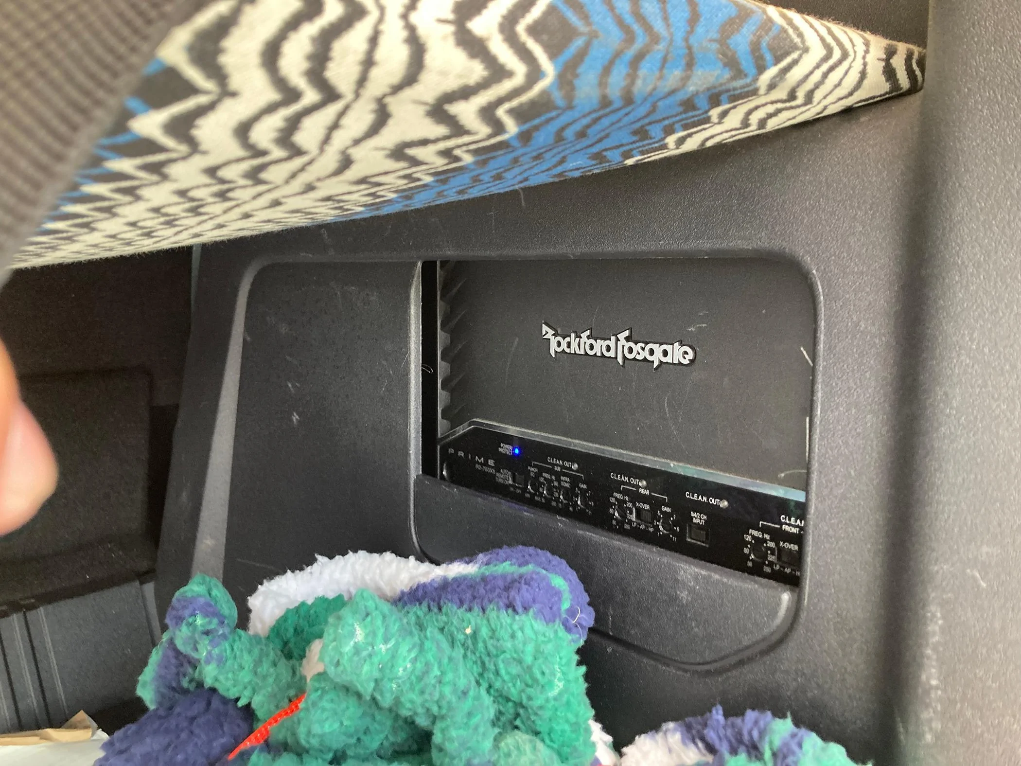

If I had it to do over again, I would do the tailgate sub. The MTI wasn’t out there yet. What amp and processor are you using?
pac audio sound processor not sure of #

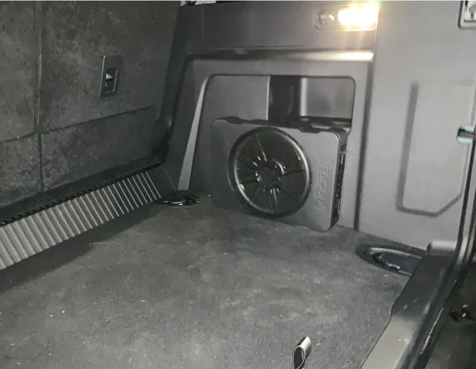

my sub setup is pretty basic: just a Kicker hideaway. With some songs It’s great, but others have nothing. I’m going to try the Kicker key 200.4. I hope it’s Mid bass that’s missing…
