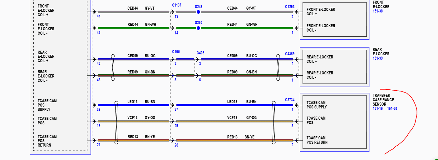

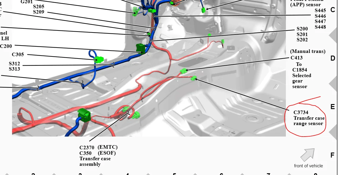

I am about 90% sure that is wire loom for the transfer case range sensor. Runs between the sensor itself and the AWD module.
Connector C3734
Sits on top of the transfer case itself. Maybe @flip or someone else with service manual access can pull up the location diagrams.

Thanks @flip!!
Wire colors match... so now I'm even more confident. The AWD module itself is on the passenger side of the vehicle in the engine bay. Should have a 40-something pin flat wiring harness plugged into it.

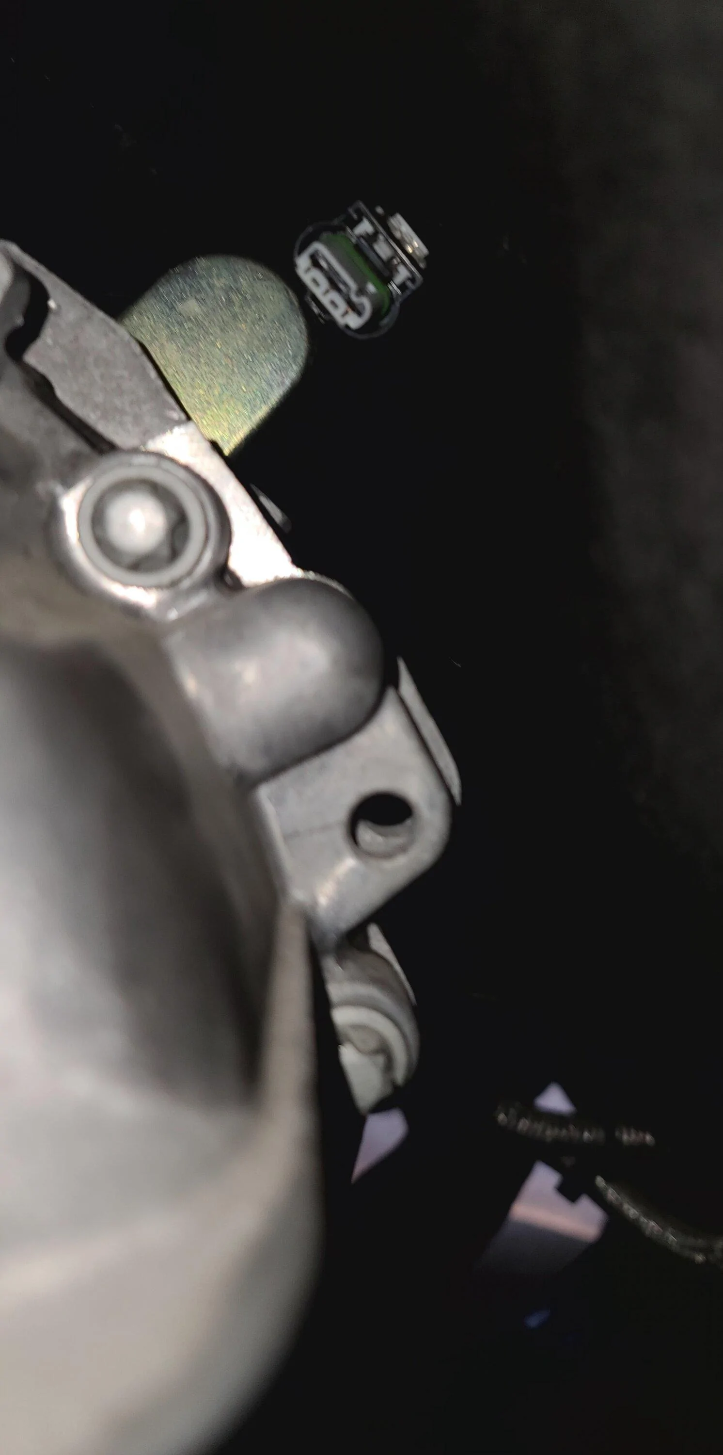

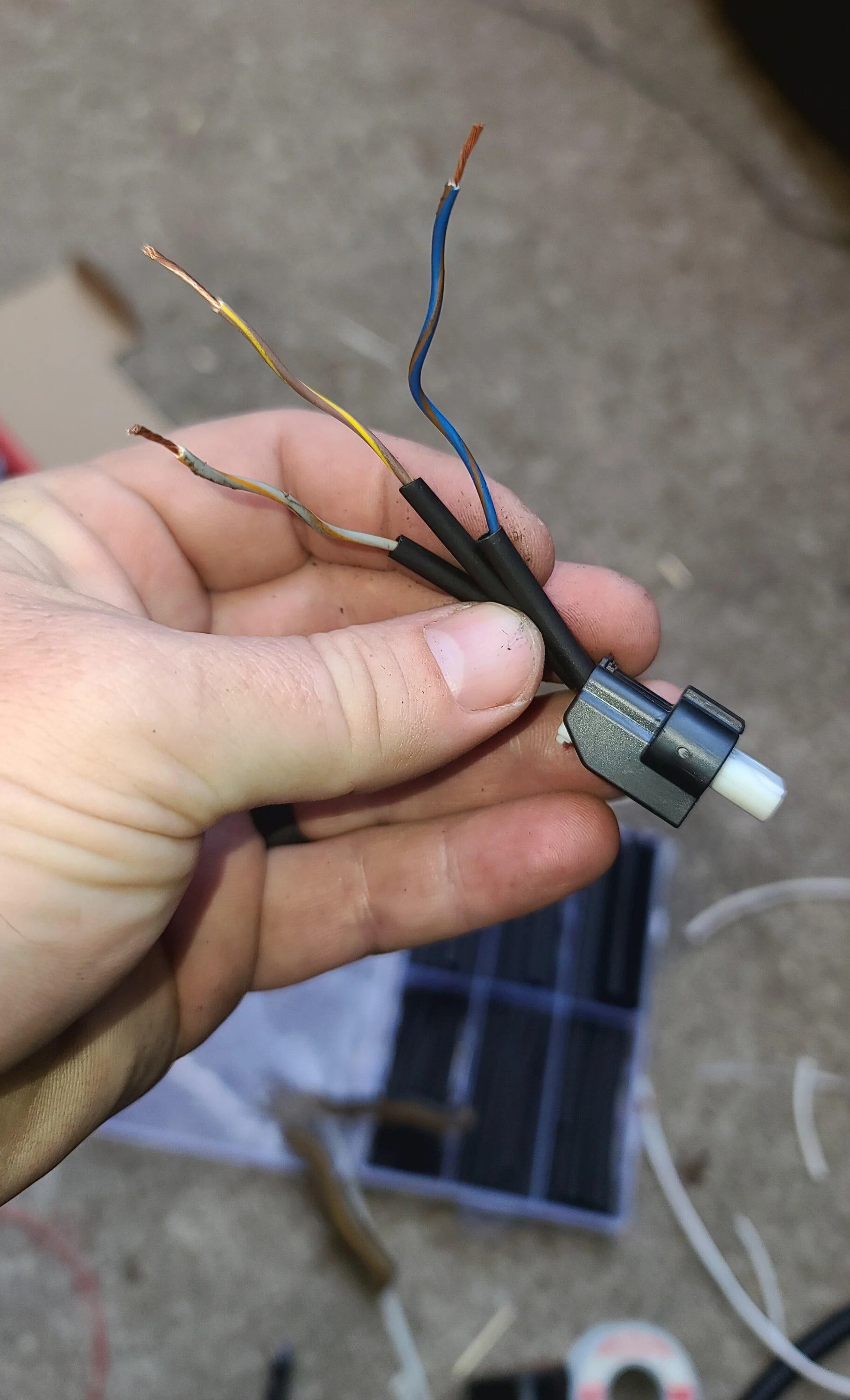

Wanted to thank you guys again, especially @flip and @RagnarKon. Finally got it all fixed up. It was the transfer case range sensor. Wife game me the Milwaukie m12 soldering iron early for Father's day. Been after a battery iron to use outside instead of having to drag my electric station around. Was a pain to get to. That is super toght in there. Pics just in case it helps anyone else.
Ford Bronco Wiring help please! Rodents got me. 20230606_184916
Ford Bronco Wiring help please! Rodents got me. 20230606_183714
