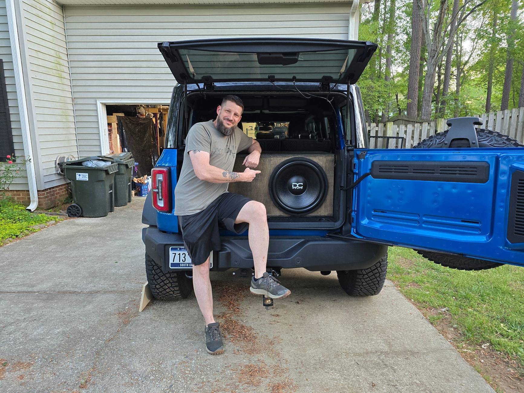

Im in the diy camp here. The factory sub wasn't doing it for me and I've tried adding a better sub to a factory enclosure in a previous vehicle with subpar results.
I went more towards the extreme end, but there are a lot of options between this 18" in a ported box doing 142.7 db
Ford Bronco Help me with a subwoofer - please 1000005858
And this with a more powerful sub in it.
Ford Bronco Help me with a subwoofer - please 1000005909
