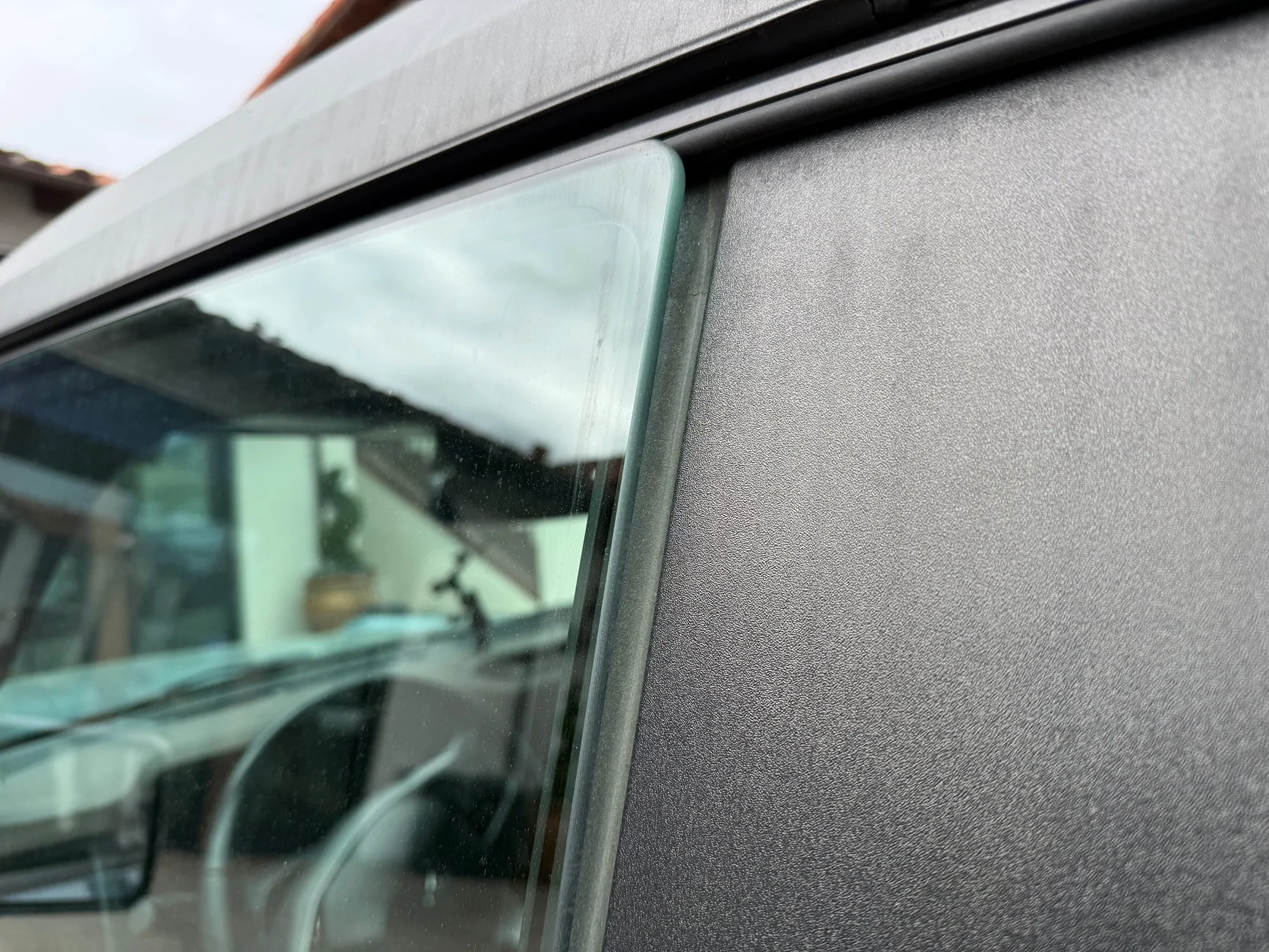

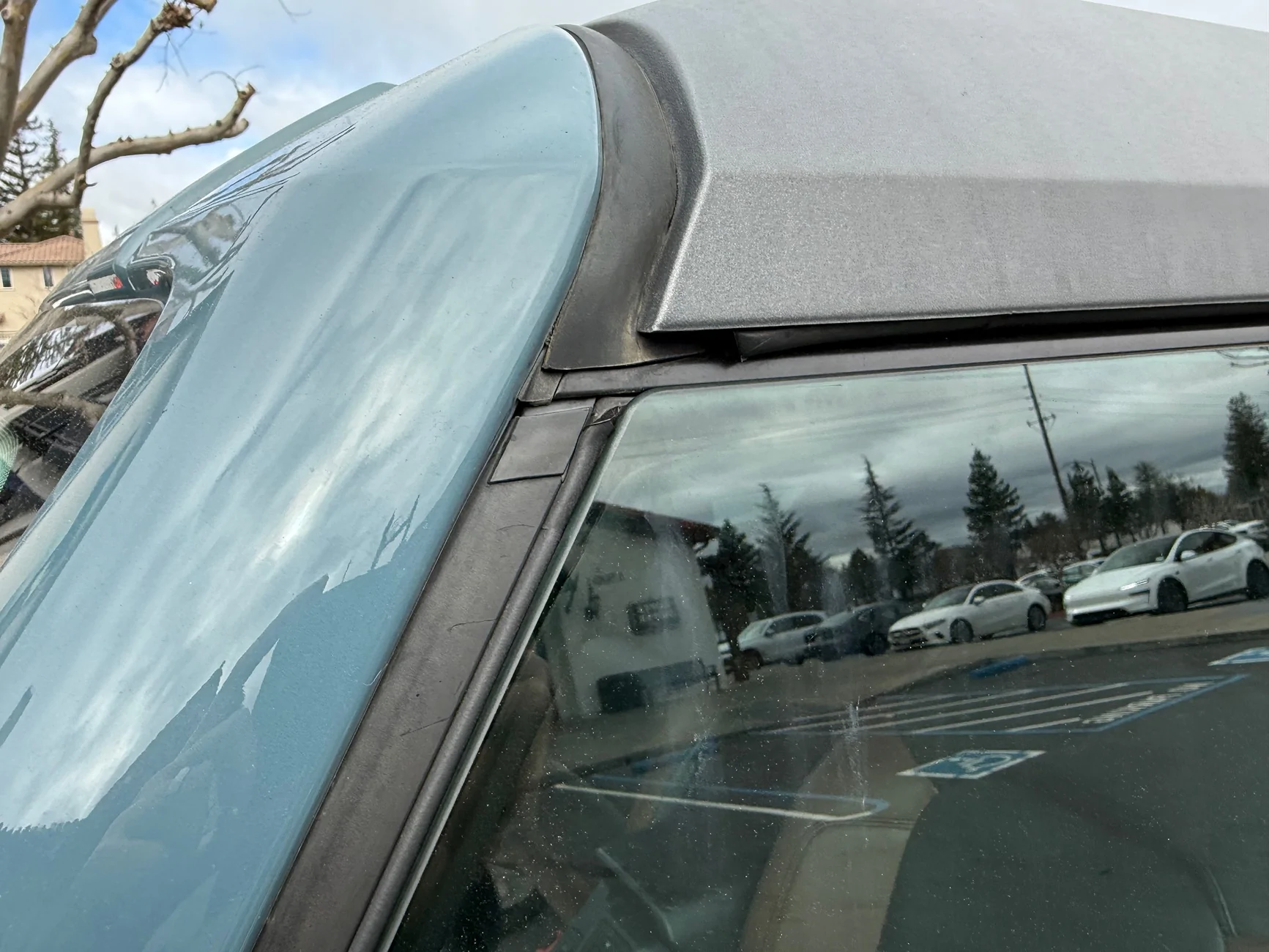

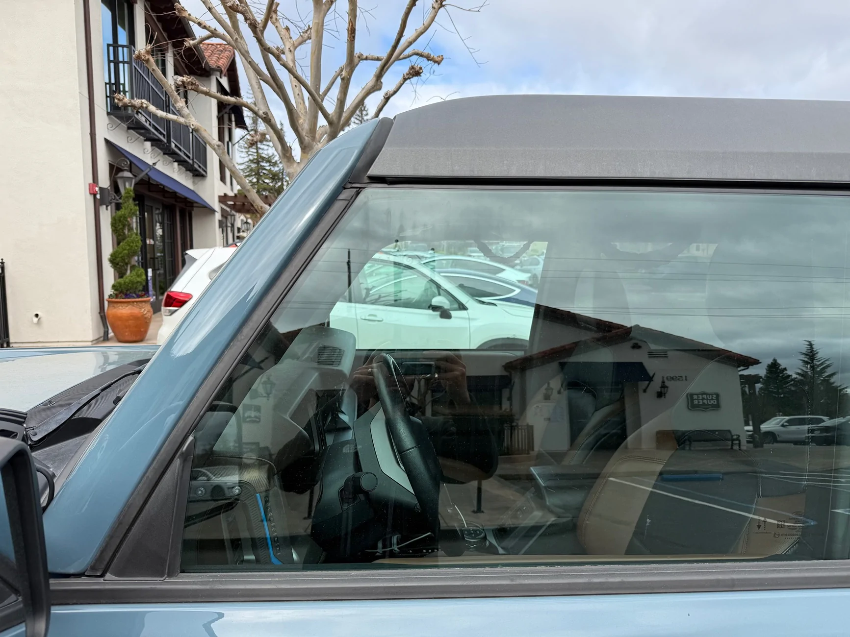

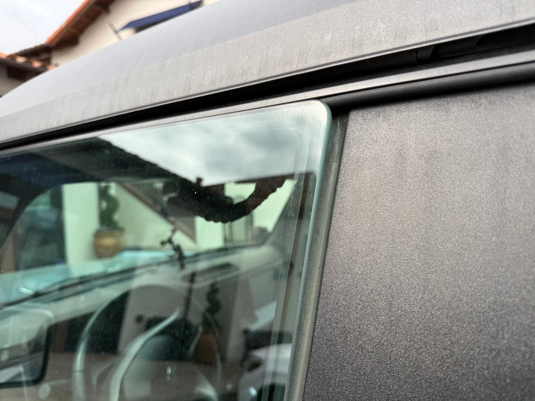

Did the window reset procedure work for you? I’ve tried it and it did not work.
I’ve identified the issue. When you close the door and the window raises, it jumps the rubber track and ends up on the outside of the rubber. I’ve uploaded some pictures and a video to show you what I see. When you lower the window, it jumps back on the track, and then you raise it and it steals properly. That’s why the wind noise goes away.
Super annoying. I tried to see if others have had this issue, but I bet I didn’t find the right posts. Figured I would see if you had any luck.

Yeah and good luck making it stick for more than a week or so. This is so annoying.
