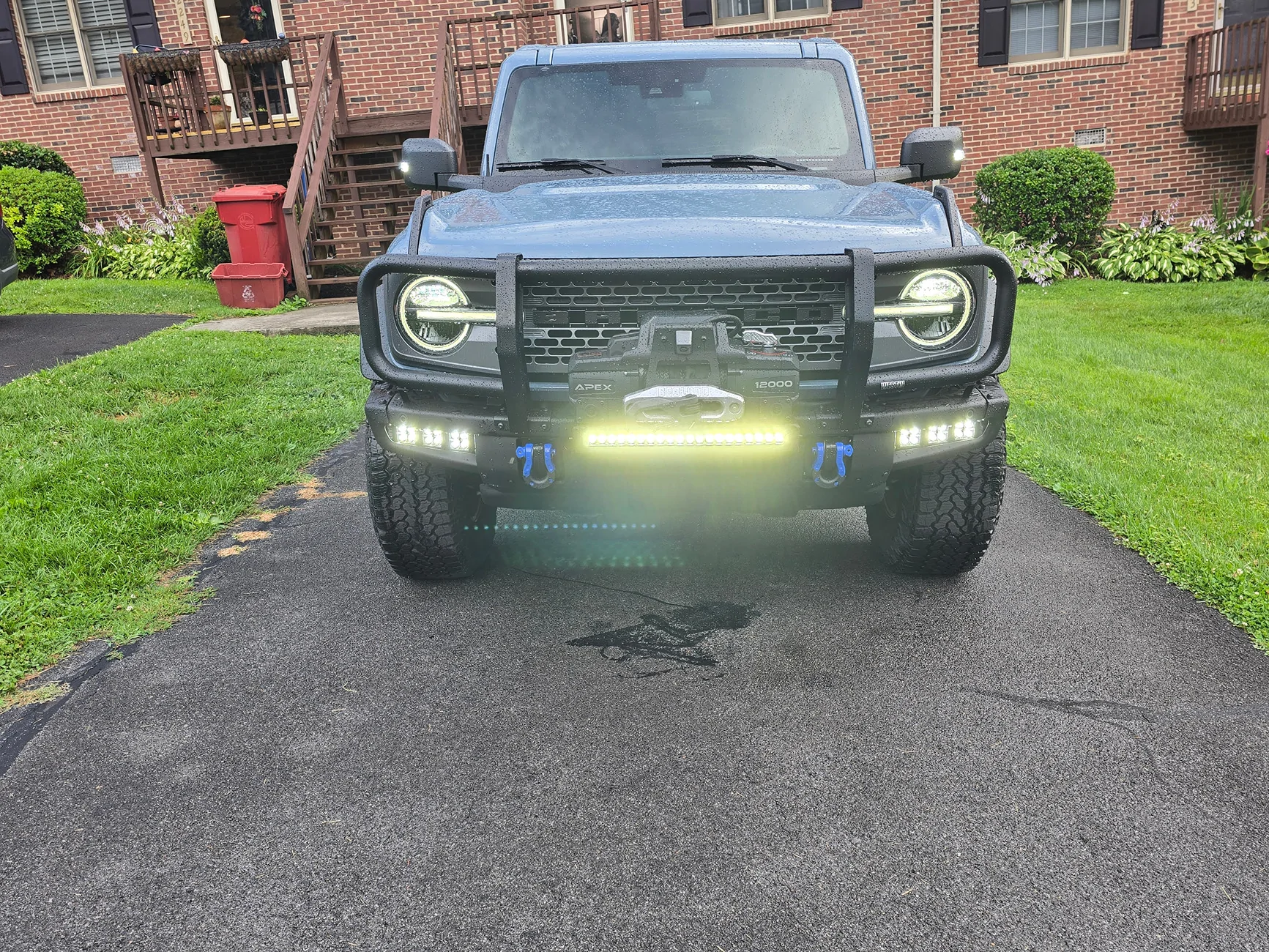

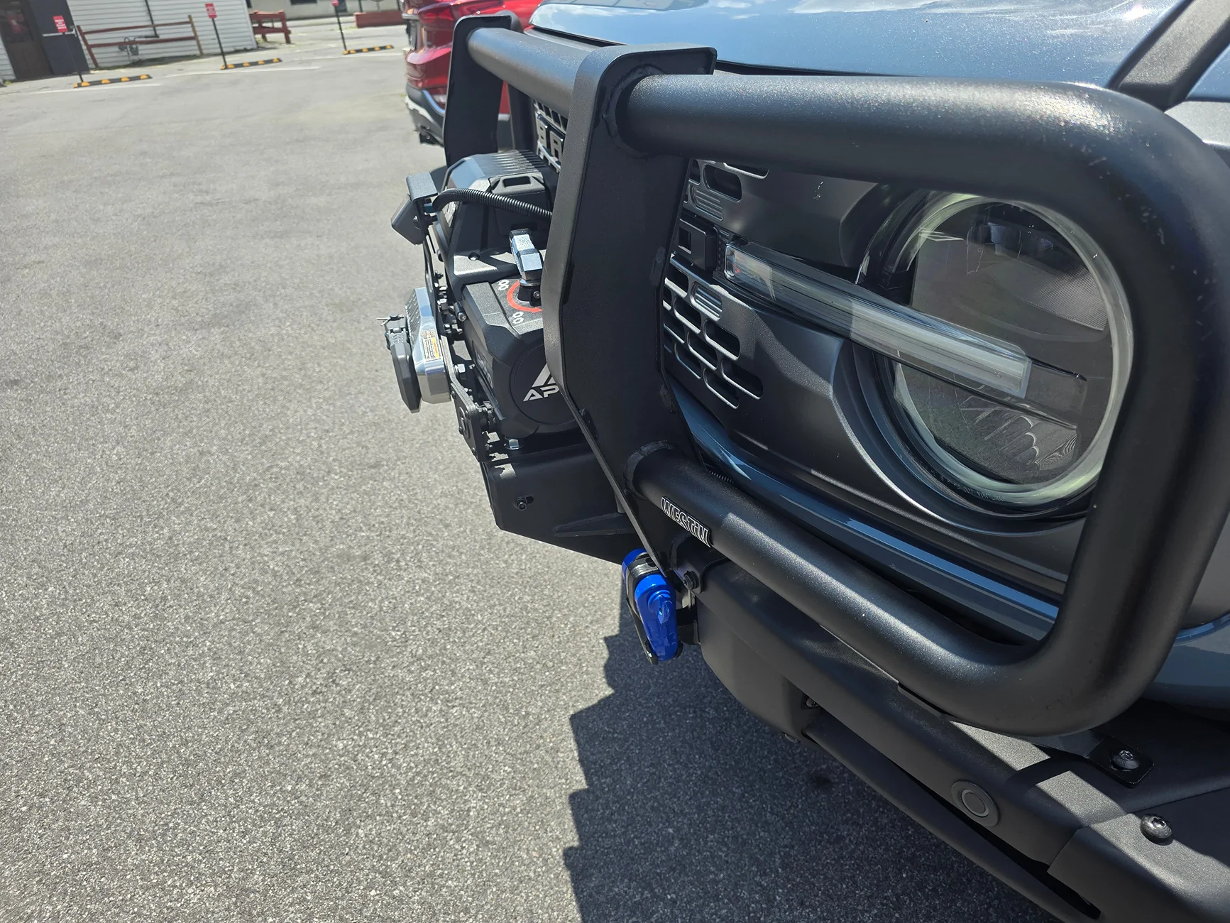

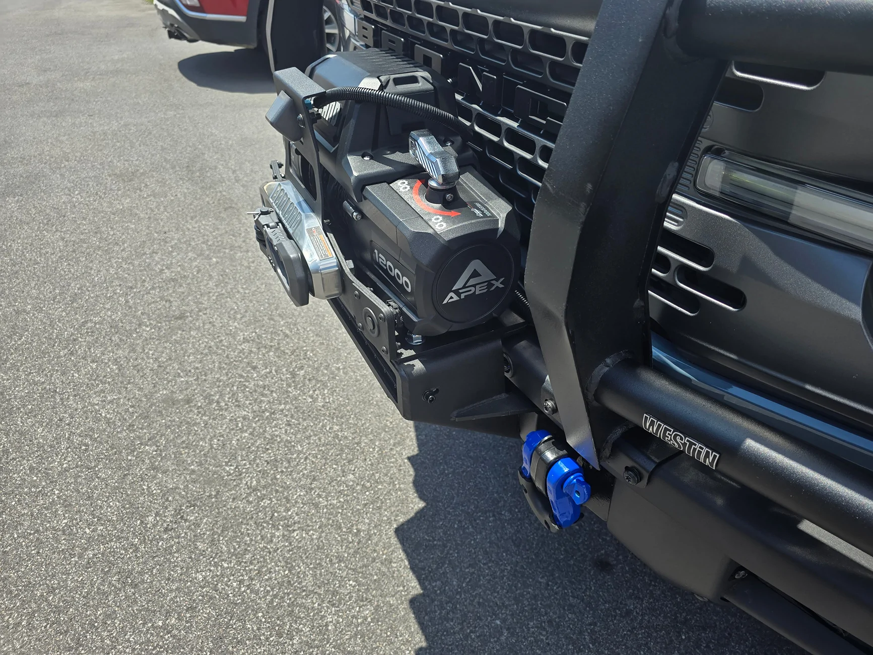

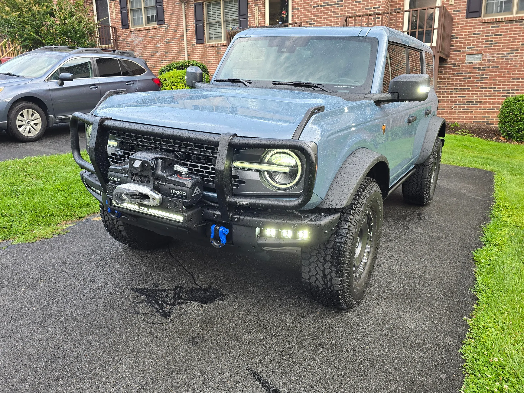

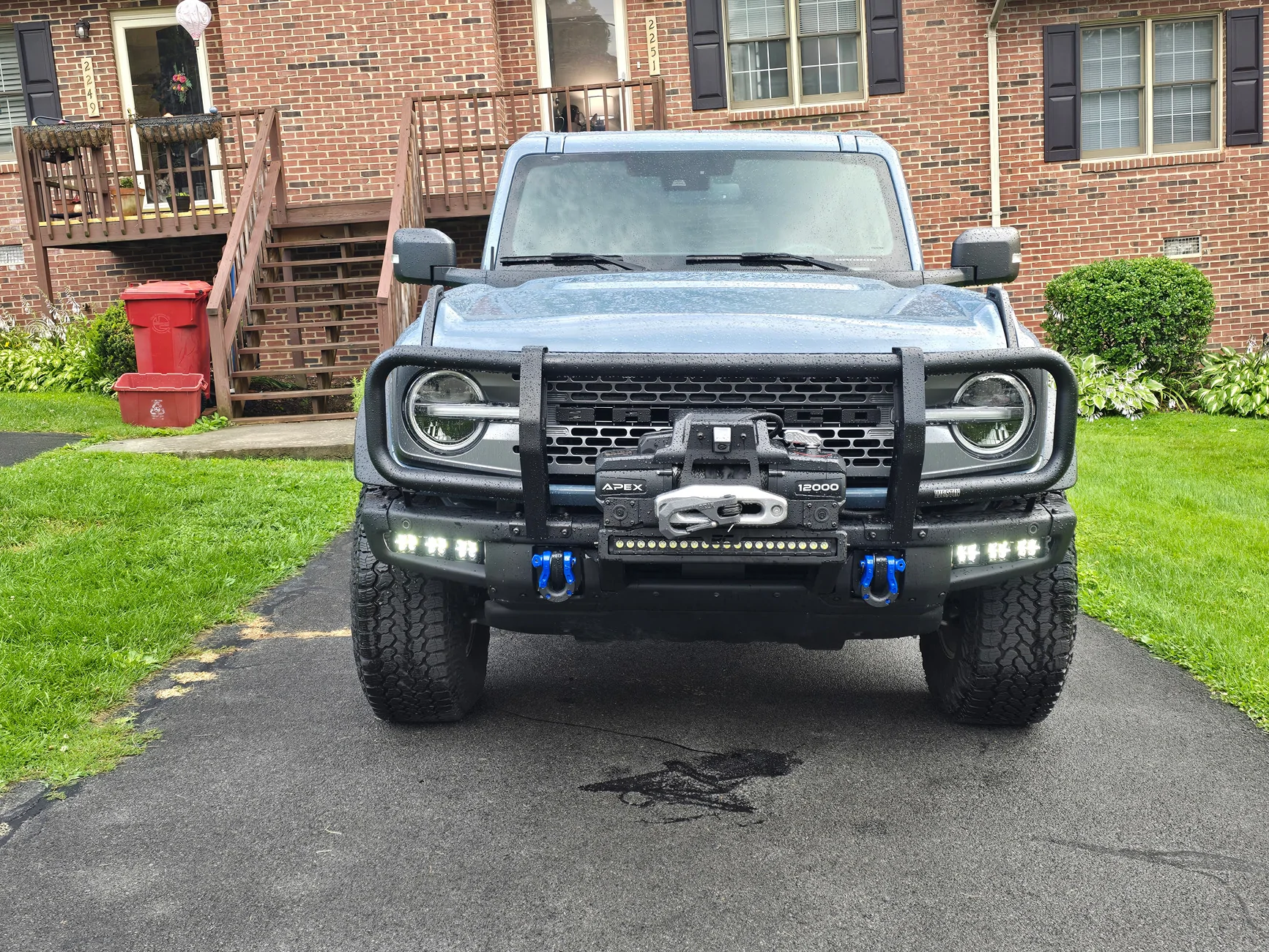

I have the Modular with some lights in the pockets and the Everglades winch mount - it's an attractive way to go, but the OEM winch kit is sold out and becoming hard to find.
Aftermarket winch mounts are available for both Capable and Modular and may be functionally better (or worse) than OEM.

Having removed the mod bumper for a high clearance aftermarket bumper (SFR), I can tell you it's a b*tch to get off. lol However, I gained a new respect for it. It's a well made bumper. Especially if you get it on sale, I'd say it's the best, since it works with your crash and crumple zones as Ford intended and isn't lightweight at all. Literally no aftermarket except some Australian brands (because they have to test) will have been tested like that, it's too expensive.
