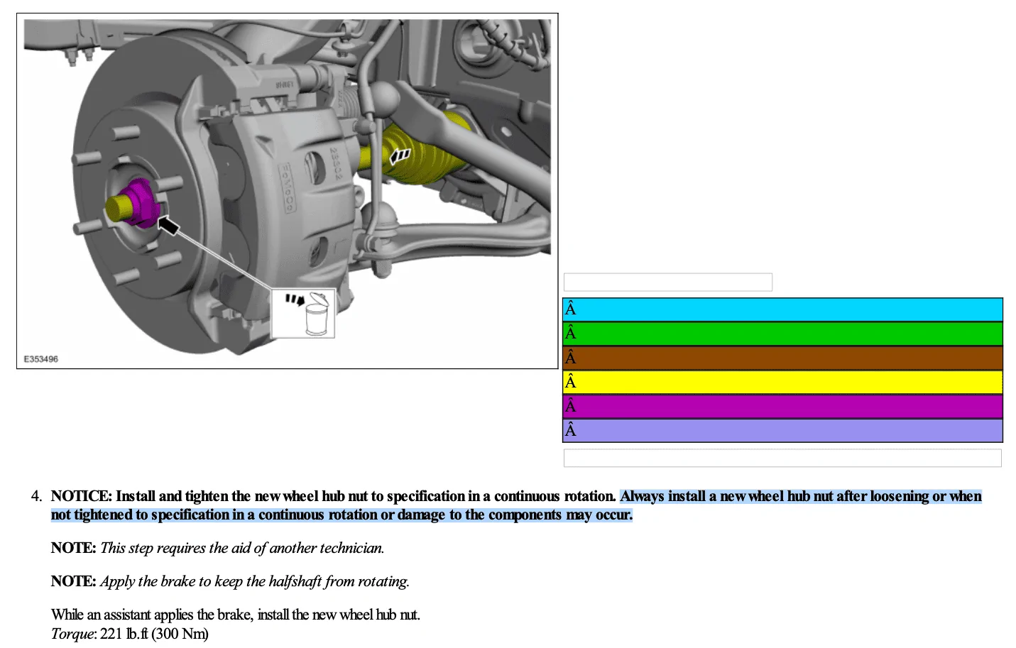

Tire place guy calls and says you need a new right axel. Says it wasn't threaded properly before they used the gun on it and it stripped. Says ford issue. Ford said it didn't happen at there place so they're saying tire place did it. Anyone know enough to tell me who's in the wrong? I am clueless about this. First pic is what it's supposed to look like.

At the very least, have whoever removes those nuts to PLEASE read the instructions, relieve the staking depression that holds nut in place, or use a nut splitter to remove it without having to use a wrench. These nuts are called "one-time-use" for a reason

It's a tire shops fault the they cross threaded it if it was a mistread it would go all the way up the shaft not just at the tip
