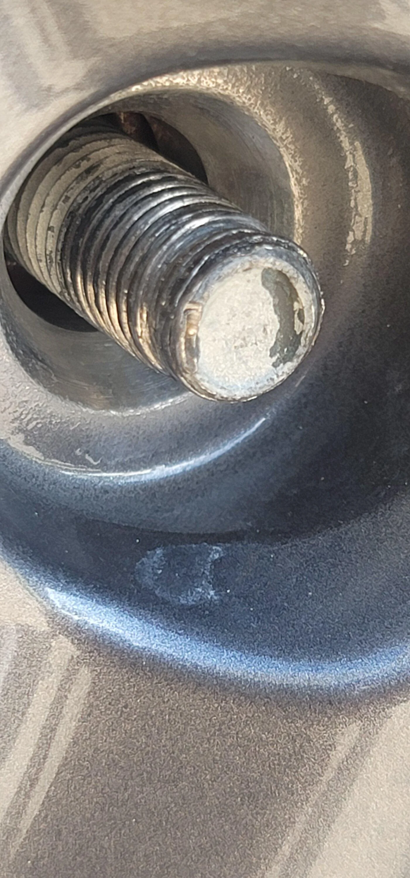

Whose fault? Dealer or Tire store

No and I mean NO manufacture of anything is going to warranty something that was at a 3rd party being worked on. so yea its Fords fault you guys are unbeliveable.

It could have happened at the assembly plant, it could have happened during the dealer inspection, or it could have happened at the tire shop. You probably will never know. My guess is it was at the assembly plant or at the tire shop. Unlikely a dealer mechanic would disassemble a vehicle that far during a PDI.
BUT, the tire shop isn't wrong, the threads on that are definitely messed up.
PDI wouldn’t get anywhere near that. My moneys on the tire shop. Not a lot of skilled folks find their way to a tire shop as a tech.

I got a hole on the sidewall of my rear right tire this past weekend. 5 out of the 6 lugs came off the last got to the end and just free spun. Had to Pry the last lug off because roadside said it would take 35-65 minutes @ 1145pm. I've only had this bad boy less than 1 month. Taking it to FORD this saturday for warranty claim..

I'd bet its the tire shop, but you can't prove it either way. I did the lift on my Ranger and it is similar. did they install the lift? or did they just take the axle nut off and notice? If they installed the lift, I bet it was them when they went to put the axle nut back on. If they didnt, then just removing the nut probably wouldnt do that.
I cringed when you said used a gun on it....stuff like that you hand thread back on being very careful to make sure the nut and threads are properly aligned before tightening.

You never posted a picture of the nut, unless u missed it. I removed and reinstalled several working on my LR3 and those nuts were staked in the axle groove. It was mandatory to chisel out the staked portion from the groove before removing old nut to prevent thread damage. And the staking of the nut, which keeps it locked in place, is tge reason these are one time use. Jury is still out but my vote relieves Ford of any liability on this

Mistakes were made. Hopefully the OP doesn't end up paying for it because some clown can't own up to their mistake.

That's what I'm expecting to happen. Neither will claim fault and I'll just pay my $400 so I can enjoy my ride.
1) Did the “tire shop” guy have all of his teeth???
If not, my gut tells me to put the blame on him.
2) On the other axle …. Did the tire guy reuse the self galling throw away nut.??? If so, expect the same issue.
3) Run a dye nut over the threads and get 2 new nuts and call it a day.
If they manage to screw that up… get a new axle….
Don’t expect ford to pick up the pieces since you chose to modify your truck.
I don’t mean to be harsh…
But do the work yourself. I’m so sick of half ass so-called professionals who clearly should not be in business destroying everything they touch… then when things go bad they look to blame others.
Just my two cents…

Cross threading will get picked up by DC tools in factory. those readings will be closely monitored. there will also be a quality inspection to check for cross threading. 90% probability it is done by tire shop. and there is only a 10 % probability it happened in Ford Assy plant.

Dang, 221 lb-ft torque spec on that nut

I think this is an easy question to answer. The shop was removing that nut to change the parts behind it. If those parts have been changed then they were putting it back together and stripped the nut. If the parts behind the nut haven't been changed then they had no reason to be installing the nut yet so it happened during removal.
I've had factory bolts strip during removal before, even if properly installed, because debris will destroy the threads while backing it off.
I also agree I'd chase the threads, put on a new nut and keep going.
Good luck with the repair.
