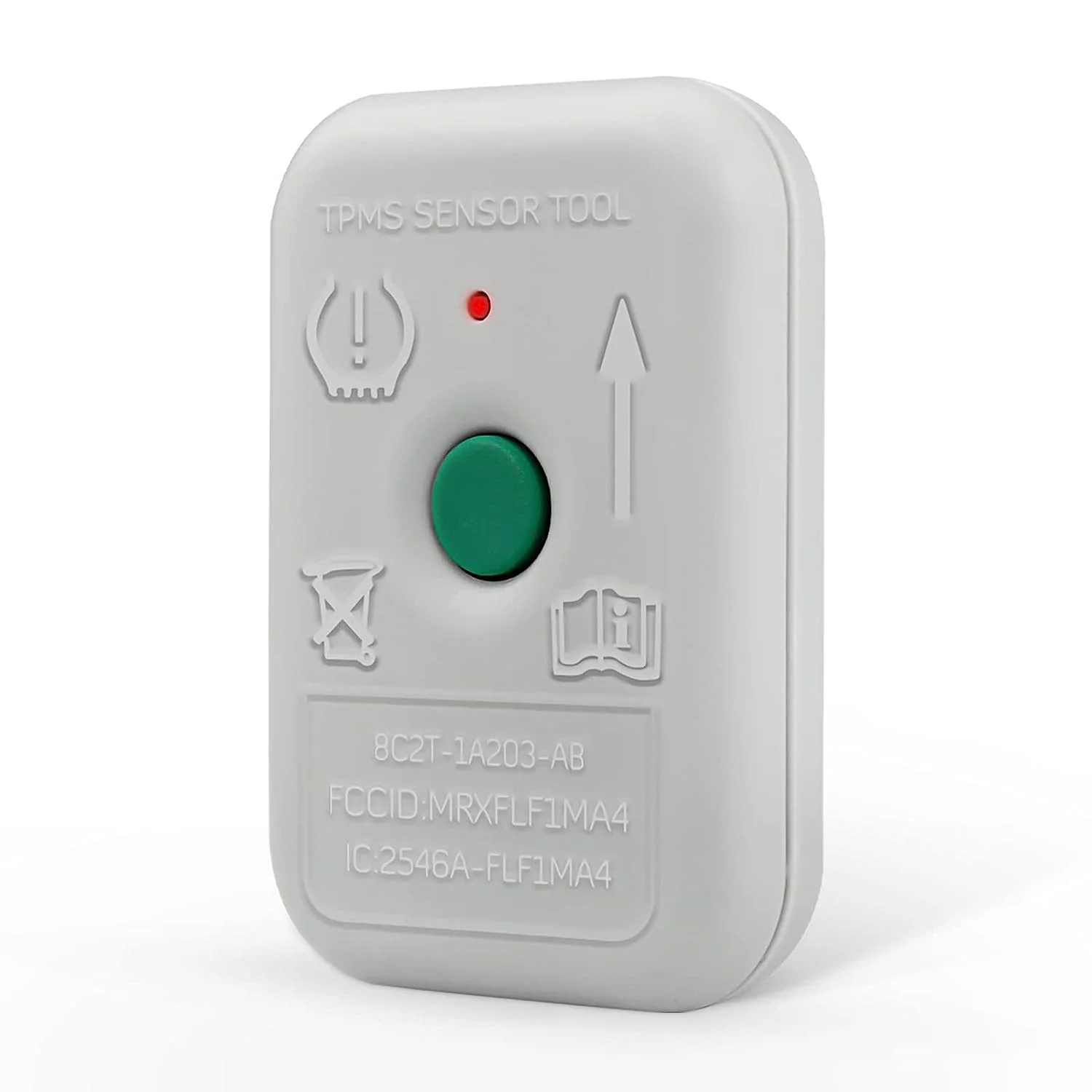

Did you hold the button long enough? I think the first tire took a good 30 seconds before it honked. The others took less time. Is the battery good in your tool? Is this the tool you have?
Ford Bronco TPMS Fault TPMS-19_tool
