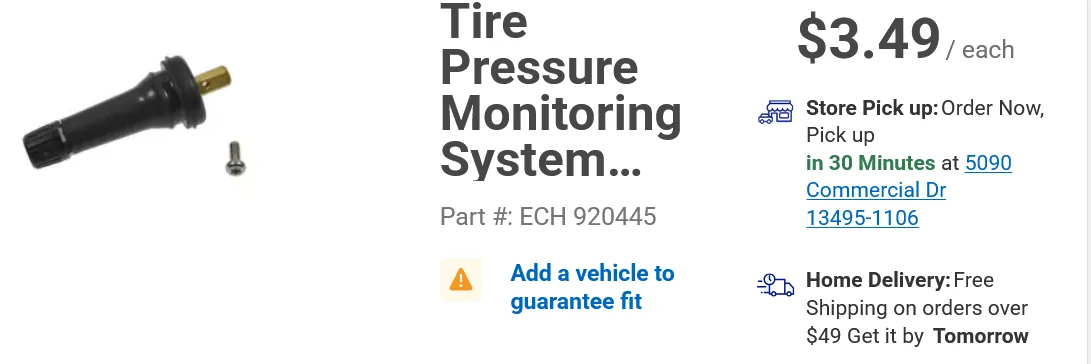

Whenever you put new tires on, you should change the valve stems too...the old ones were exposed to as much of the elements as the tires themselves and will deteriorate also....stems are cheap enough, even the TPMS style ones....
I thought the valve stem is an integrated part of the larger TPMS apparatus. It's separate? Can I jjust get one at Autozone, or is it better to buy from a Ford parts counter?
Thanks for the info, and for your patience, too.

I bought my most recent stems for my snows on my 2025 Maverick from NAPA (bought a set of Maverick steelies off a 2022 from a private sale) - their Echlin line is good quality but I am sure you can get decent stems from Autozone or right from FoMoCo...
The TPMS sensor fits on the bottom of the brass tip and the supplied screw will hold it in place.

You can also change out the center stem core from the valve, they can leak over time if some type of debris or corrosion gets in there. You can do that with the tire still on the car (you want to jack it up so it's off the ground when the air is released it won't go flat and break the bead). If you need to replace the whole valve stem, I think you need to break the bead to be able to get inside to remove the TPMS with the valve and swap it over.
