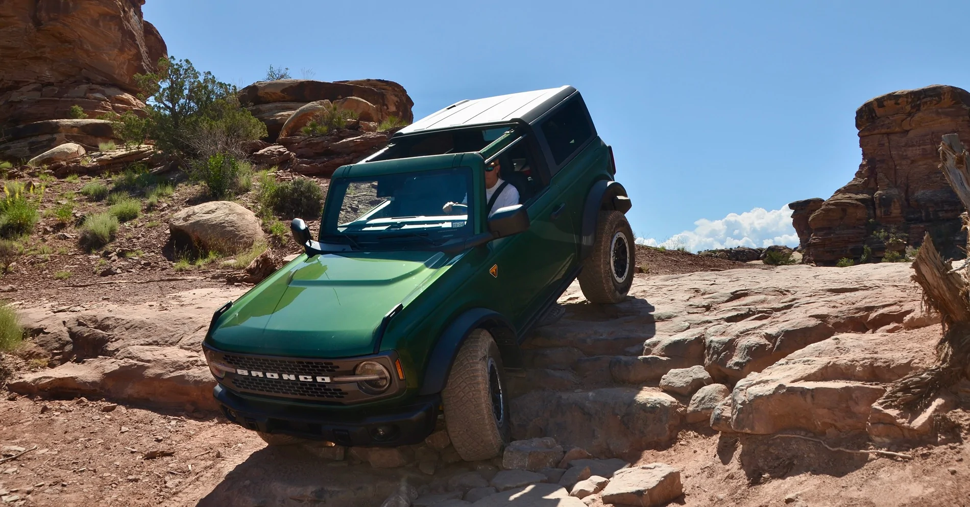

jbellousux
Jul 22, 2020
260
825
Austin
‘13 Land Cruiser
I’ve done some decent off-road treks.
Elephant Hill Road in Canyonlands.
Imogene, Pearl and Ophir passes in Colorado.
These are about the only times I have used my crawler gear, but as would be expected, it is an absolute beast in getting up the steep and rough stuff in 4L.
What might not be as appreciated, is how useful the crawler gear is when descending the steep stuff. It allows for considerable control with minimal breaking.
