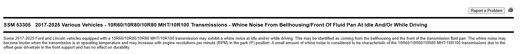

I was wondering if someone has a similar experience. I bought a new Bronco Big Bend, and I've been driving 700 miles so far. There's a low noise, but it's noticeable to me. I heard a similar noise when I had issues with my last Toyota Highlander, which was known for transmission problems. (It's not as loud, but it's the same sound.) So, the noise isn't very loud, and I was wondering if that is normal for this off-road vehicles. It's my first time with one of these. The whining noise isn't always there, but most of the time it is. It occurs between 1st and 2nd gear, and 2nd to 3rd, at no more than 25 mph, then it stops. I've tried different modes just in case, but the noise still persists. I'm sure it's not the turbo or the engine. To me, it sounds like a transmission problem or related component.
I've read that some Ford transmissions have a particular noise, and when you take it to the dealer for inspection, they say that's normal. In other cases, they mention it might be the torque converter.

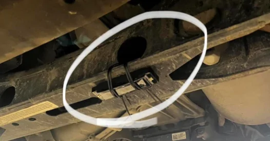

You could look for this. Someone playing a prank on you? lol
Ford Bronco Whining noise 1764862142206-ig
