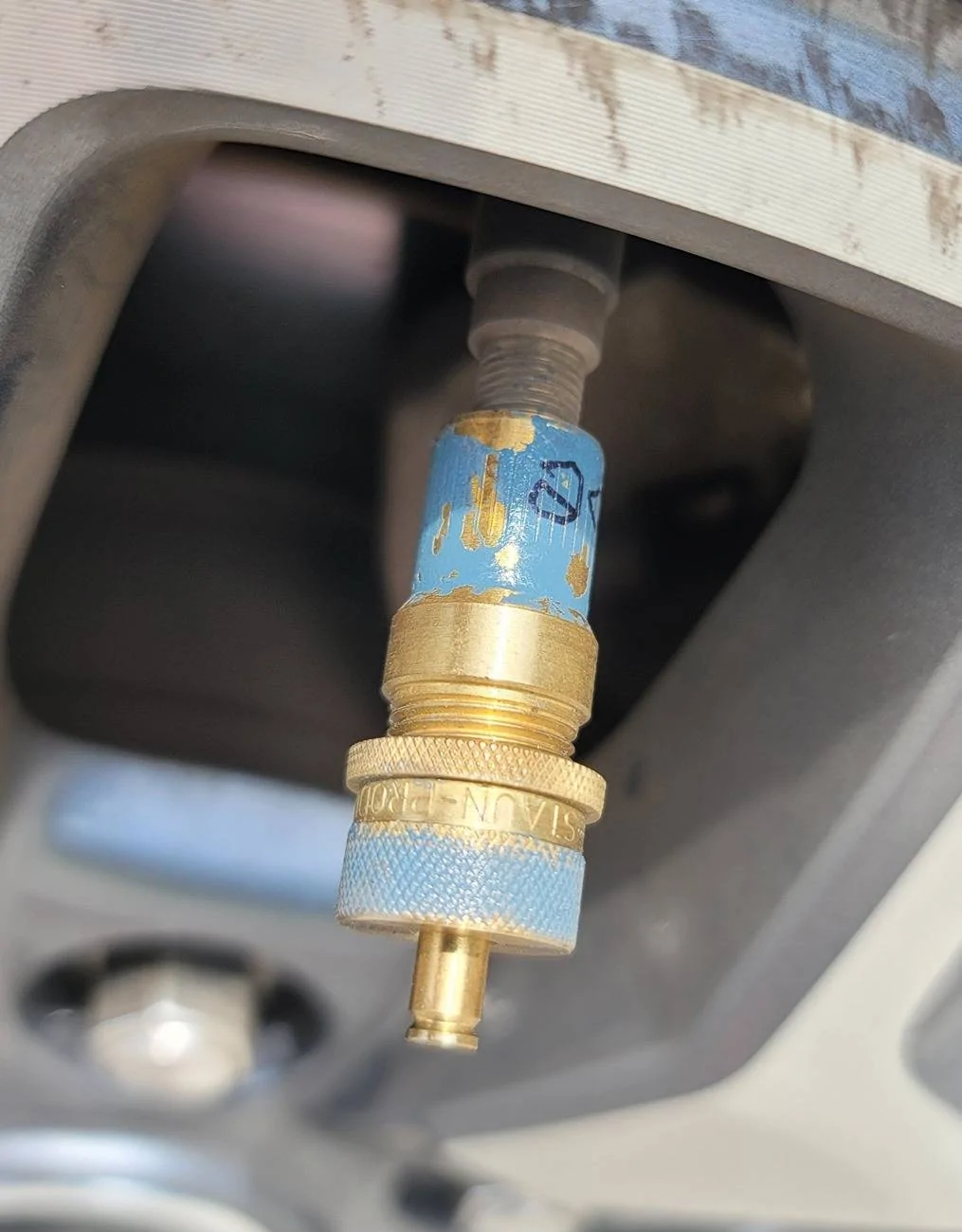

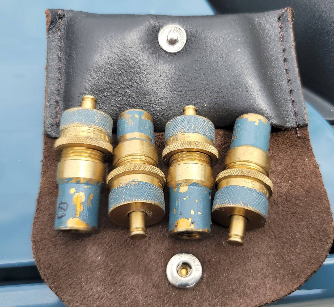

I've been using Staun for 4 years now. They work really well, but it takes awhile (several uses) to adjust them accurately to a certain pressure. And if you want to go even lower (you find the sand is really soft) it's not practical to readjust them. For example, Cape Cod needs 15#, but in the OBX, 18# or 20# is usually fine. That's where procedure works.
I have mine set to 18#. If it's a 20# beach, I'll screw them all on, watch the dash TPMS gauge, and when a tire gets near 20#, I'll start taking them off in the order I installsurprise. If it's a 18# beach, I'll leave them on until they automatically stop. If I still lived on the Cape, I have all the deflators set to 15# and use them similarly.

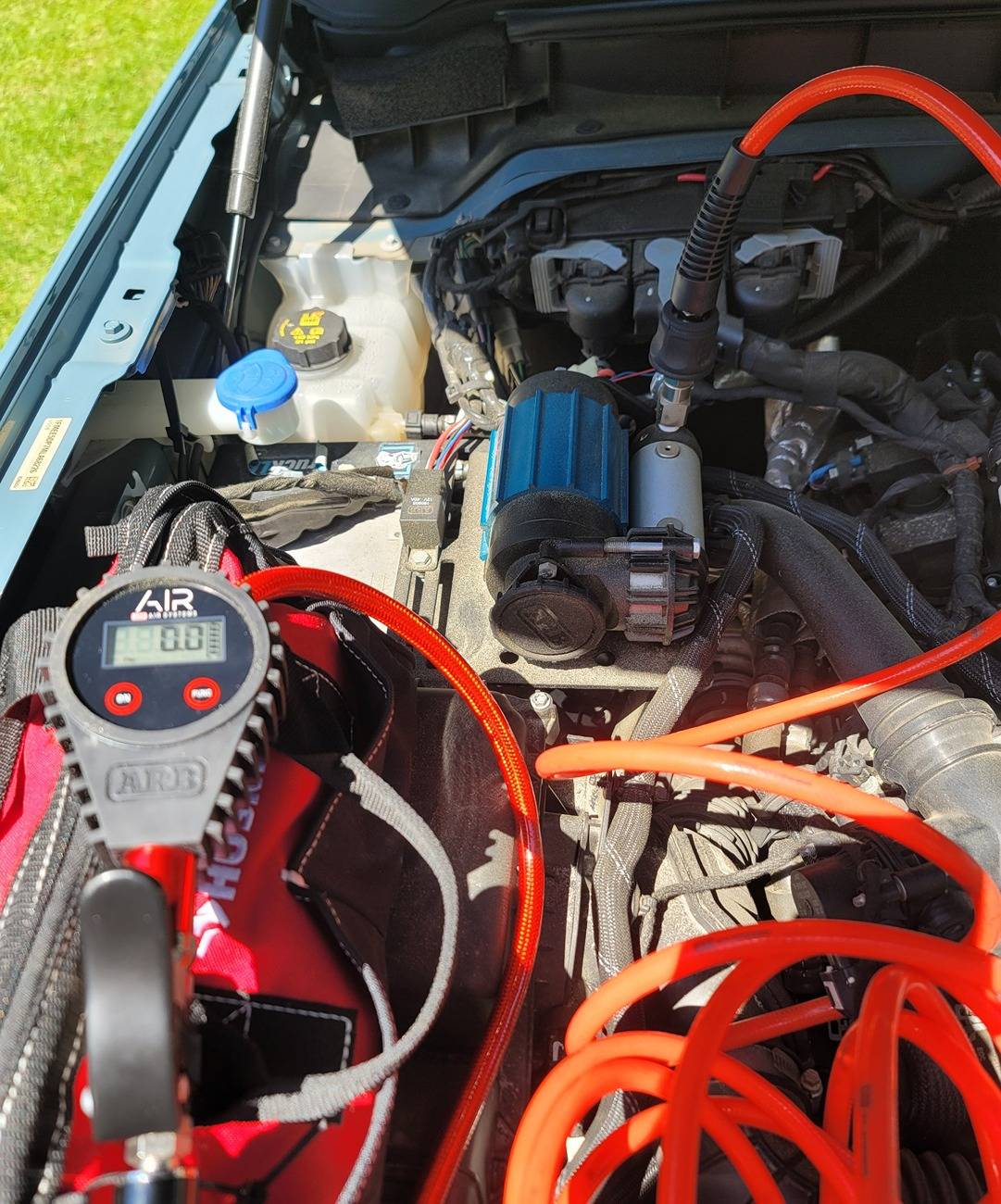

Which brings me to a Bronco-specific feature. Unlike my previous F150, the Bronco TPMS system, and the dash gauge reading, is highly accurate and reads fairly quickly. I have found that I rarely use my tire gauge anymore. (MY ARB inflator has its own gauge). That was a pleasant suprise. I have 33" tires.
Ford Bronco Which automatic Tire deflator should I get? 20240610_120647
Ford Bronco Which automatic Tire deflator should I get? 20240610_120620
Ford Bronco Which automatic Tire deflator should I get? 20240529_112331
I bought my ARB Single and the install bracket from 4x4 TruckLED. The system works well for 33's.

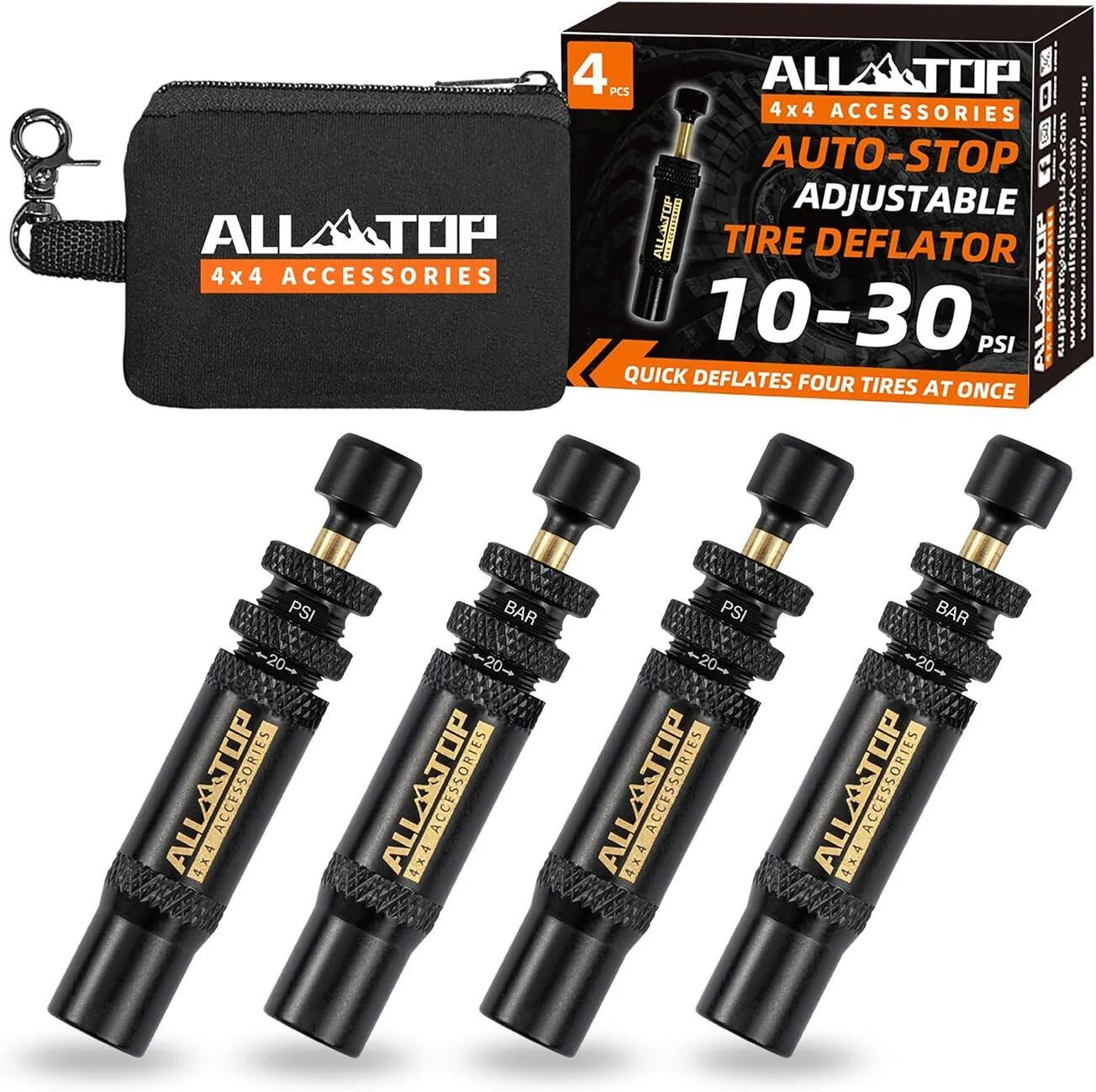

Inflate doesnt mean deflate? Phew. Just mentioned the inflate side as I had a reason for not using a 4 way manifold approach which would achieve deflate as well.
So when I said "to air down", these were the cheapos
