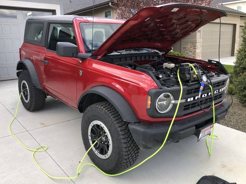

It will complain about lower pressure, you acknowledge it, and it won't say another thing until the next time you turn the Bronco off and back on.
I put the screen in off-road mode after dropping the pressure and it will show the pressure of each tire along with various lean angles and steering angle plus what is currently locked and stuff. When you air back up it stops showing the pressure.
I generally go for 18-20 psi which improves traction and smooths out the rocks, but you're not in danger of popping a bead loose. You can go down to 15 or even 12 in sand, but then you're taking a chance.
Here's a photo of my air compressor and 4-tire inflation/deflation system (total cost: around $300). It takes 2-2.5 minutes to air down and 10-11 to air back up.
Mind sharing details on your setup? That’s exactly what I’m wanting to put together myself. Thanks!
Here are my notes from about two years ago. Some parts might not be available anymore from the links. Maybe you could go through all of it and update any links that are broken, or search for better deals.
This is the starting point:
1: Pressure Gauge [$14.97] https://amzn.to/32yhLQQ
Get a 0-60psi version - $13.97
1: Air manifold, 3-way splitter [$18.97] https://amzn.to/3H975qR
Comes with three couplers, one can be used for the SmittyBilt hose
1: 50' of 1/4" hose [$20.88] https://amzn.to/3mvPu4J
Comes with two ends to screw into the air mainfold - $21.60 - Choose 3/8"
2: Brass Tee fittings with clamps [$9.99] https://amzn.to/3JkQBOC
Split for front tire, has clamps, $17.98
2: GODESON Lock On Air Chuck, 1/4 NPFT Closed Flow Brass Tire Chuck, pack of 2
https://www.amazon.com/dp/B0BS28JHGJ
1: Brass ball valve [$7.99] https://amzn.to/3ekFEy2
Connects to pressure gauge
1: 1/4" x 1/4" NPT female to female - two for $4.99
https://www.amazon.com/Pack-Coupler-Brass-Female-Fitting/dp/B082V8FJQJ
2: 2PCS Brass Hose Barb Fitting, 1/4" Barb x 1/4" NPT Male
https://www.amazon.com/dp/B09YRZ1MPY
1: US Solid Brass Hose fitting, 3/8" Barb x 1/4" NPT Male
https://www.amazon.com/gp/product/B07VJK9BSJ
1: 1/4" Female NPT Plug http://amzn.to/2seaI99 [$9.48]
Connects to ball valve - $5.11
