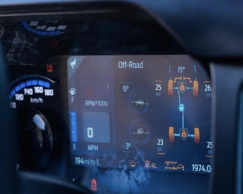

Looks like this.
Perfect photo choice... Shows how the individual pressures are depicted and the low tire pressure warning light clearly illuminated.
Too bad about the NHTSA defining the requirement for it to illuminate. Sure would be nice to be able to define the limit, especially for specific GOAT modes that you would typically air down in.
FORScan to the rescue!
