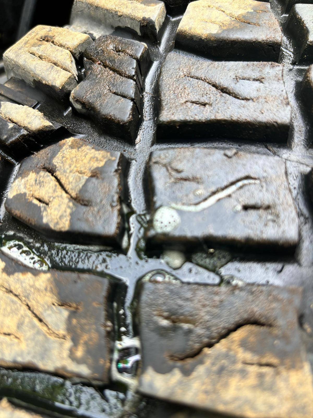

Traditionally car tires are worn when there are 1/16 left. That's obviously not practical for an off road tire. So is there a standard for off road tires or is it more a matter of when you feel there isn't enough tread left to be effective?
Ford Bronco When is an off-road tire worn out? img_1598-jpe
Edited to say these have almost 30k miles on them.

Depends on the tire and how you drive. They will work ok on rocks longer than in mud. I don't usually hit the wear bars before I replace. 1/8" is probably at or past the point of replacement for me.

I look for the overall health of the tire. Do you have any thin spots on the sidewalls? Big scrapes or dings? Are the treadblocks starting to crack or fall apart? Are you having traction issues either on or off-road? How many times have you had to repair a tire from a nail/rock

Tread blocks are starting to fail. The tire on the back (spare) has three plugs and there might be more holes. The front right has one plug.
Sidewalls are good.
Mostly gravel when off road, ranging from fine to bigger chunks. Will start to see snow when offroading in a couple months.

I'd be afraid on going off road down to 1/8. Lugs won't be able to protect the rubber between the lugs where I've gotten all of the holes.

For me, with winter coming, I'd replace.

When they have structural damage to the carcass or run out of thread. Worn in tires are the best, right around 3/4 to 1/3 thread they really work well. After 3-4 flats I will pay to have the tire patched, otherwise I plug them and ignore them till I get a slow leak. I junk them if I see cords or a deep slash.
Your picture looks like broken in tires, however I would trash them as they are stock wranglers.

I’m mechanically inclined. When I look at something like that and question it. It’s time to replace it. Bad things happen with bad tires. They will inevitably fail. Its not like a one off odd part failure.
