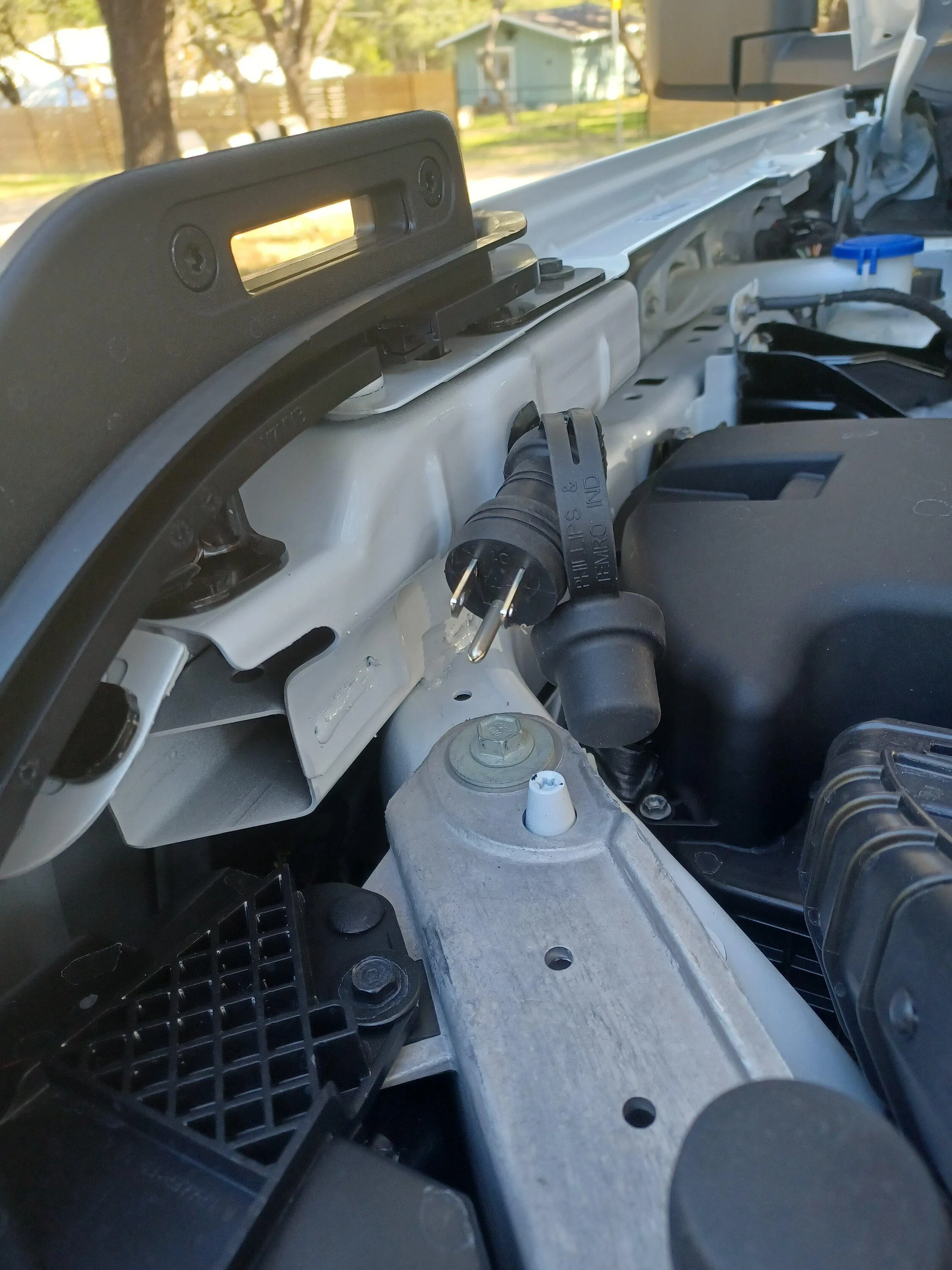

I checked the block heater as an option when I ordered the Low-Q Bronco.
$110 option. Well worth the money if you ever need it.
Posted this pic on Fascistbook with the caption "Plug-in Non-Hybrid".
Got a bunch of feces from former frens-of-mine who live in cold country.
It's my money, and my truck...I'll do what I want with it.
