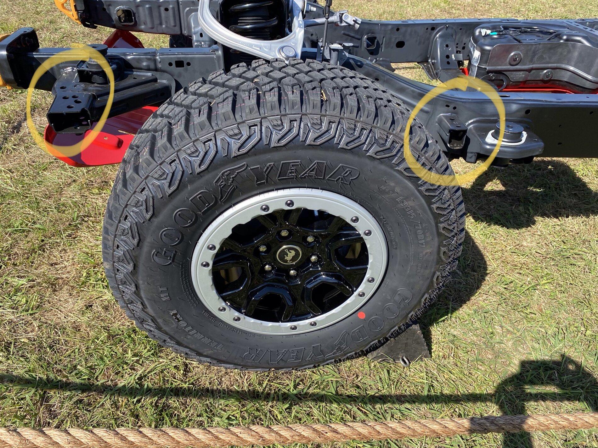

I was looking at this too but one thing of note is if you order a non squatch Bronco, it will have the crash bars in the front wheel wells and a 35 or 315 will very likely hit those when turning the wheel (even though width-wise with an 11.5 wide yo should be fine) so you’ll have to cut them or remove them As the 35” height would be the issue. Ordering squatch means the Bronco comes with much shorter crash bars to accommodate the 315 tire.
In the below pic is the squatch chassis and I circled the shorter crash bars. These ARE like 6-8” longer on non squatch Broncos. See 2nd pic for non squatch.

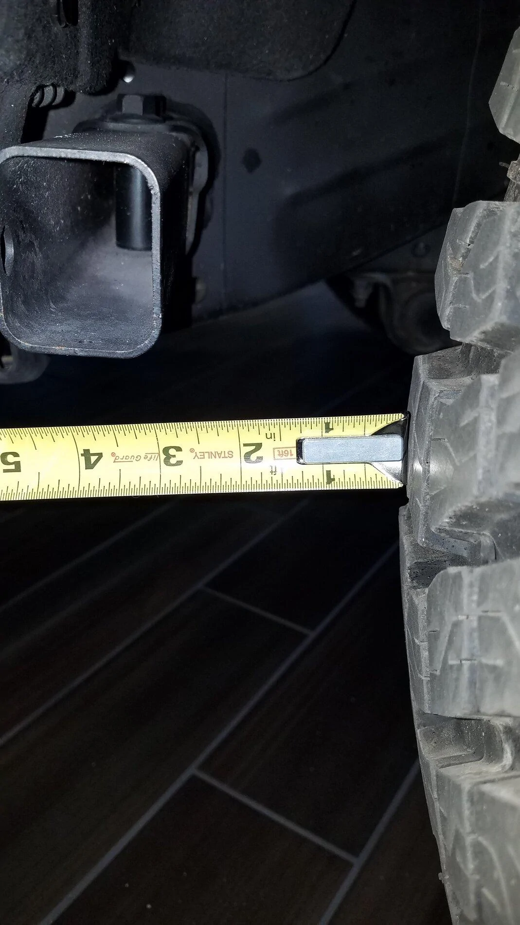

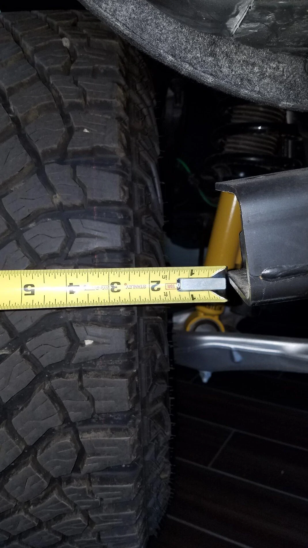

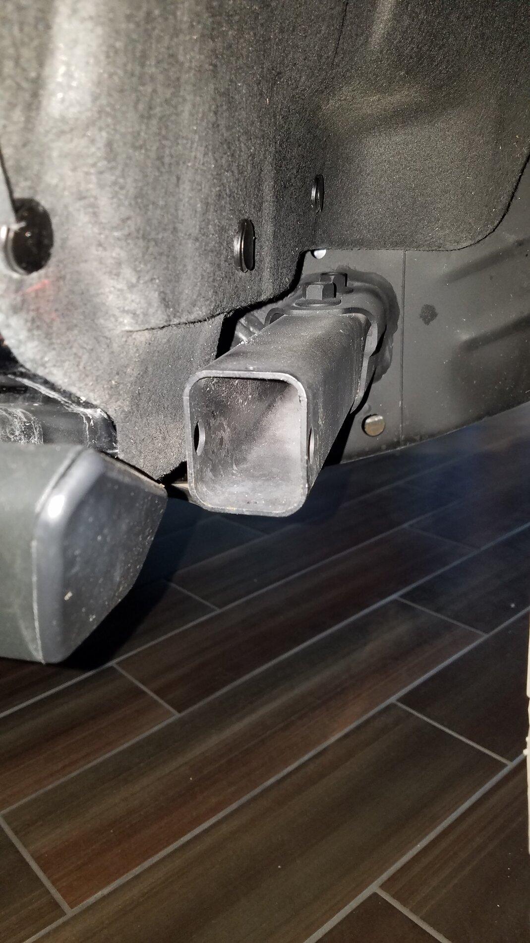

Crash bars don't come out in front of the tire. They stop about 1 1/2" before the inner plane of the wheel. And from what I saw, easily
Ford Bronco Wheel offset confirmed for optional Badlands wheel (+55 offset) 20201202_161824
removable.
Hmmm, I assumed that the pic of the Sasquatch frame just doesn't have the extensions bolted on. Without the extensions, they are pretty much useless.

Crash bars don't come out in front of the tire. They stop about 1 1/2" before the inner plane of the wheel. And from what I saw, easily removable.
Is that true for the rear crash bar as well? It looks like it would come out past the inner plane of the tire, unless it was removed
That picture is the rear crash bar for the passenger side front tire.
I couldn't get an angle to get the distance between the wheel's inner plane and the bar.
Best I could get is this
Thats a Badlands with the 285s right? Man thats gotta be cutting it close for a 315 when turned. Im thinking maybe Ford made them removable for the squatches and they will come without those extensions?
