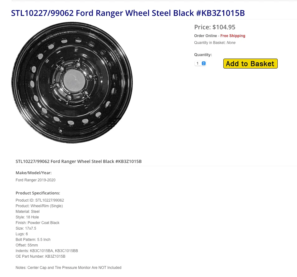

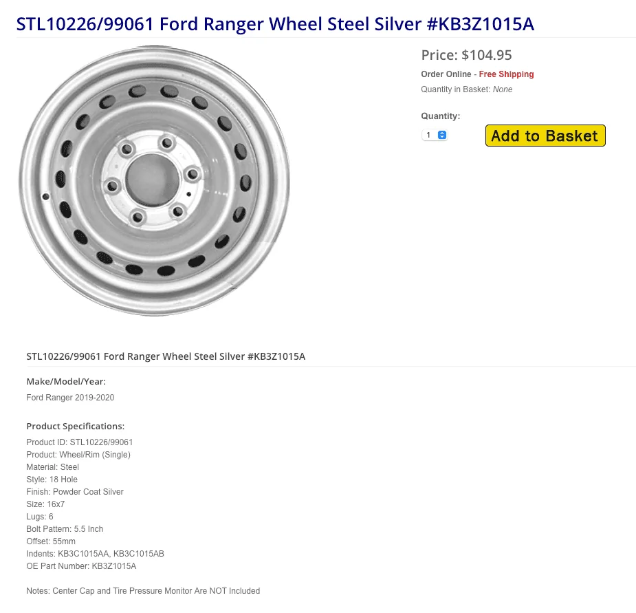

Does this mean that wheels for the current Ranger are basically interchangeable? (same bolt patter, offset, etc)
Looks like the steelies may actually be shared across the platform (which makes sense).

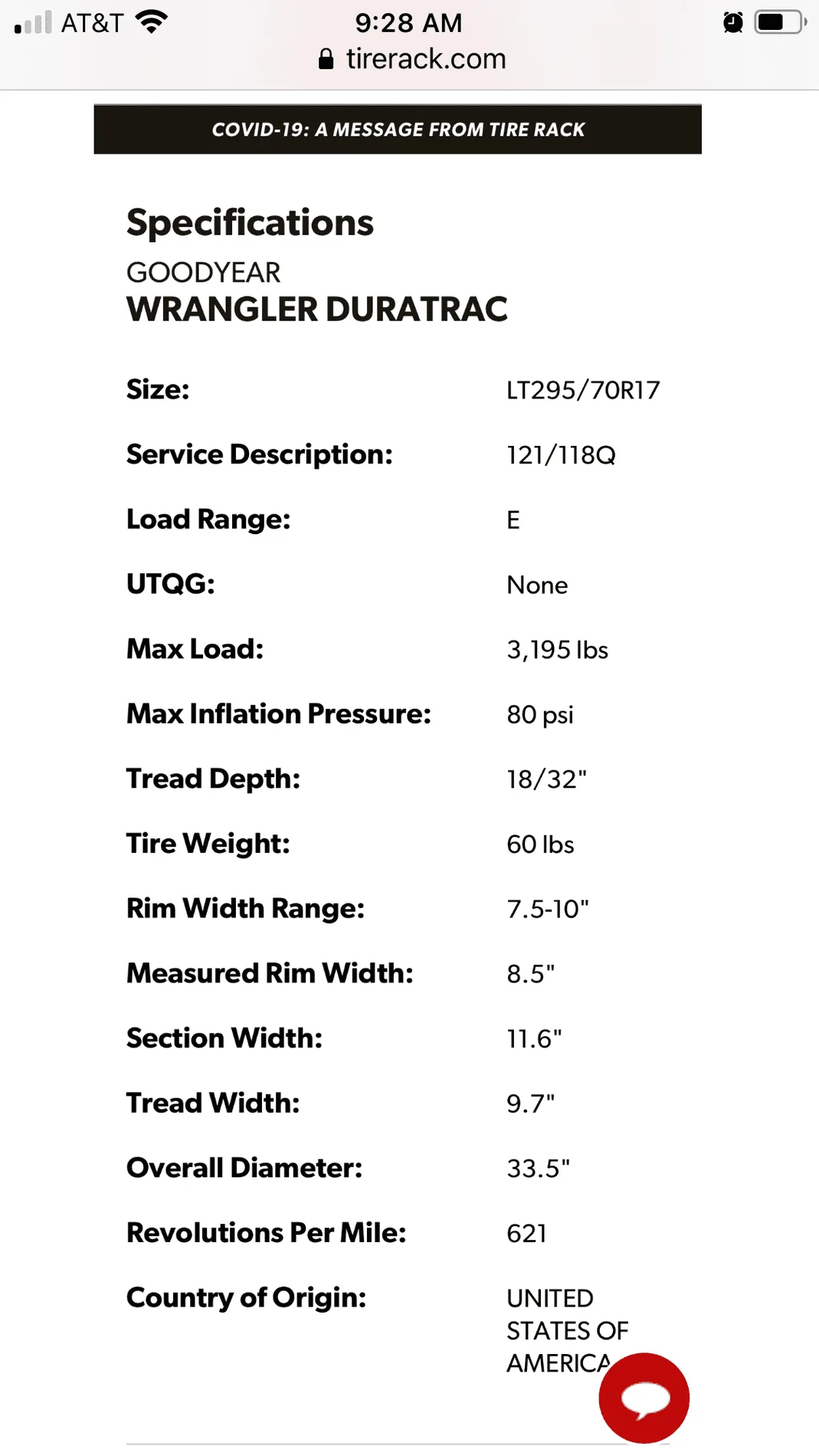

I already came to the conclusion that non sas wheels are +55. In short, the answer is no. Although with a BL lift you may be able to squeeze a slightly larger diameter but that’s mostly because BL is 32.7 not 33.0”. Anything beyond maybe 33.5” on BL is too tight to predict without testing in person. ...Unless you want to cut into or remove the crash bars....the OBX has 0.7 less lift than a BL and the absolutely tightest I’m seeing on paper is is slightly narrower tire (11.0 vs BL 11.2) at 33.2 dia. That’s a 275/70/r18. I haven’t toggled through upsizing 17s but don’t think you could go beyond 33.5 dia while keeping a 11.2 depth on a BL suspension.
So Duratrac 295/70R17’s are a maybe:

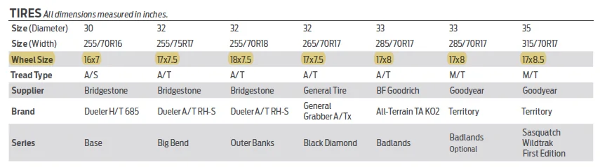

I was looking at putting Toyo AT/III's in 35X11.50R17 on these wheels (just a hair wider than 285s). Looks like I would be fine width wise clearing the arms. Probably will need a 1" or 2" lift to fully clear for diameter.
