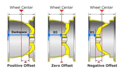

Offset and backspace are essentially two different ways of looking at the same thing. They determine the location of the wheel and tire assembly when bolted to the vehicles hub.
Offset is the measured distance between the hub mounting surface and the wheels center line.
With X being the determined offset, the hub mounting surface on positive offset wheels is X amount forward from the wheel center line. The hub mounting surface on negative offset wheels is X amount backwards from the wheel center line. The hub mounting surface on 0 offset wheels is the wheel center line.
Backspacing is the measurement from the hub mounting surface to the back edge of the wheel.
***Typically speaking, the higher the offset/backspace, the more the wheel will tuck inwards towards the suspension or away from the fender. The lower the offset/backspace, the more the wheel will push out away from the suspension or towards the fender.
For Example:
*If the offset on a 9" wide wheel is +12mm, the hub mounting surface will be 12mm forward from the wheels center line. Measuring from the hub mounting surface to the back edge of the wheel, the backspacing is 5.5"
*If the offset on a 9" wide wheel is -12mm, the hub mounting surface would be 12mm towards the back of the wheel from the wheels center line. Measuring from the hub mounting surface to the back edge of the wheel, the backspacing is 4.5"
Here's how to calculate the backspacing using the rim width and offset:
First - add 1" to the rim width and then divide by 2 to find the wheels center line (you have to account for the wheel flange which is why you add 1" to the rim width) . Second - convert the offset which is in millimeters into inches. There is 25.4mm in 1 inch so divide the offset by 25.4. Lastly - add the converted offset to the wheels center line if the offset is positive for the correct backspacing. Subtract the converted offset to the wheels center line if the offset is negative for the correct backspacing.
For Example:
17x9 +12mm offset
*9" rim width + 1" = 10"
*10"/2 = 5" (wheels center line)
*+12mm offset/25.4 = 0.47" (0.50" rounded up)
*0.50" + 5" = 5.50" Backspace
17x9 -12mm offset
*-12mm offset/25.4 = 0.47" (0.50" rounded up)
*0.50" - 5" = 4.50" Backspace
***Please note that the wheels center line is the backspacing for 0 offset wheels.

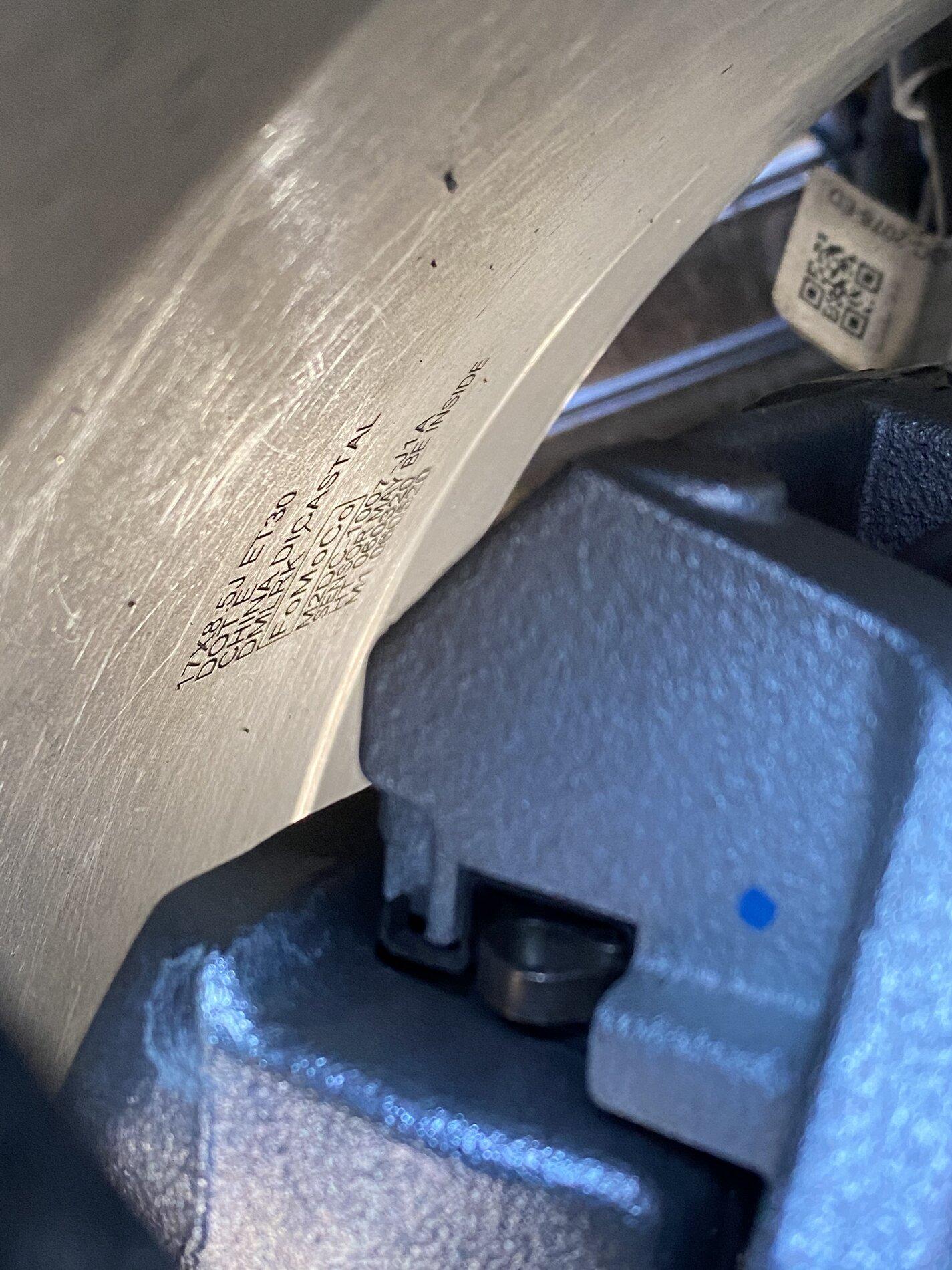

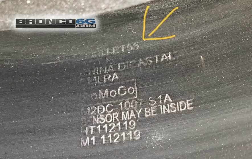

In AZ someone crawled under the 2 door Badlands and snapped a picture of the upgraded non-Sasquatch wheel and it was stamped as a 55mm backspace.
https://www.bronco6g.com/forum/thre...d-for-optional-badlands-wheel-55-offset.9585/
Right - that is the thread I linked to, because @LEGEND posted the 8.5” Sasquatch wheel has a 30 stamped on it. The difference between the two makes sense because it fits the math of how you get from Badlands width to Sasquatch and width. (You’d need wheels that stick out about an inch further plus 1/4” of wheel width plus 1/2” of tire width.)

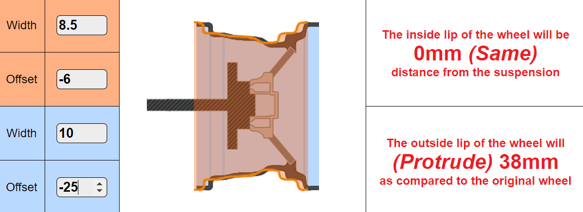

Just found this video that helps explain the matter and somewhat reduces my confusion. The problem with the video is the use of different terms to express almost but not quite the same concept. The two terms are "higher offset/lower offset" and "positive offset/negative offset." It seems that offset is related to the position/distance of the centerline of the wheel and the surface of the wheel hub that mounts to the axle hub. Backspacing is in relation to the same thing. The narrator seems to use the terms interchangeably without making it perfectly clear the relation between the two different terms. The pictures for both concepts are identical. One has to infer to much.

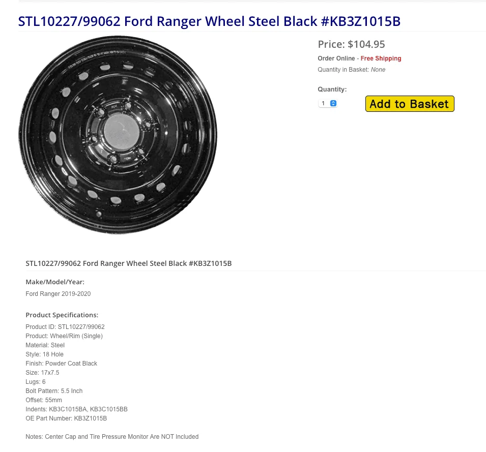

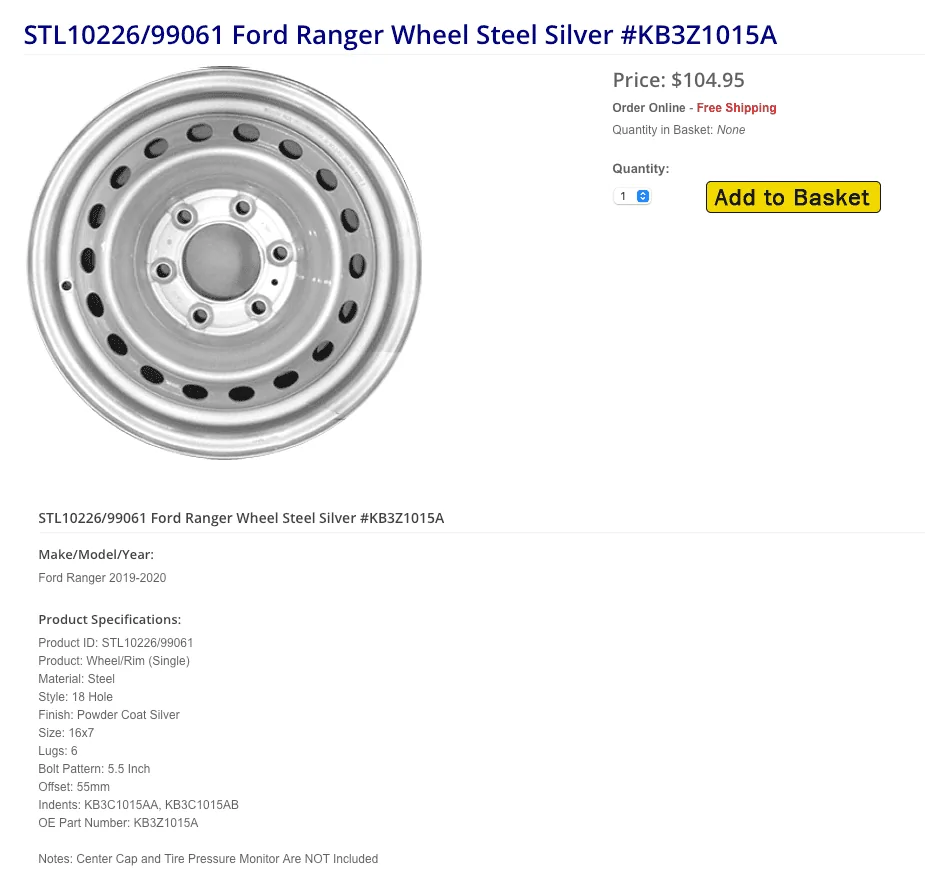

Certainly possible, but we can not confirm that to be the case at this time.
Sasquatch Wheel:
Ford Bronco Wheel Offset and Backspace | How do they relate? 3E0F10B5-39BA-4455-9185-A21ACAACFD92
Upgraded BL Wheel:
Ford Bronco Wheel Offset and Backspace | How do they relate? 4931FE6C-DE62-4DFB-9EBA-EA3288A5E713
Steelies off the Ranger that appear to be carried over to the Bronco:
Ford Bronco Wheel Offset and Backspace | How do they relate? A9EDBA3A-DD8B-4359-9F82-828EAFC141A8
Ford Bronco Wheel Offset and Backspace | How do they relate? 35EFD9C3-D601-45AC-BEDA-5164D4706232

Still very confusing. The big question that will put this matter into proper perspective is to know which side of the cross section pictures of the three wheels is the outside (closest to the exterior of the vehicle) and which is the side closest to the interior/engine block of the vehicle? This one simple little piece of information will allow one to understand the relational term of "back space." Help please.
The front face of the wheel is to the right side when looking at the image. We apologize for the confusion with that.
You're correct, offset is the position/distance of the mounting pad from the wheel's centerline, measured in millimeters. Backspacing is the distance from the mounting pad to the back lip of the wheel, typically represented in standard measurement.
I agree, the higher/lower offset and positive/negative offset can be confusing when the terms are used synonymously. When comparing two negative offset wheels, one could have a higher offset, such as 17x9 with -24mm offset versus a 17x9 with -12mm offset. The negative -12mm offset in this example would he higher.
Here's an example that may be useful:
When mounted on a vehicle, a 17x10 with 4.5-inches of backspace will sit different than say, a 17x8.5 with 4.5-inches of backspace, even thought the backpacking is the same. Specifically, the front lip of the 17x10 will sit 1.5-inches further out, however the inside lip of both sizes will have the same clearance towards the suspension.
Ford Bronco Wheel Offset and Backspace | How do they relate? 1607952726637

For the Bronco, I am getting the base 30s on steel wheels and then getting 32s, maybe 33s with alloy wheels from Discount Tire to swap out. Would love to get advice on whether I can get away with a 16" v. the 17s and get more tire/less wheel. Also, I don't think I can handle getting bigger tires than my Mustang ones down into the basement. Which means, I might have to pay to store them.
Thank you for your continued support of Discount Tire! We greatly appreciate that and look forward to helping you with your Bronco as well.
We are still waiting on measurements, but if the brake package allows for it, dropping down to a 16-inch combo shouldn't be an issue.

Thanks to Discount Tire! First of all let me say that I know very little about tires.
But I was running tire numbers this morning. Previous posts here say that Badlands optional wheel has 55mm offset. I assume standard wheel is the same. Maybe. If so, backspace is 6.66". Distance from mounting plate to outside of wheel would be 2.34"
I was looking at Fuel Wheel Vector, 8.5" with a 7mm offset, making backspacing 5.02". Distance from mounting plate to outside of wheel would be 4.48".
So inside of Fuel wheel would be 1.64" closer to the mounting plate compared to the Badlands wheel. So 1.64" of extra clearance laterally. This in my mind says that rubbing should not be a problem.
But the Fuel wheel would stick out 2.15" farther on each side. Is there a downside to the wheels sticking out 2.15" farther? Or any other downside that I don't know of?
