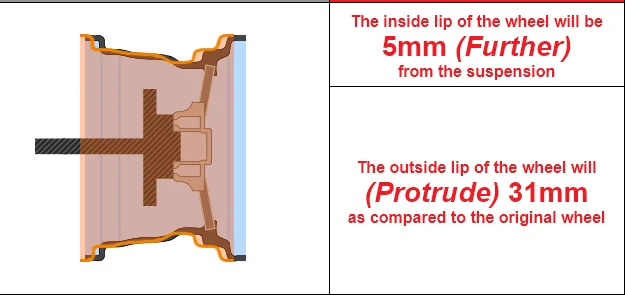

@Discount Tire wondering how well a 18”x 9.5” x +12 offset wheel on a 37 would fit a Sasquatch that’s lifted 2-3”? Some poke is ok. The BR Abram wheels for 18” have 3 options (+12, 0, -18)
If I stay with 17s then they come 8.5” (0, -18)
My tire options are Cooper STT Pro & Toyo M/T
Discount Tire
Discount Tire
Feb 4, 2020
775
886
Arizona, USA
discountti.re
All Things FORD
The +12 should work, it is going to have a little poke however not as much as the other options would.
To give you a visual:
Ford Bronco Wheel Offset and Backspace | How do they relate? 1652361992963
If you put a tape measure on the outside lip of your stock wheel the 9.5" width with a +12 offset would be 31mm(1 1/4") farther out.

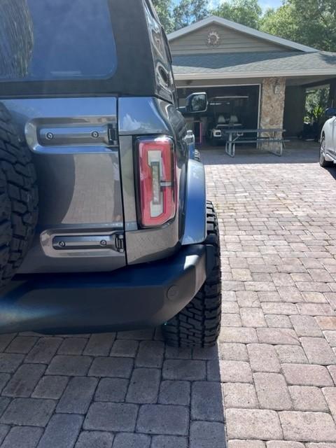

Jeverall
James
May 15, 2022
132
109
Tampa fl
Jeep Grand Cherokee
Im looking to add 20 x 10 wheels, with -19mm offset, 325/60/20 tires.. My non sasquatch Outerbanks is lifted 2.5" in the front, and 1.5" in the rear. I do not plan on doing any offroading. It already came with 35"s (315/70/17)and seems like there should be plenty of room. I think my current offset is 0 or -18, so seems like I should be good?
Ford Bronco Wheel Offset and Backspace | How do they relate? OBX BACK
Discount Tire
Discount Tire
Feb 4, 2020
775
886
Arizona, USA
discountti.re
All Things FORD
Even with the crash bars removed this would be considered a rather aggressive fitment. Although it may still work.
PM on the way to further assist.

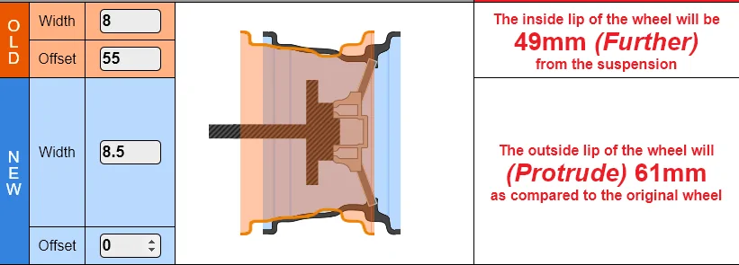

@Discount Tire i need the new gloss Bahia blue method wheels you all are selling! I have a badlands with a Sasquatch package. I want to run the stock tires can you please tell me what size wheel I should order? Thanks so much
Discount Tire
Discount Tire
Feb 4, 2020
775
886
Arizona, USA
discountti.re
All Things FORD
We would love to earn your business.
Regarding fitment,
The wheel is offered in both a 17x8.5 and 17x9. It looks like both should work when using the stock tires, some folks are running larger tires on either fitment as well.
If you were to put a tape measure on the outside lip of the stock wheel and measure out 2 3/8", this is where the outside lip of the 17x8.5 with the 0 offset would sit
Ford Bronco Wheel Offset and Backspace | How do they relate? 1664199447964
The 17x9 with a -12 wheel would sit a little over 3" out when compared to the stock wheel.
We can help further, pm on the way.
