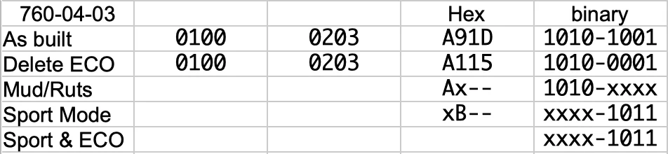

2026 may come with Sport mode. Previous years did not, but some people are adding it using FORScan.
Mine came with Rock Crawl which is not listed in motareso's list.
I just removed ECO mode from mine. I have a manual so it didn't do anything useful.
FYI... ECO mode and Sport mode live at the same address and appear to share a bit. So I'm not sure how compatible they are. Just because something displays doesn't mean it works as Ford intended once you start messing with things.
The spreadsheets, and FORScan show data in hexidecimal format. I broke it down to binary to see what was going on at the relevant address. All Badlands Broncos probably have the same As Built settings as I did. You'll see that the bit that gets cleared (set to 0) when removing ECO mode gets set to 1 when adding Sport mode. This may explain problems some are reporting when trying to set all eight G.O.A.T. modes.
I'm only showing the first two letters/numbers. The last two are a check sum that gets set by FORScan so I didn't show the binary values.
Ford Bronco what GOAT modes are there ? Sport:ECO GOAT modes
edit: I've been thinking a bit more. It could be the true setting for Sport mode without ECO is x3-- (0011) and not xB-- (1011). The B is there because the same address also controls ECO mode. I may explore this later if I get the time. All the other modes seem to need just one bit set to activate them. It would be odd for Sport mode to need two different bits set.

My ‘26 BL came with sport mode. No FORScan needed.
It would be interesting to see the settings for 760-04-03. I'd like to see how Ford got ECO mode and Sport mode to coexist.
