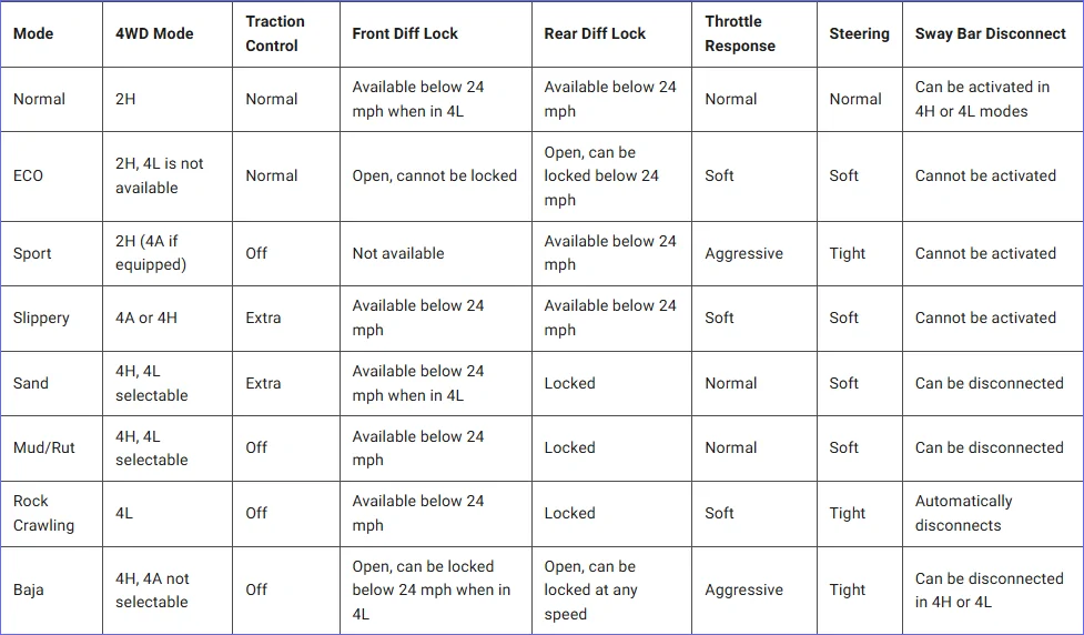

I'm trying to understand what changes are made to the Bronco for the different GOAT settings.
I know what changes are made to the 4WD system but not what changes are made to the steering, throttle and traction control?
I found a chart on this site and it mentions that the steering can be normal, soft or tight depending on the GOAT mode. Throttle response can be normal, soft or aggressive. TC can be normal, off or extra.
Is this correct info for non-Raptors?
Thanks

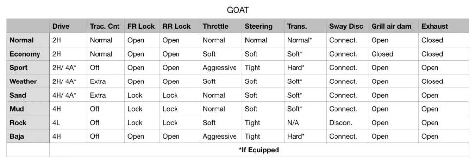

Drats. I don’t remember where I screenshotted this from but I believe it’s pretty close to accurate. I don’t know what “extra” TC is and the front locker doesn’t engage in any of the modes if I’m not mistaken.

Not sure about the details on the tuning of TC, Steering, and Throttle for each mode, but I think that table has at least one error:
TC is definitely off (not Extra) in Sand mode. You need to maintain momentum on soft sand so applying brakes or cutting back on engine power is not good. If you switch to Sand mode, your dash will indicate that TC is off.
TC is on in Sport mode, which makes sense for a high CG SUV being driven aggressively.
My suspicion is that the table has Sand and Sport reversed for TC and should say TC is “Off” for sand and “Extra” for Sport.
Yeah I’ve seen that chart floating around for a while, but I have no idea where it came from or how accurate it really is.

In my Badlands, I do notice that the throttle is more aggressive in Sport vs Normal, and that throttle is less aggressive in Eco vs Normal.
Logically throttle is also less aggressive in Slippery, and more aggressive in Baja but i never really evaluated it. This does align with throttle mapping designs I saw at Ford 15-20 years ago.
