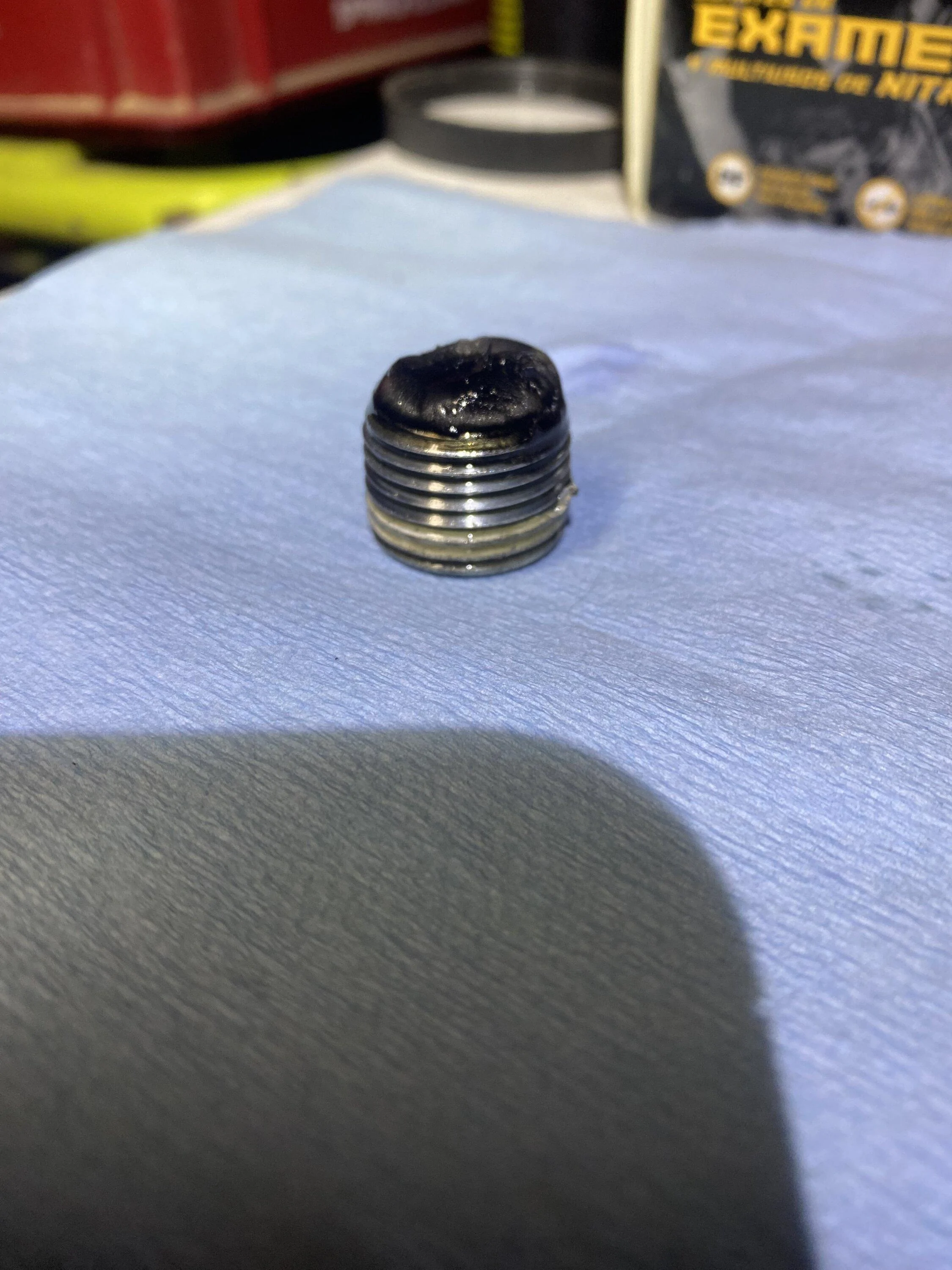

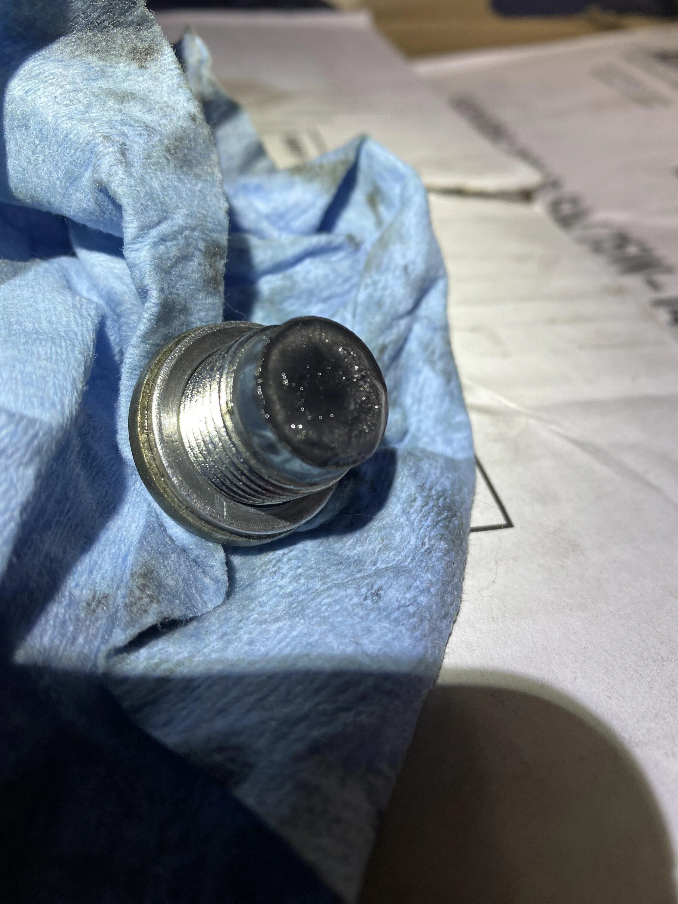

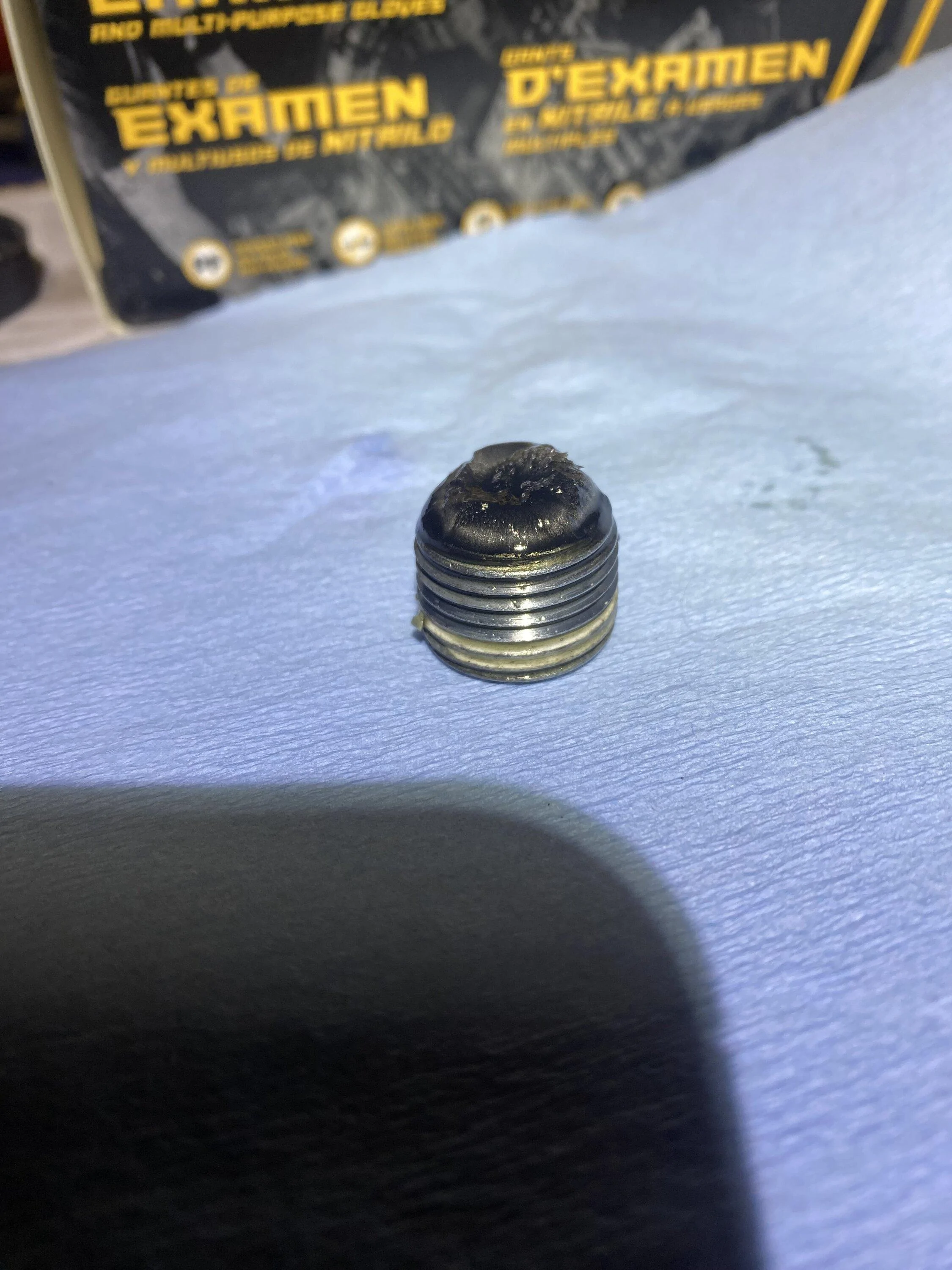

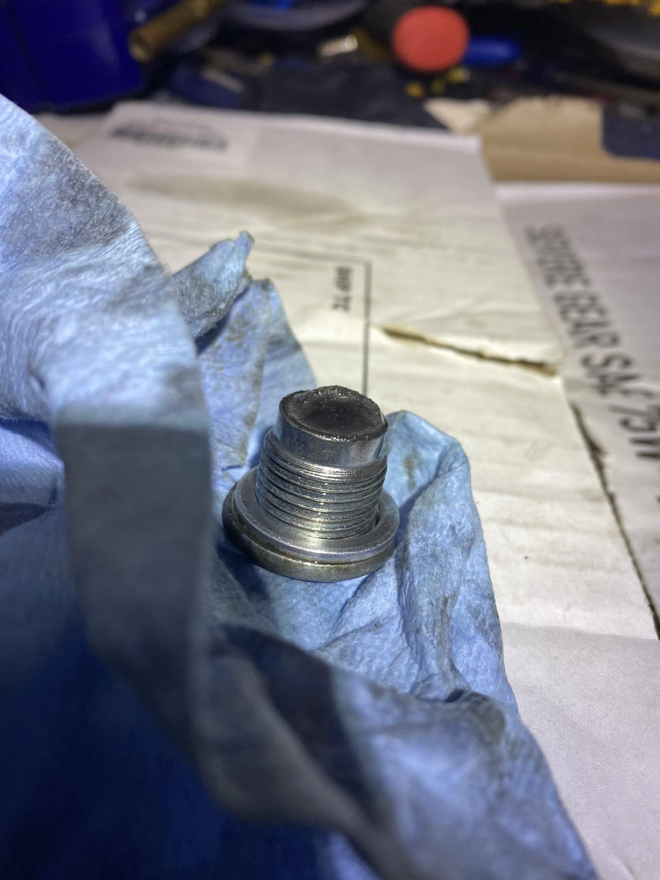

4A works SUPER on Badlands and Wildtraks here in Alaska .. But, make sure in the spring you get your transfer case fluid, front differential and rear differential gear oils changed.. The factory gear oils Ford uses are too light for winter heavy duty service.. Here is the metal from my transfer case with just 6700 miles.. Next pictures are the front differential that has only one quart of lube oil. Be safe whatever setting you use..
What Axle gear oil weight are you running?
I’m changing mine next weekend and installing my Ford Performance Diff Cover with AMSOIL Severe Gear 75w-90. Not going to the Dana suggestion of like 75w-160, but higher than the weird 75w-85
Doing this at the suggestion and smart advice of @CarbonSteel from his posts and videos in December.
Going to change my T-case fluid as well with the regular Motorcraft MERCON LV because not sure it matters much, but to your point, want to ensure all are properly full. My Bronco is just under 10K miles.
Just remember the number to the left of the "W" (which stands for Winter and not Weight) is the indication of winter performance.
