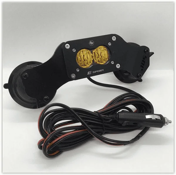

Found this, but it's only an idea of what I want as far as portability. I'm thinking a mount to slip over the tailgate on both sides of the spare so it will work with the top on or off. Either a one or two piece design that will hold an SS2 light on each side and just plug into the rear 12V plugin.

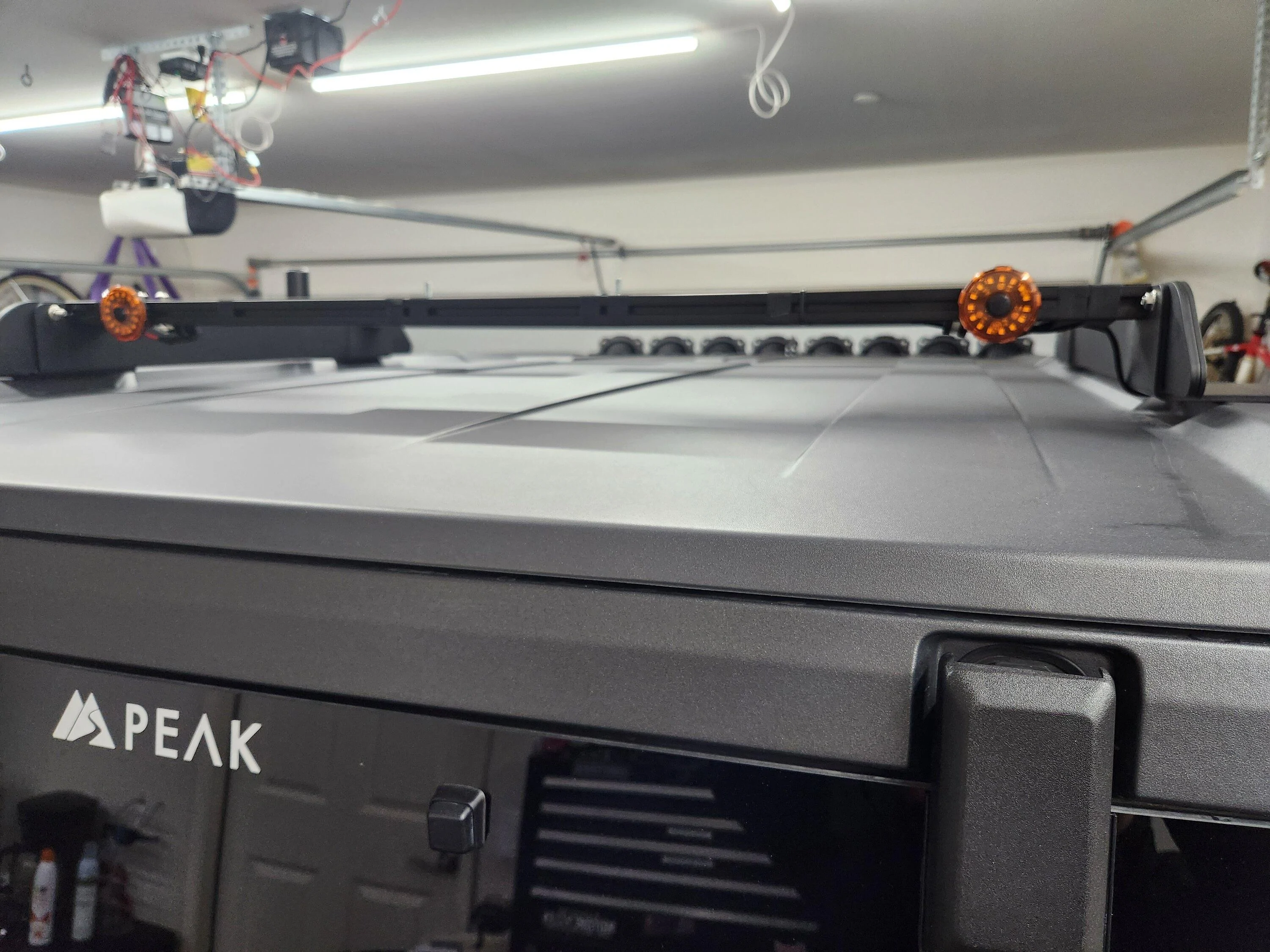

A little late to the thread it appears, but I ran wires from aux 6 to my roof rack and some KC cyclones. I ran the wire along the frame rail in the brake line brackets. Got it to the tailgate and then tucked it up under the top (I have a hard top) then routed it up the hard top to the rack. The KC cyclone v2s have a hole in the middle that you can put a 1/4x2 screw through, and then you just put the little cover over it and you'll lnever see anything. Looks pretty sweet.

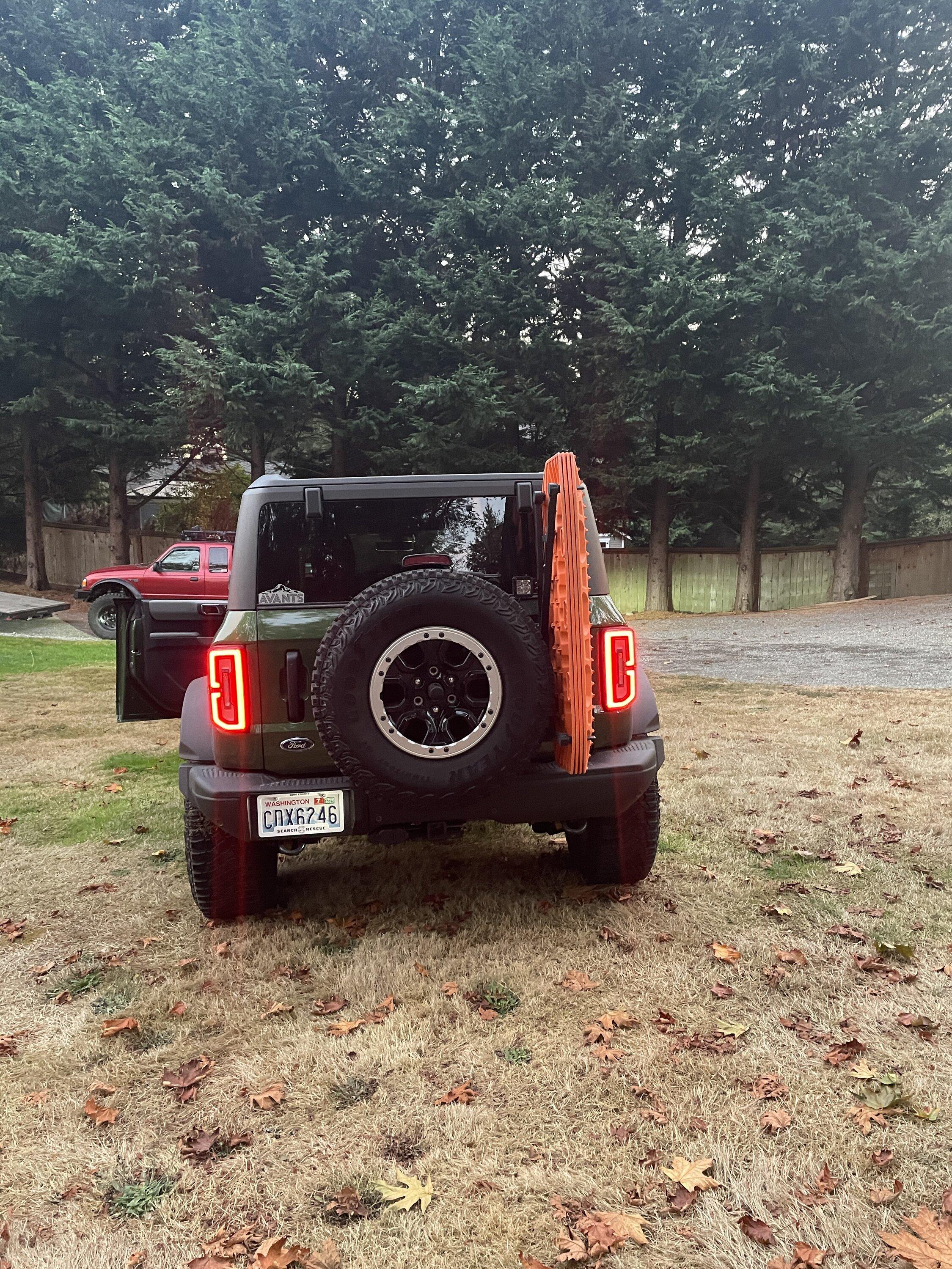

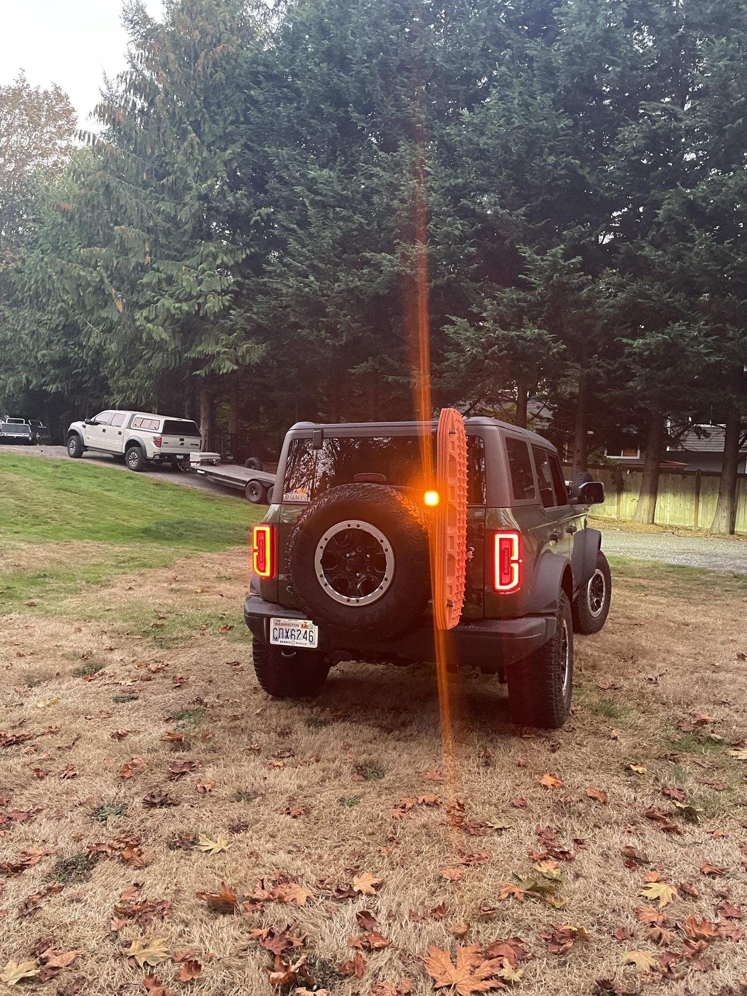

I have a fenix 400 light bar in the rear window and a rigid dually spot light (amber) on my rear rack.

I'd like the same solution! I want a pair of chase lights on a bracket, that can be easily removed prior to a trip, and simply run a wire into the cargo area and tap the cigarette lighter for power, remove when done with the trip.
Nobody seems to sell just the bracket, and I'm not sure how much power the cigarette lighter can deliver.

Answering my own question: the 12V socket in the back is rated for 20 amps, at least in the service manual. More than enough power for a couple lights. not sure I'd push that thing to 20 :)
I am thinking I'm going to order the Baja Designs kit, and just make my own solution of the included kit. I had hoped to mount it higher than that though, perhaps i can relocate the lights later. If/when I convert to a hard top, I hope someone creates the same solution you can use on the wrangler where the brackets that hold the glass can hold lights.
Got a link for that or remember where you found it?
Never mind, found it
https://www.jdscustoms.com/product/off-road-follow-light-amber-suction-mounted/

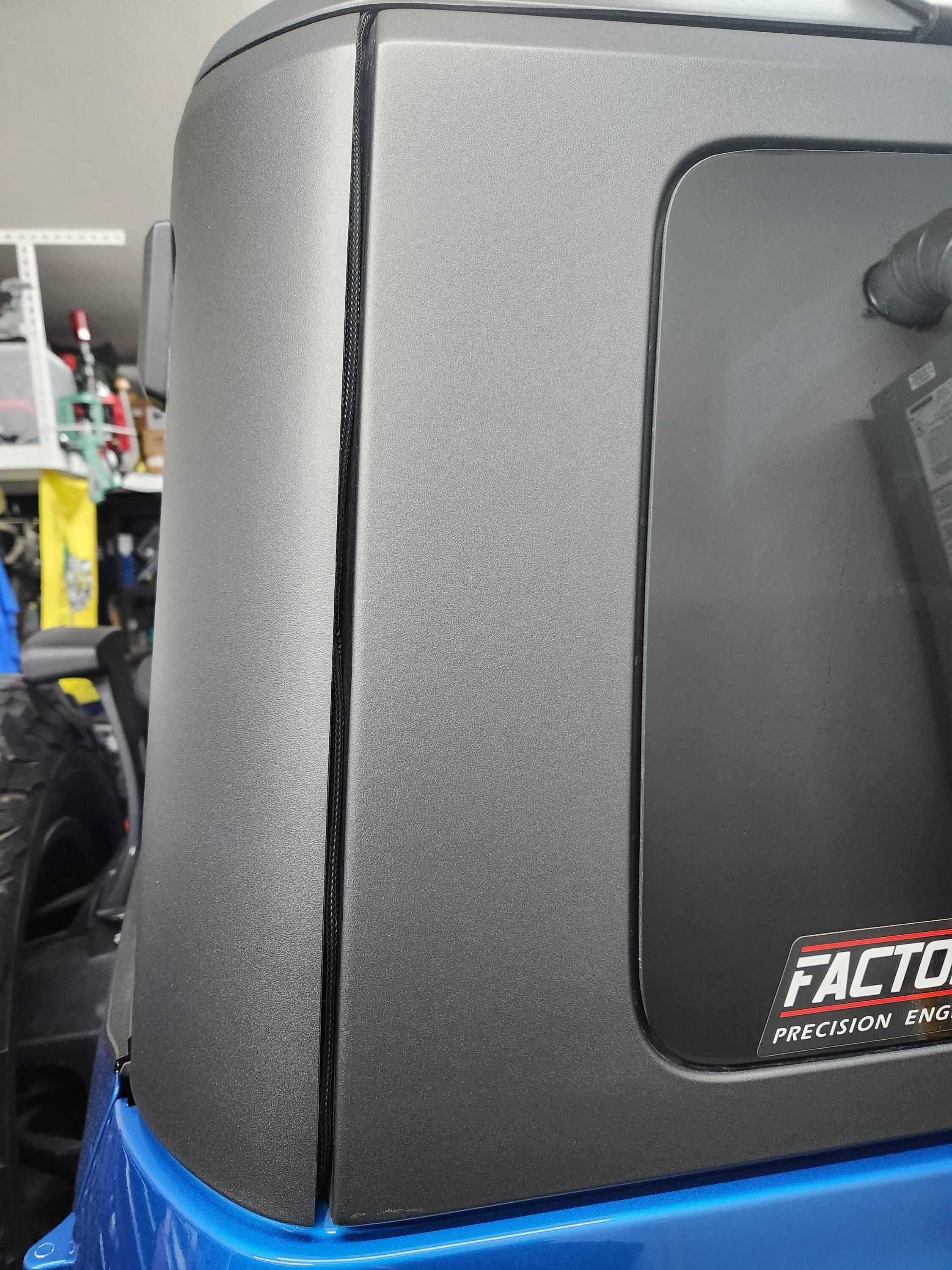

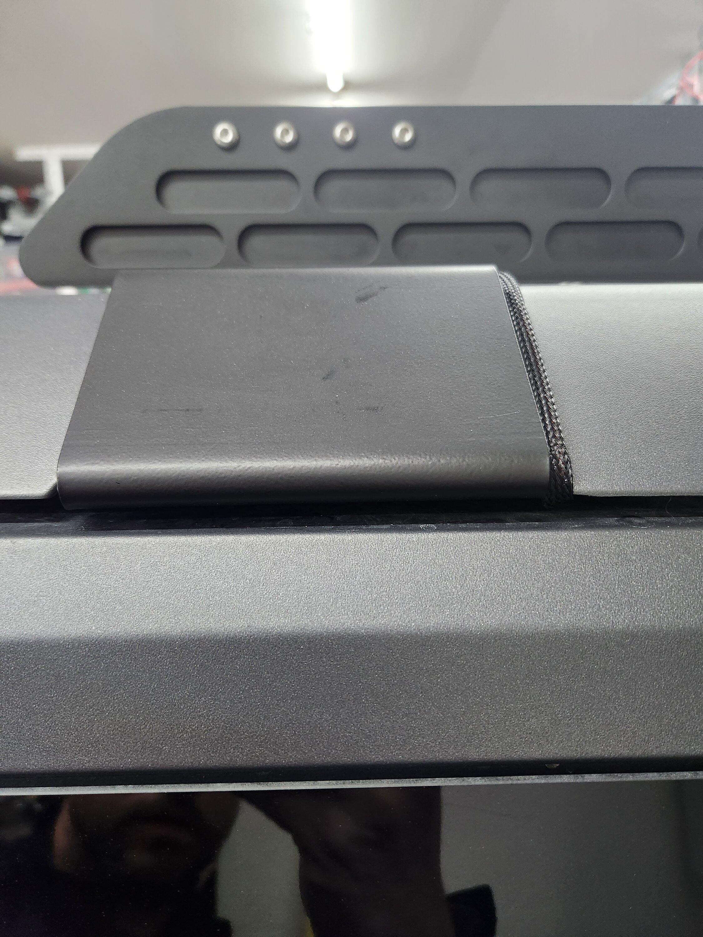

No, I routed it completely outside. Went along the frame rails, through the rear crossmember of the frame in front of the muffler, then back to the hinge area of the swing gate, threaded straight up through there to the corner of above the tail light. Then just tucked it in to the seams of the top. I'll take some pictures of the top routing after work, when there is light out so everyone can see. I wouldn't say it's perfect, but I didn't drill any holes, and the wires are still tucked in there as they were when I first installed it last month. I might try and find some rubber weather stripping or something to make it a bit tighter so the wires never move, but it isn't that big of a deal. I routed it in some flexible conduit to keep the insulation safe from abrasion against the top. The corners of mine are particularly sharp, so I'd advise anyone using this method to protect the wires from abrasion.
Edit to add pics, hopefully these sort of convey what I tried to describe earlier.

Looks clean Ryan. I think I will go this direction.
