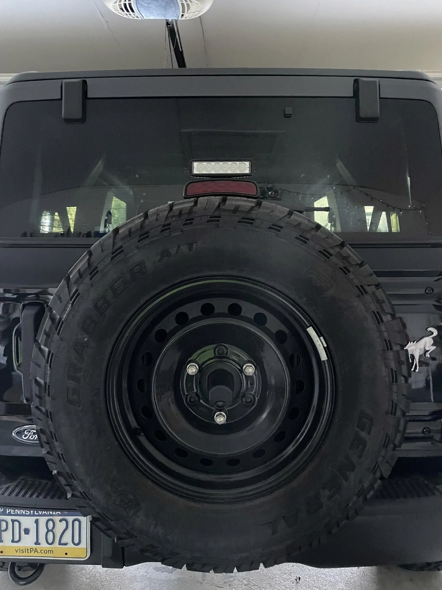

I used a 4" flood mounted to the upper break light and wired to AUX switch 6. needed something for backing up drive way at night (driveway is a 40 degree up angle then sharp left)
How did you mount it to the 3rd brake light?

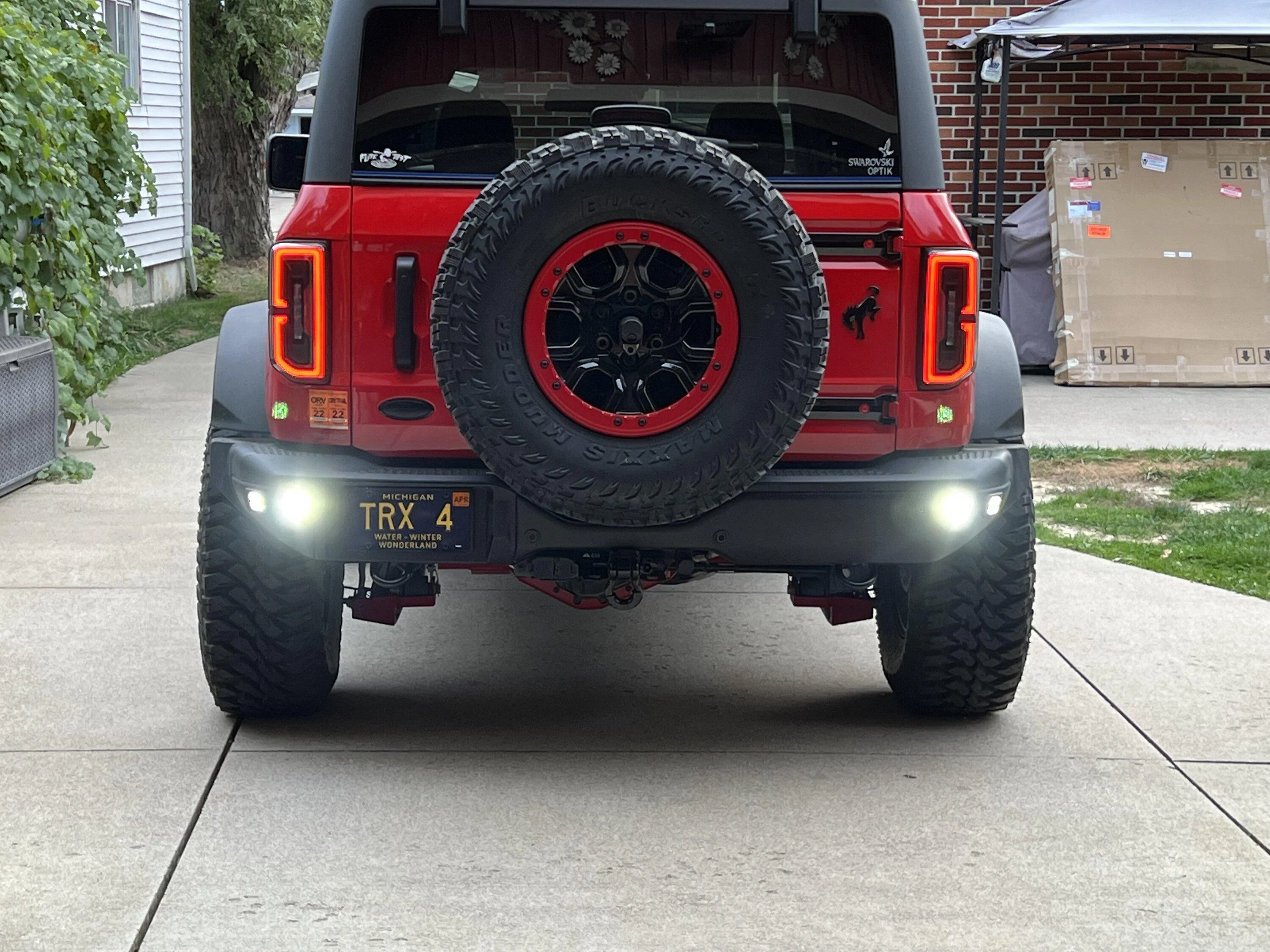

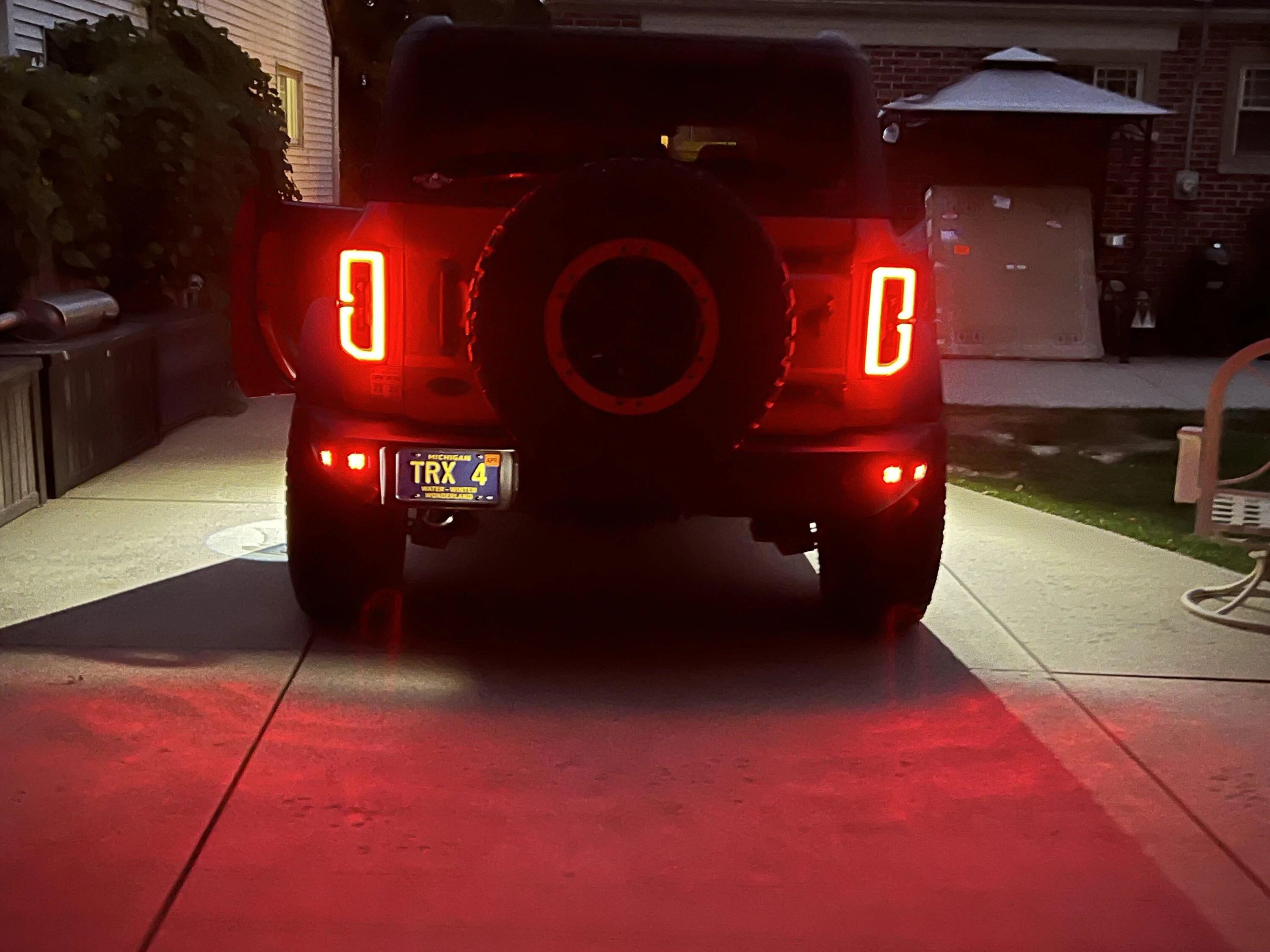

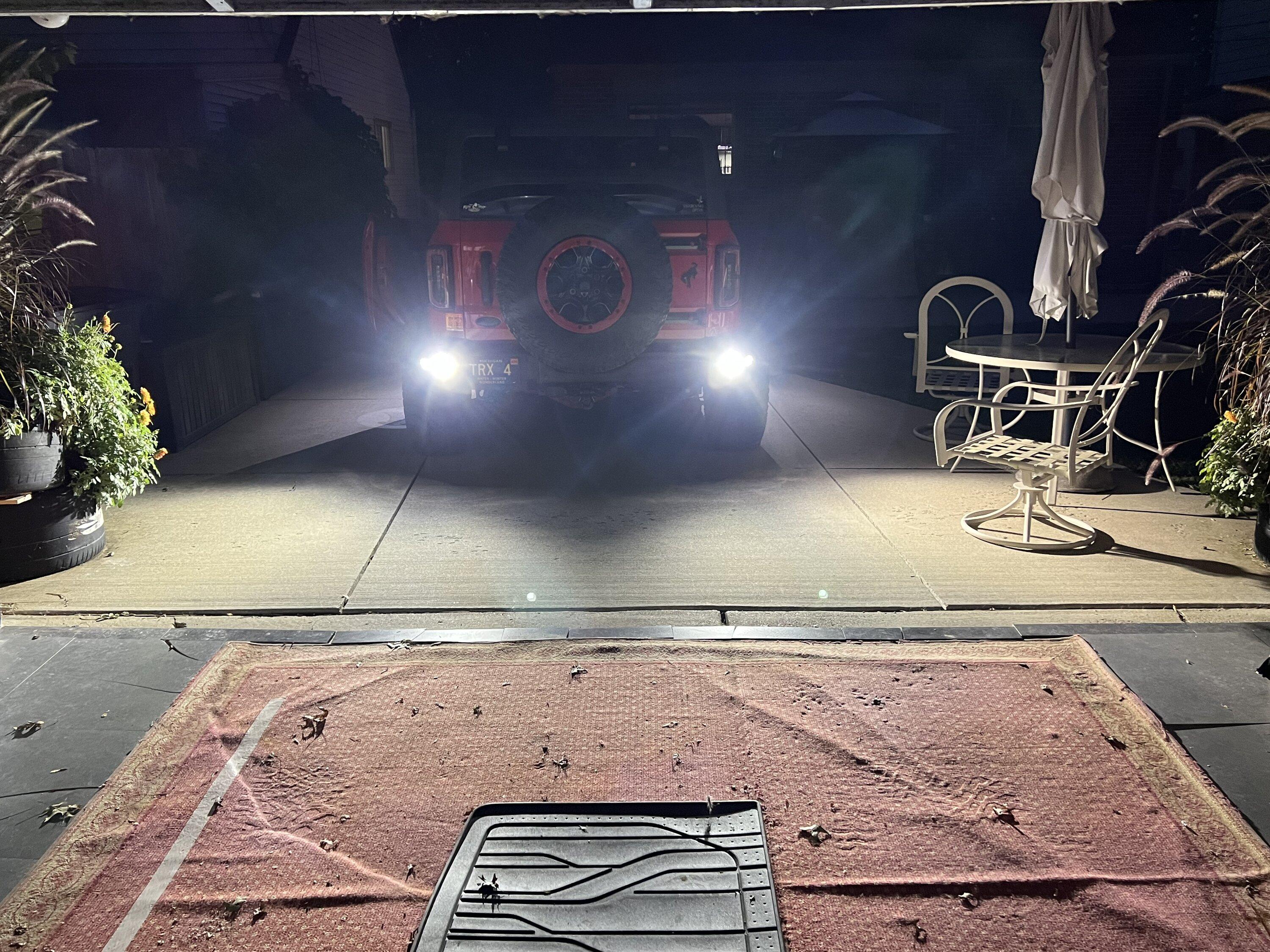

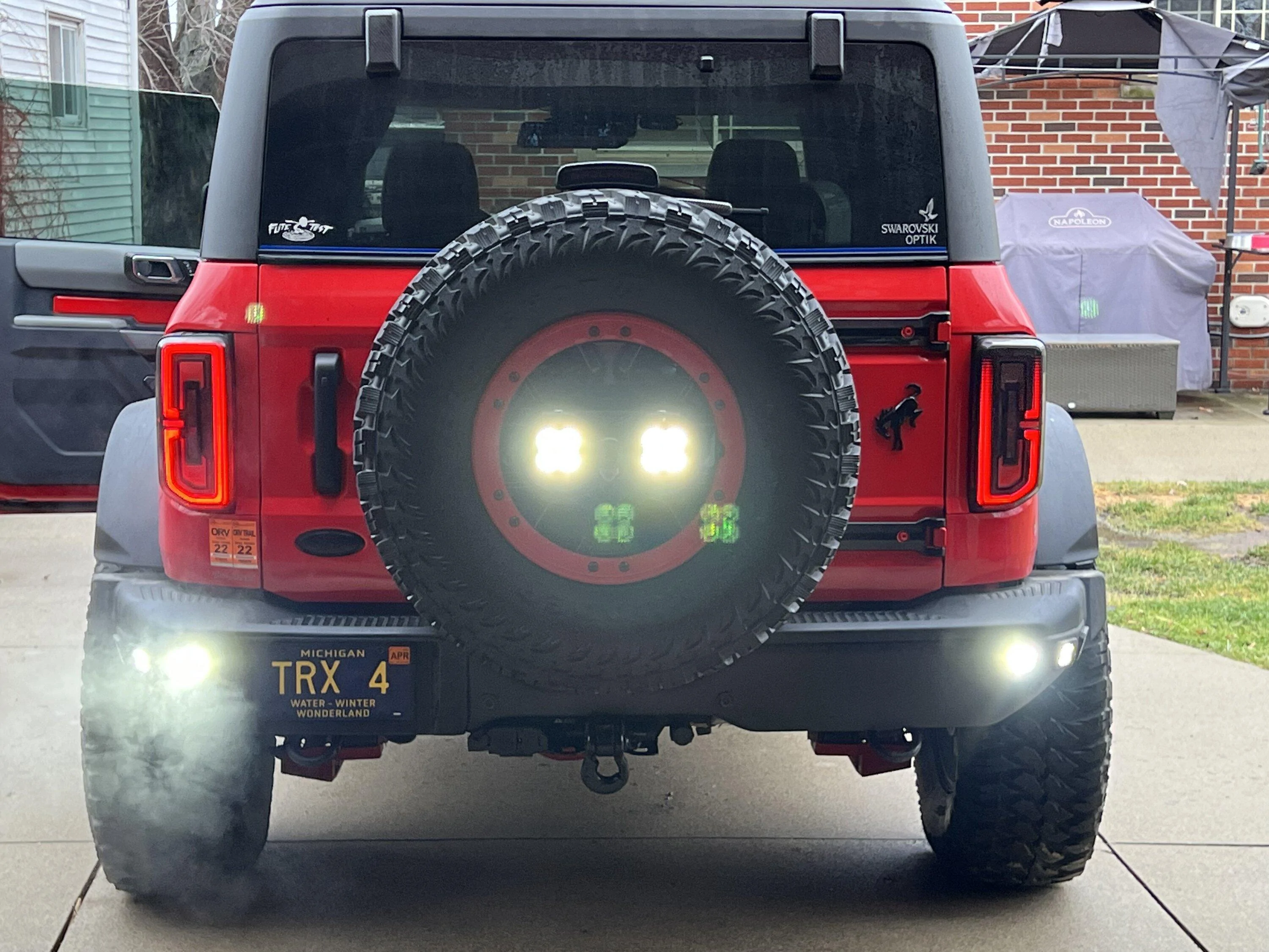

I run 6 ss1’s for chase in the rear bumper, added 2 more since these pics. Diode makes that plug in kit for the receiver and dual mount off the spare tire post also. Have to drill the bumper to install them like I did.
That is a nice clean look, way to go. I am curious though, how hard was it to cut the rear bumper to accommodate the lights? Is the bumper fairly thick?
It was thicker but was softish. Defiantly not like drilling the cage. I did a hole saw then some trimming on the edges.
Here is the original thread for the instal
https://www.bronco6g.com/forum/threads/diode-dynamics-ss1-flush-mounted-in-steel-rear-bumper.45510/

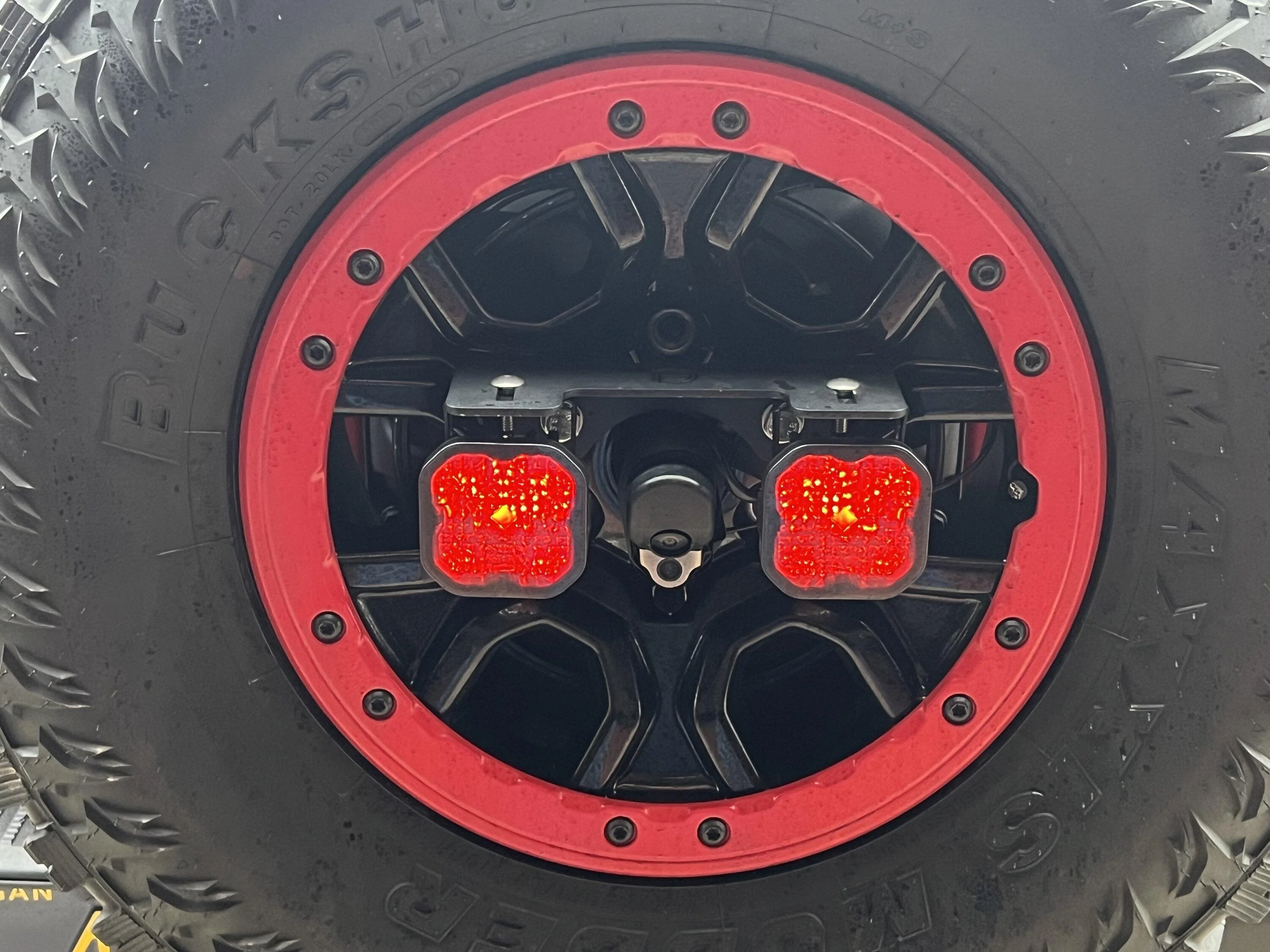

I also added the diode spare tire mount with a pair of ss3’s. Bumper mod is way cleaner looking imo. But they make for better chase lights being higher up I’d imagine. I can say I have no blind spots behind the truck now.
Thank you for the update, good to know the the metal is a bit soft, it will make the cut easier. The link was very handy too. Well done on the overall look of your rig!

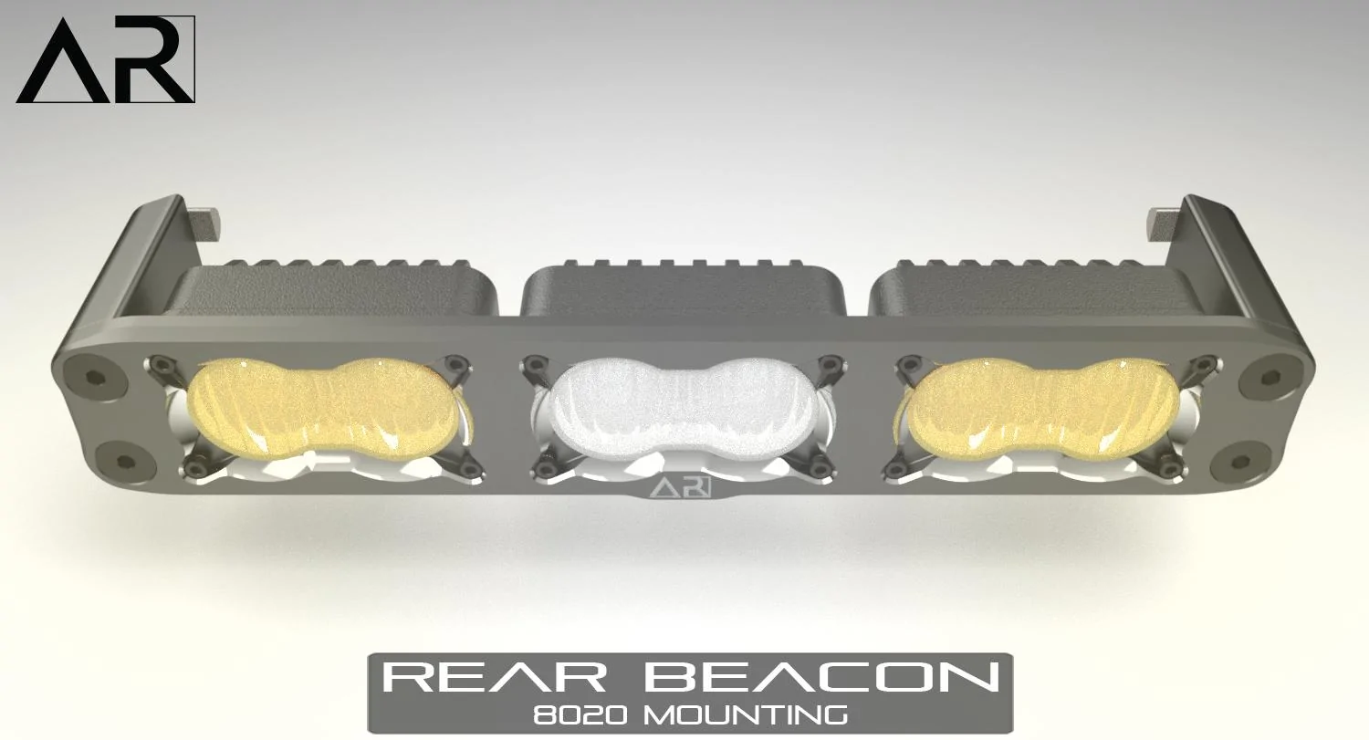

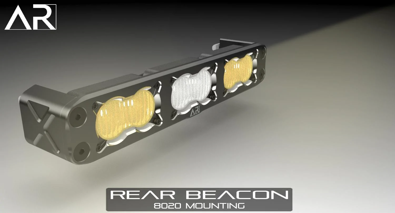

We're rolling out this billet mount setup now for triple @Baja Designs S2s. It will be available exclusivley through our website and Apollo Optics. Roof rack mount, auxiliary mount to the OEM 3rd brake light and spare tire mount brackets are also in development. Working directly with Baja Designs, we're taking light mounting solutions to a whole new level of awesome!

This is a great solution as well! Would love to see the mounting options mentioned, but understand you’re not quite there yet.

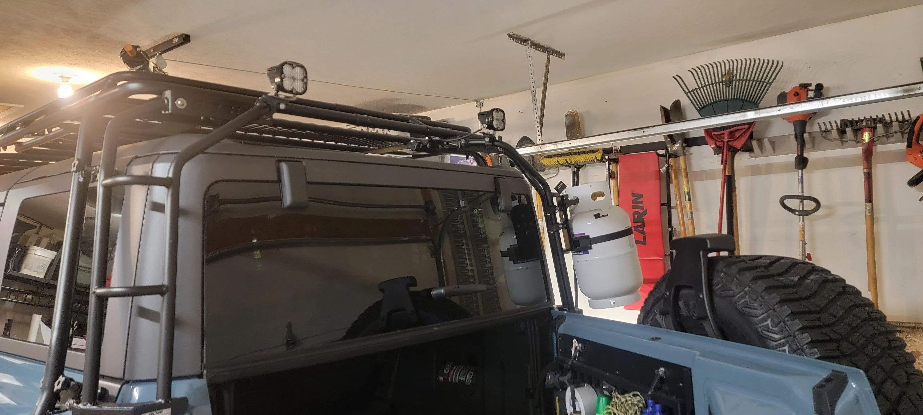

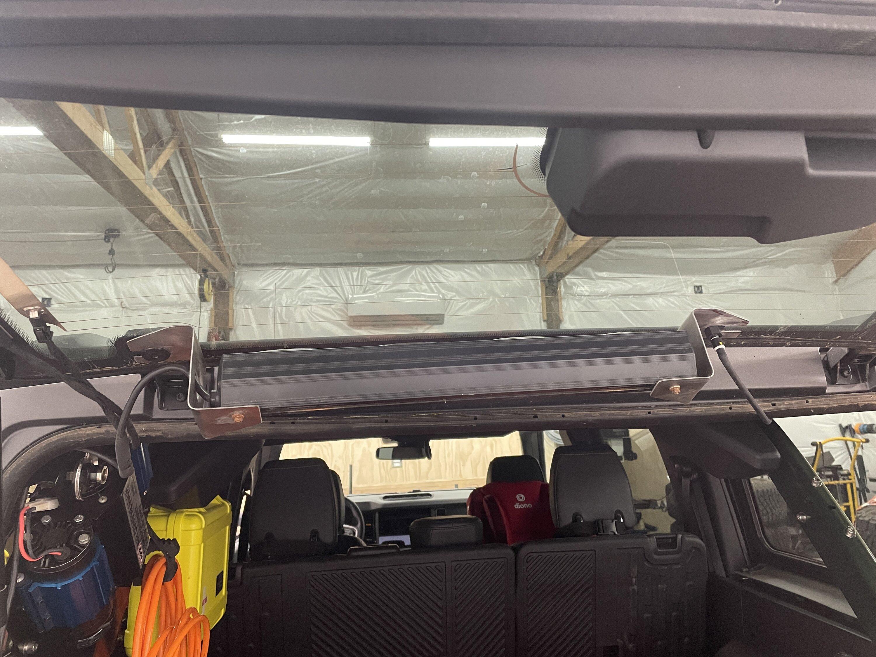

It works well, the mounts are plenty stout but if I were to do it again I would buy a bigger bad to span all the way to the other glass mount. (I had the 400 already from another build)
here’s a pick of the mounts during fab. They have 3mVHB tape under the mounts and are bolted to the glass hinge and washer spigot.
no major splash back, would be better if i made the mounts closer to the window, I have about an inch gap from the glass.
visibility is minimally impacted IMO

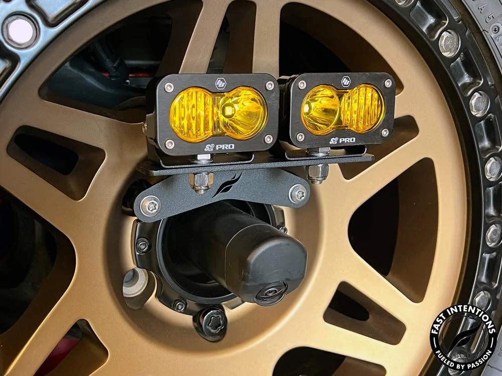

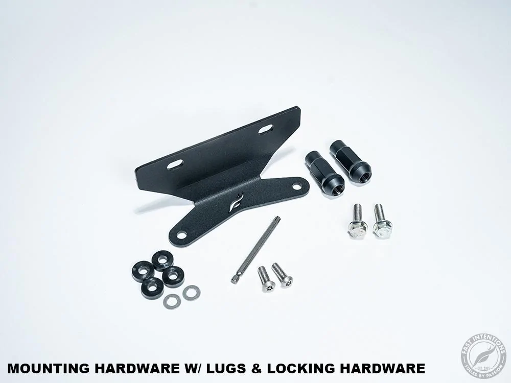

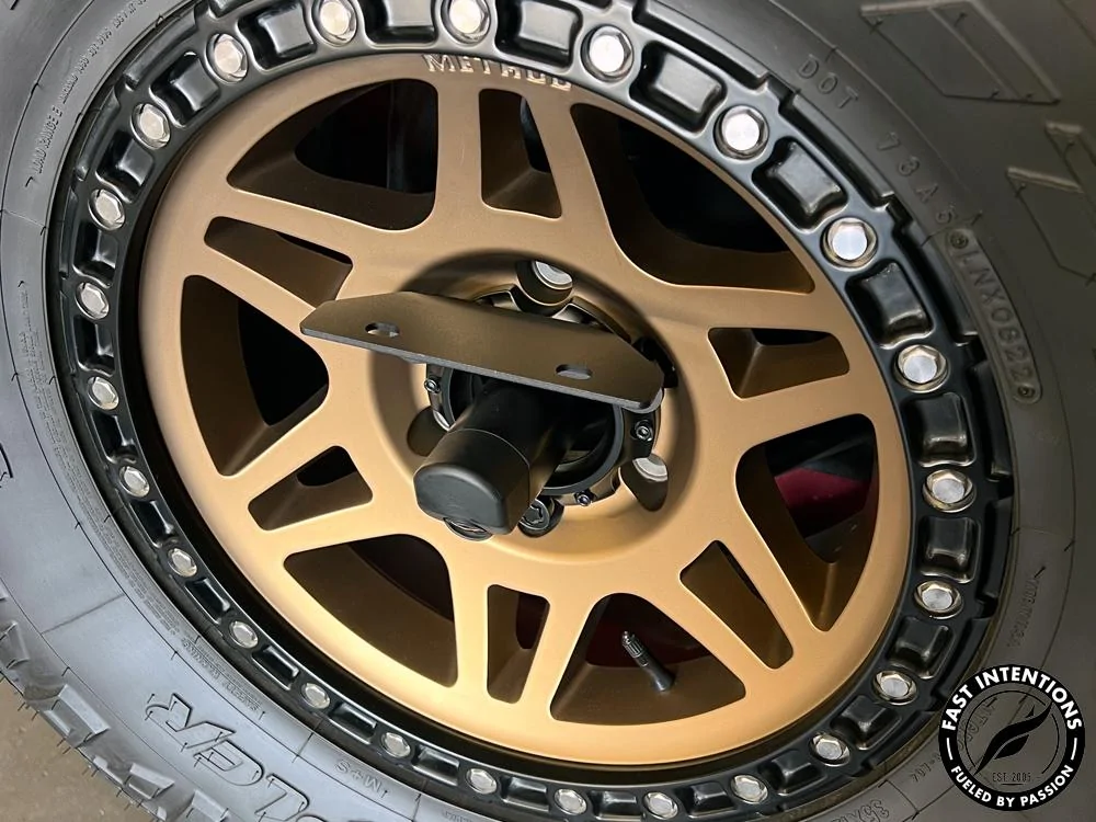

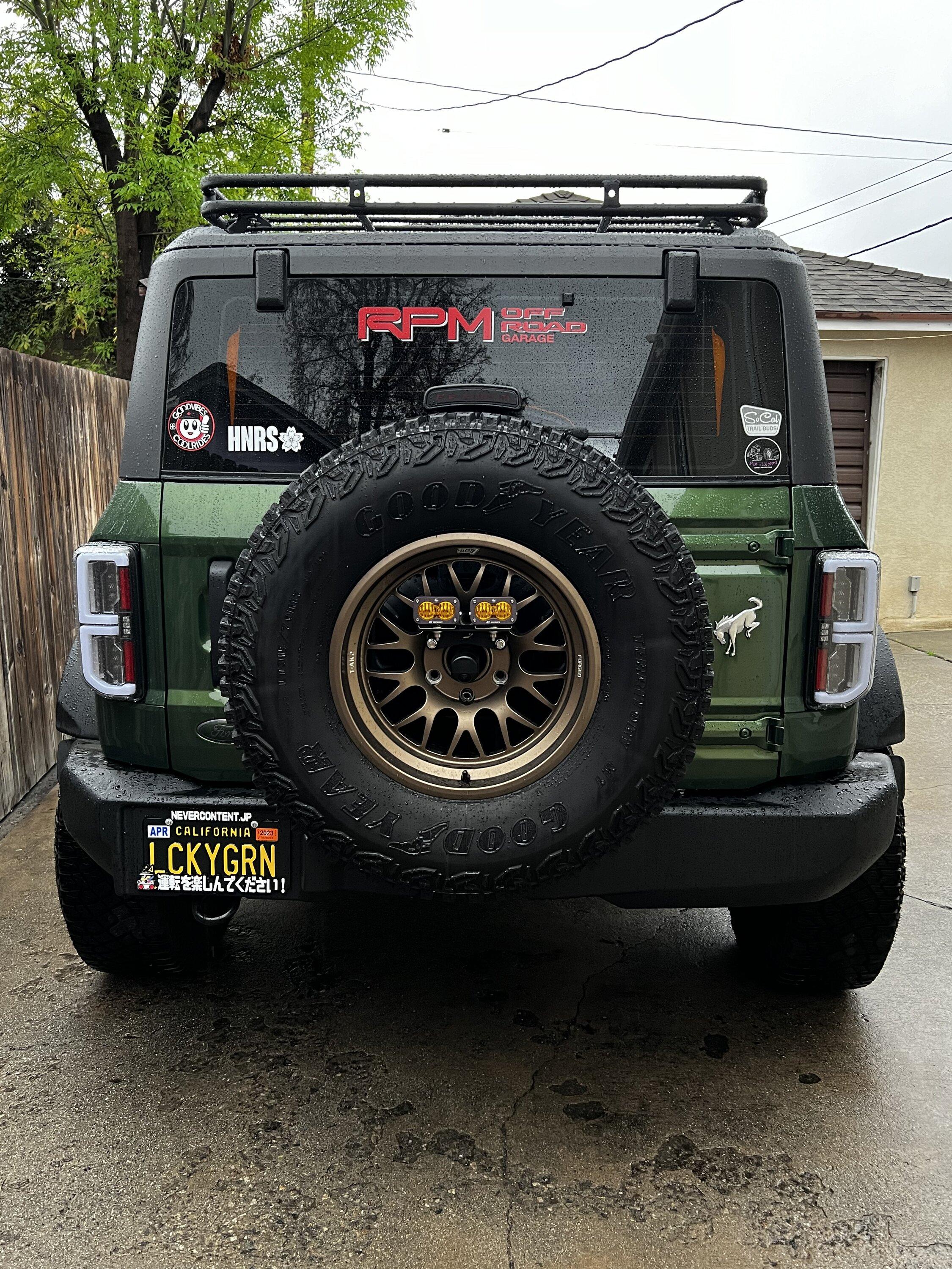

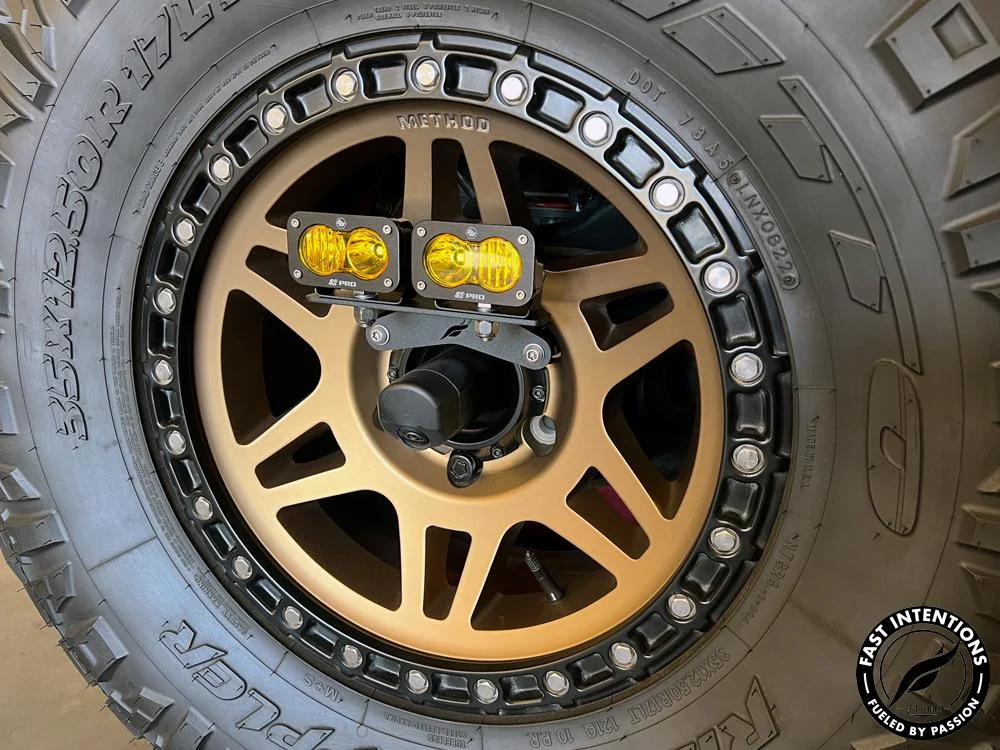

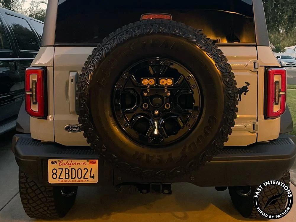

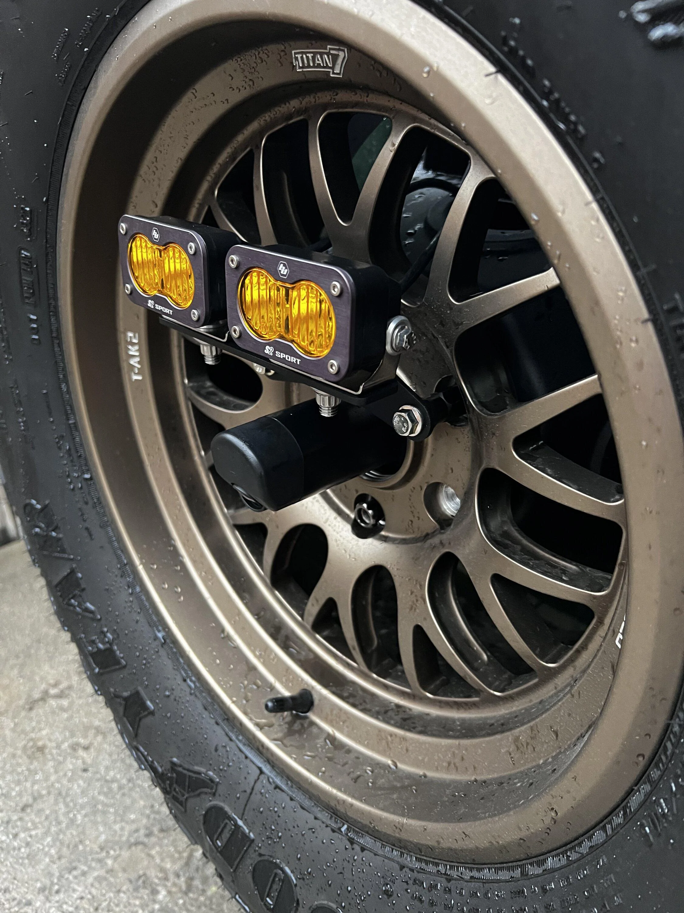

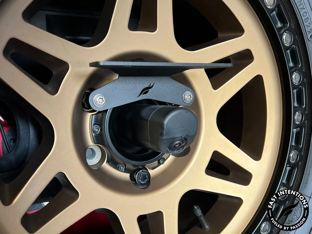

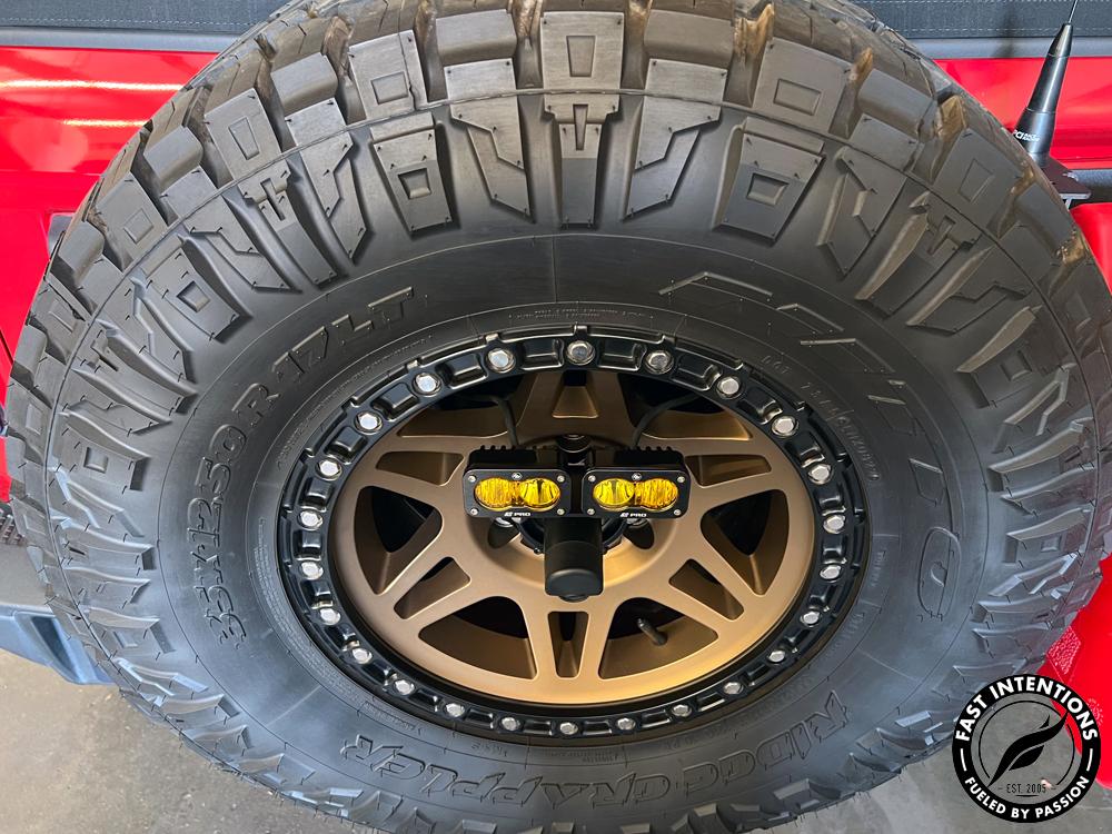

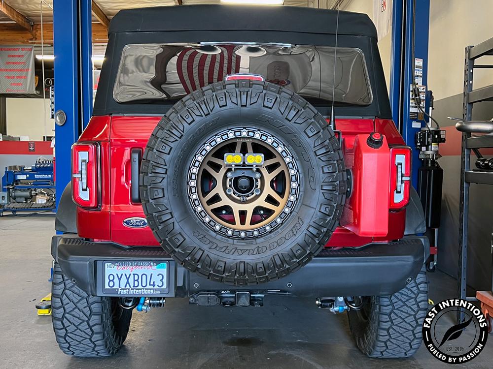

Fast Intentions has released our Universal Chase Light Mount aka " The Uni ".
These affix to the spare tire lugs and can be used with most offroad lights allowing for ultimate adjustability and a sleek / low profile look without blocking your entire spare wheel. Will fit with OEM wheels as well as most aftermarket wheels.
BRONCO CHASE LIGHT MOUNT | Fast Intentions
  • CNC Laser Cut from 10ga Steel.
  • CNC formed specifically for 6G Bronco.
  • Durable 2 stage textured black powder coated finish.
  • Optional threaded lugs with hardware for easy installation.
  • Optional locking hardware with safety Torx tool to protect from theft.
