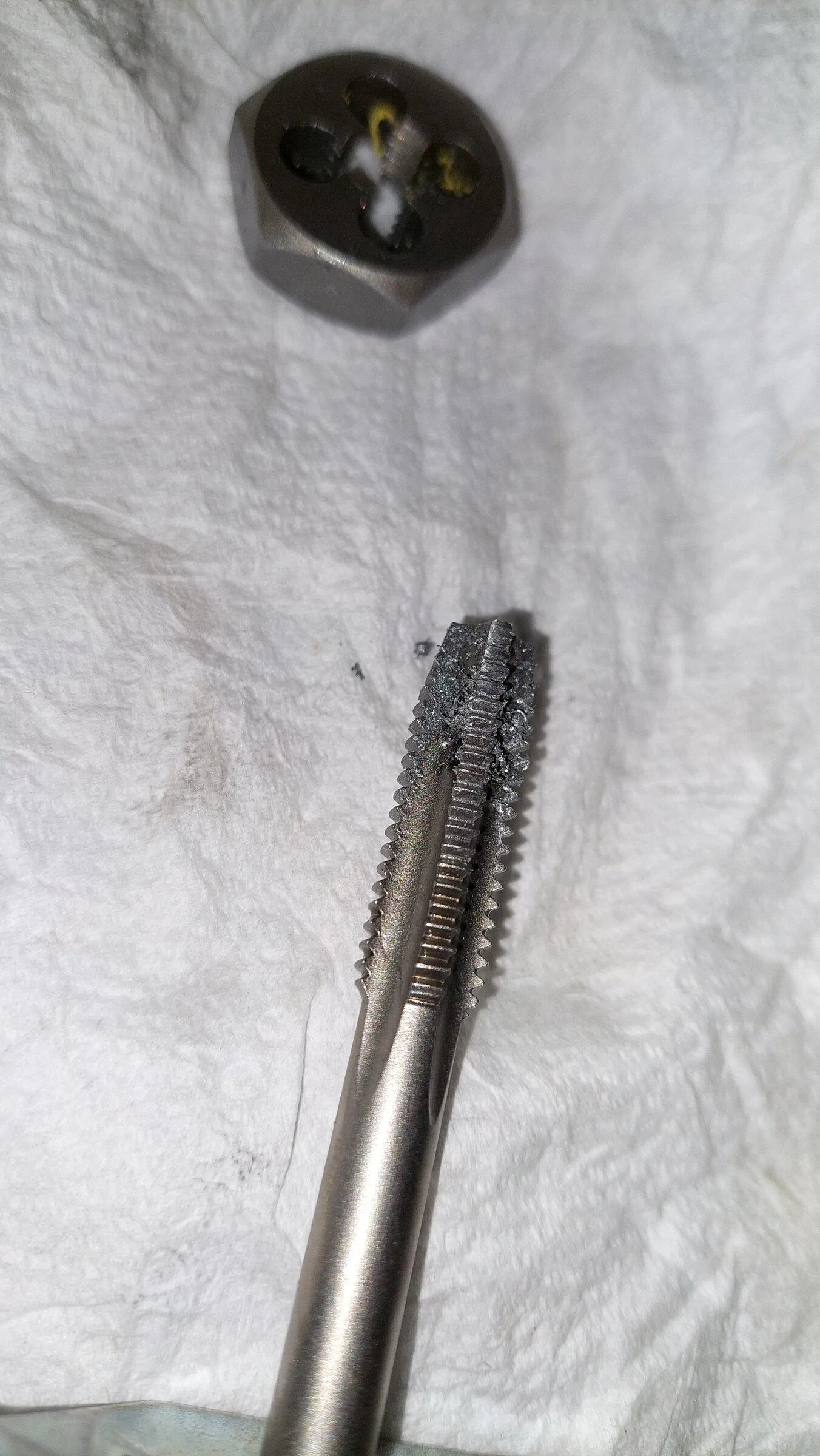

Found i had a die.

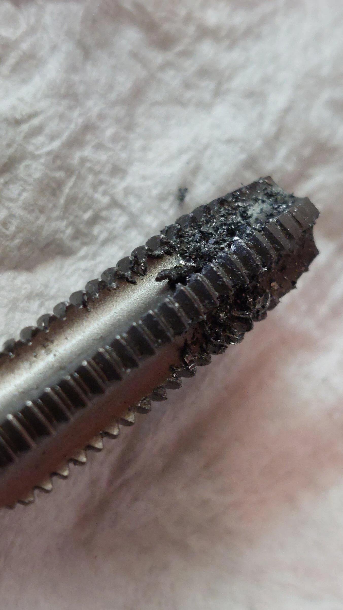

Excavating the hole with bad bolt. I think the bad bolt chewed the female threads
I'm my opinion, so far, it's the bolts. They really needed a lot of cleaning up to screw in smoothly. I cleaned up a good bolt and reinserted in a hole i didn't tap, it fit fine. So the wheel hole was good, but the bolts are sloppy.
I definitely wouldn't do this again without a tap and die handy
I wonder if it's the bolt threads, measuring them they are not consistently 1.5, not perfectly anyway

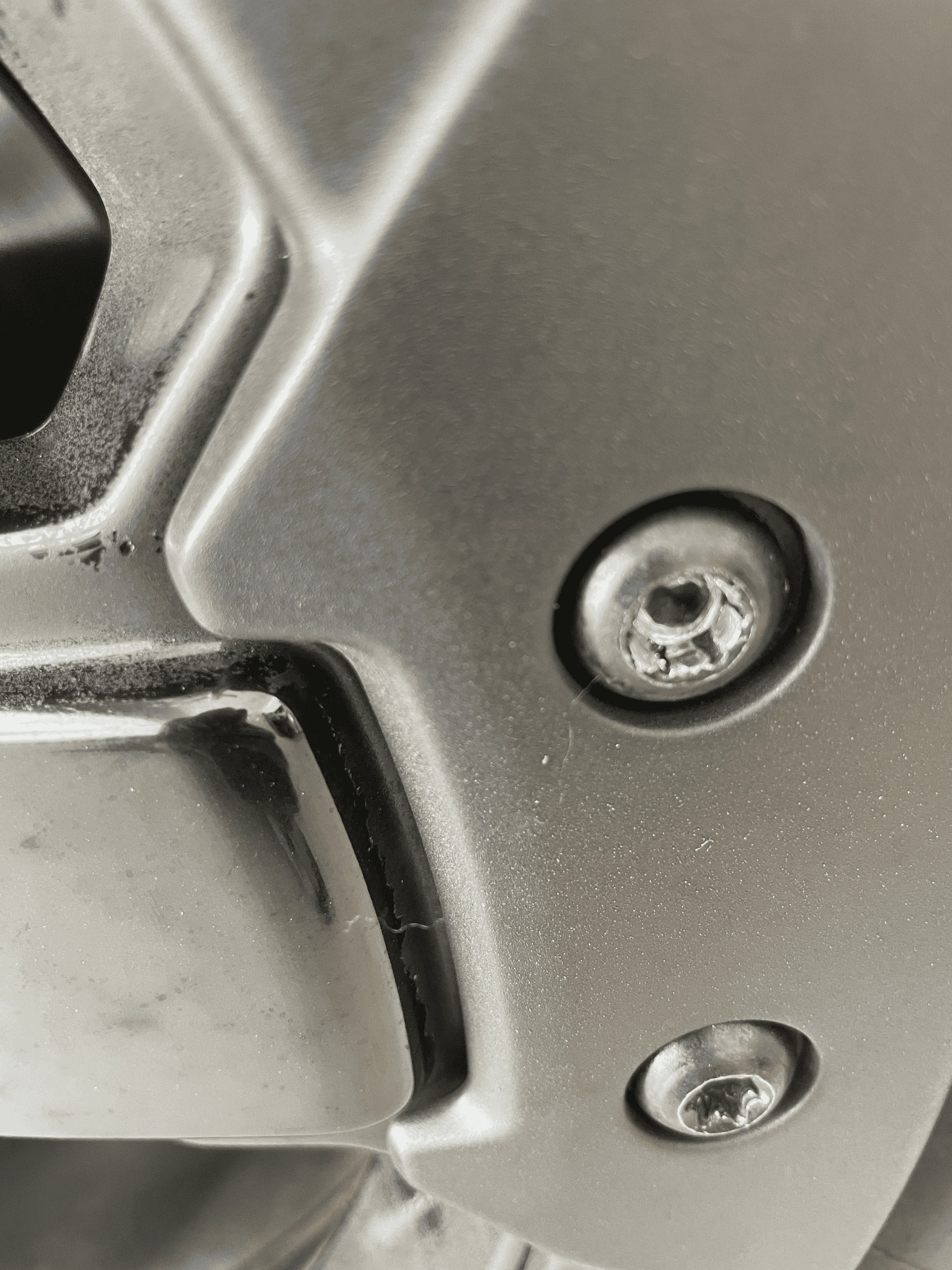

Sorry for reviving this thread. Took rings off to paint. Came off fine. 59/60 went back on relatively ok. #60 is stuck about 1/4” out. And of course I have stripped the head. Tried everything to get it out. Going to try and get a bolt welded on so there is something to grab onto and then extract.
Wish I would have read this thread beforehand. Especially cleaning off the threads before reinstalling. Makes sense now but did not think of it at the time. Have done similar before on Toyos with no problem.
Thankfully the bolt sticking out is on the passenger side so I don’t see it. Lol

You can also drill out the center of the bolt which we've found generates enough heat to overcome the loc-tite friction. Don't drill the whole thing, just use a bit a couple sizes smaller than the bolt diameter. Bolt is soft and can be drilled fairly easy.

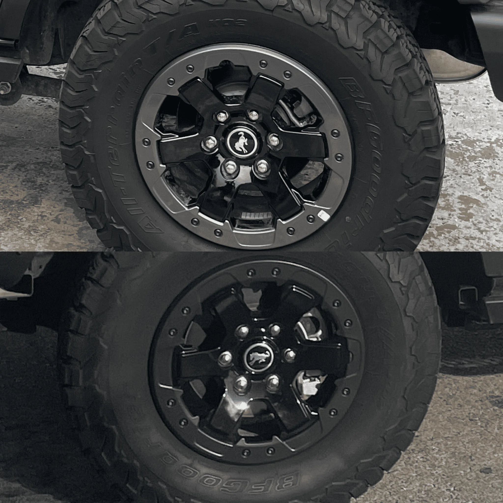

I removed my rings to have them painted. I used an impact drill and everything went beautifully. I was surprised at how much loktite had been put on these but the impact drill ate it up. They all came out straight.

I had to remove the beauty ring last night on one of my Badlands wheels so the black inner wheel could be re-powder coated by my dealer. It appeared to be hit pretty good with an errant impact socket at the factory and had a big half moon scratch all the way to bare metal. I didn't want to chance a tech removing it so I carefully removed all the bolts with the proper Torx socket. I did have to use a breaker bar to initially get them to break then a ratchet to carefully walk them out. Tons of yellow locktite which made them impossible to hand loosen until they were almost completely backed out. Happy to report all appeared to be threaded properly and were not damaged. Now after reading this post I am not looking forward to the re-install.

Removed the rings, plasti-dipped them to see the aesthetic, and now several of them won't screw back in, and one of them is completely stripped. So you are recommending I just take it back to the dealer to see what they can do?
Very frustrating.
