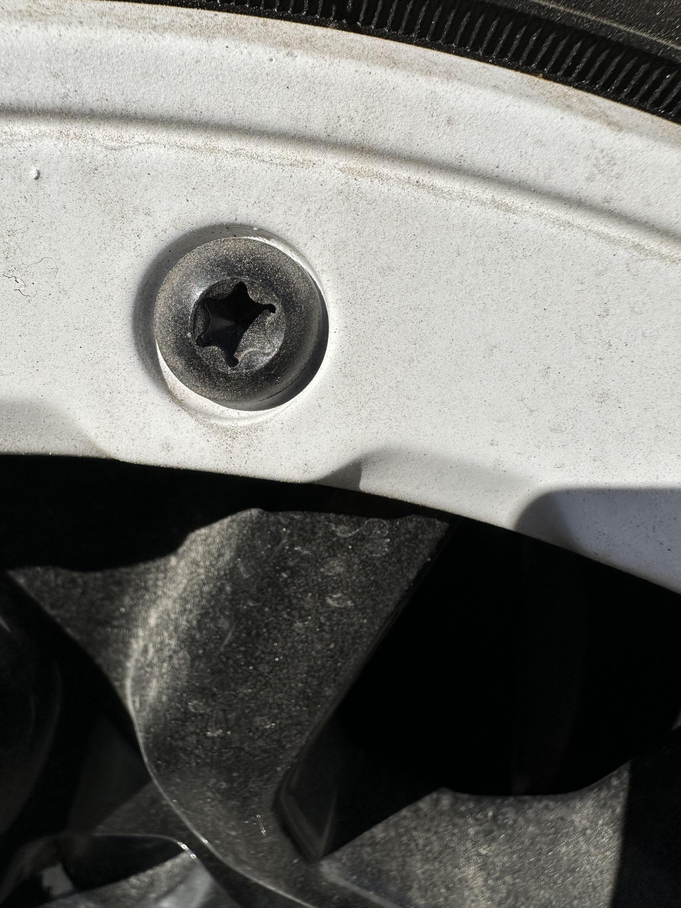

These are NOT Torx Plus. They are Torx. Stop spreading misinformation.
I did in fact use a TorxPlus bit when I removed mine. I just went back and checked and sure as shit, I used a TP40, not a TP45 or T45. Probably why I stripped a few with the power ratchet :) Thanks for the correction.

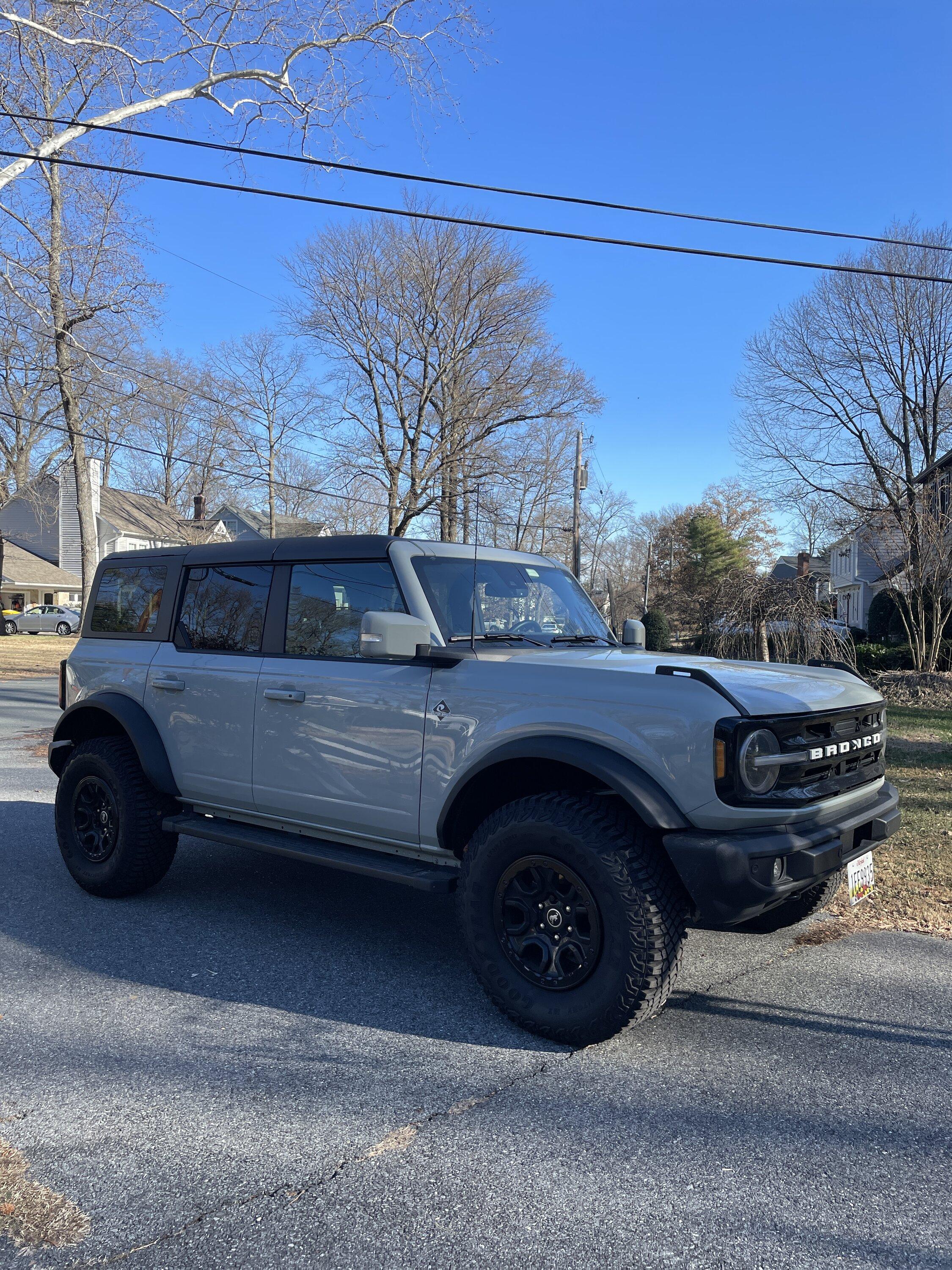

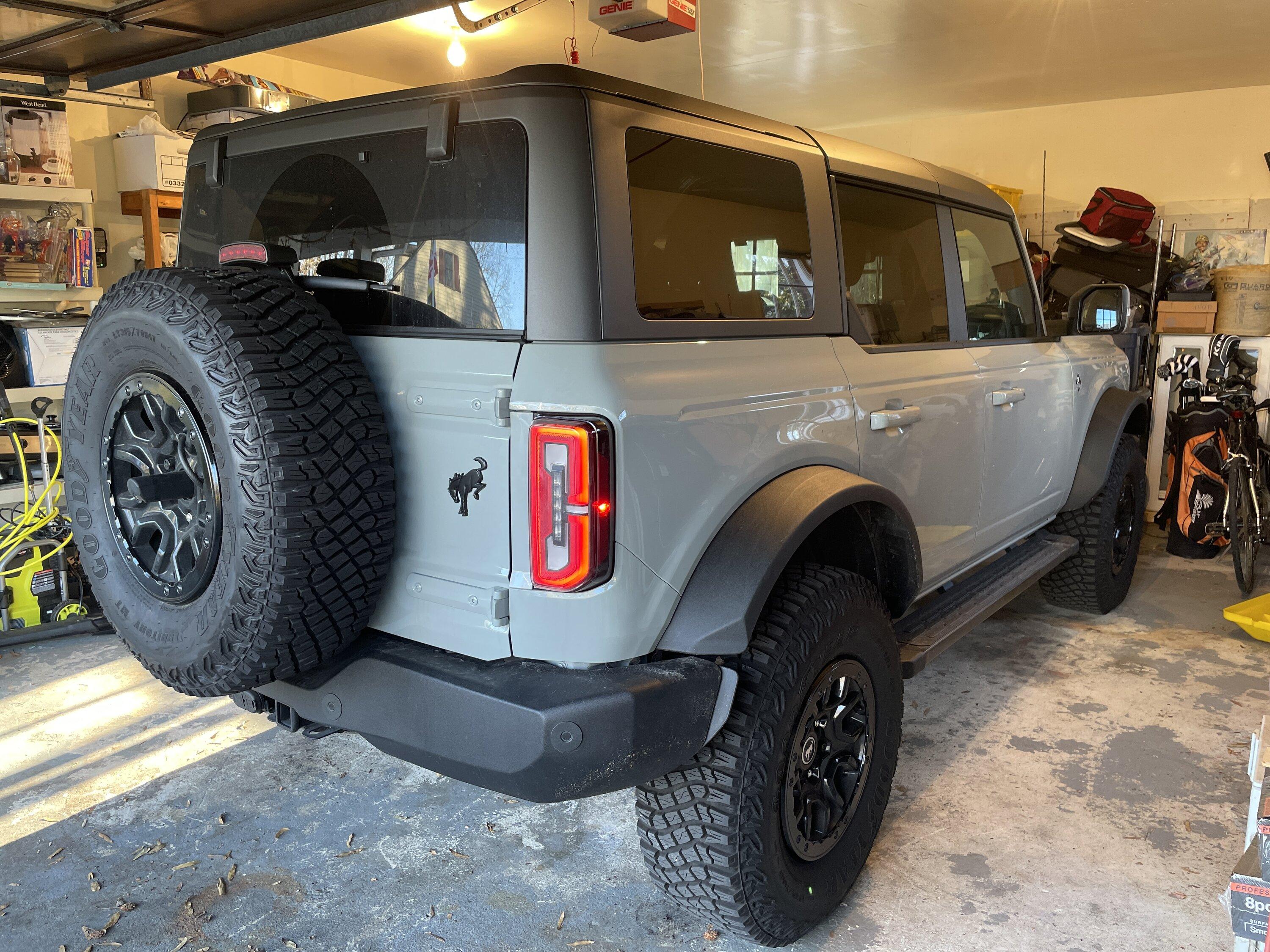

I decided to bite the bullet and paint my beauty rings black. I had no issues at all removing or reinstalling the bolts, although I did take it pretty slow and did it by hand (no electric or impact) given all the previous comments on this topic. Very happy with how it looks, I’m done for now, I really like it the way it is and probably won’t be changing much else.

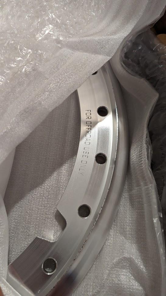

I bought Sasquatch takeoffs specifically to put real beadlock rings on them so leaving them alone isn't an option. Hopefully I won't have too many messed up ones.
How did this turn out? Actual beadlock rings?

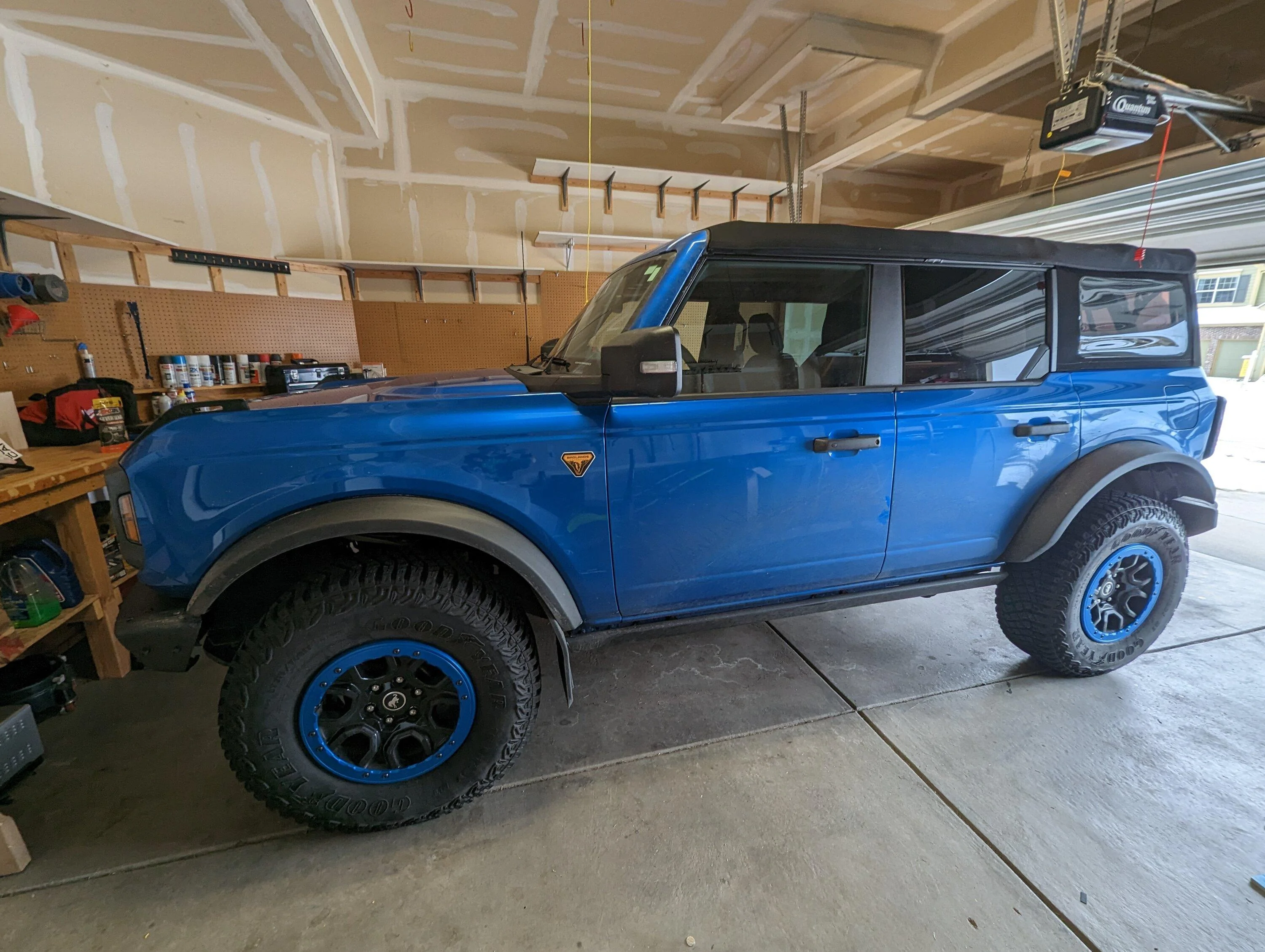

Did you paint or powder coat? Velocity blue rings🤩
I painted. I was getting quotes for powder coating of like $400-500. I bought the paint for $70. Unsure of durability long term but time will tell.
👍what was the process to get color matched aerosols? Where did you get it? I’m also along front range CO, thx
