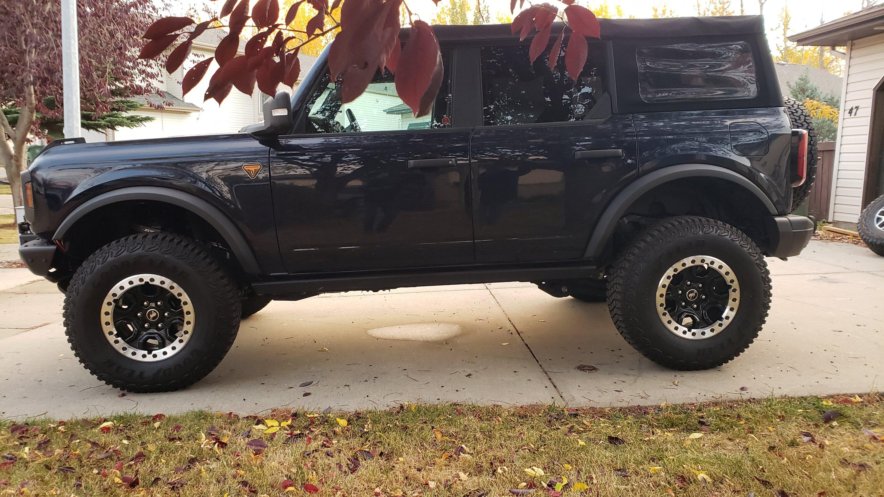

I removed my screws with a Snap-On socket and an electric impact gun. They all came off just like any other bolt I have ever removed. The new Ford Beadlock Bolts are torqued to 48 Ft. Lbs with NO Locktite or Anti-seize.
Here's a picture of the new Ford Beadlock Rings.
