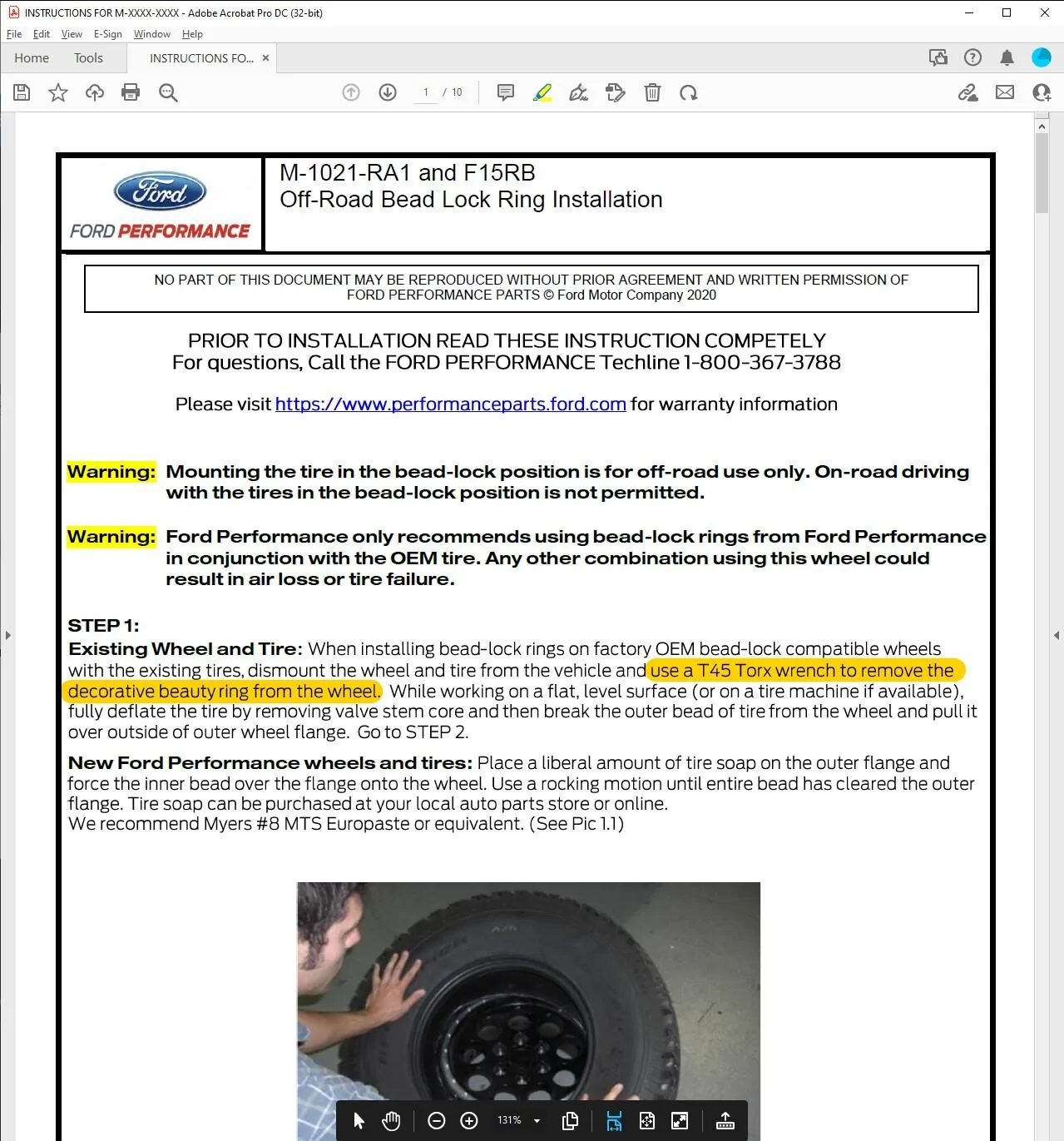

Regular Torx 45 (T45)...
Unfortunately, there is quite a bit of misinformation floating around the Internet and on YouTube videos about this issue, but @coadr and @Synyster06Gates are correct.
Ford actually specified regular Torx 45 (T45) for the “decorative beauty ring” bolts — see below — so use a regular T45 bit if you want to minimize the possibility of camming out and stripping the bolt heads.
Although a Torx Plus 40 (TP40) bit will "fit" (sub-optimally) in the T45 recess of the bolt head, using a TP40 bit will likely lead to some stripped bolt heads, because the surface area of the contact points will be less than the larger-sized, specified T45 bit.
