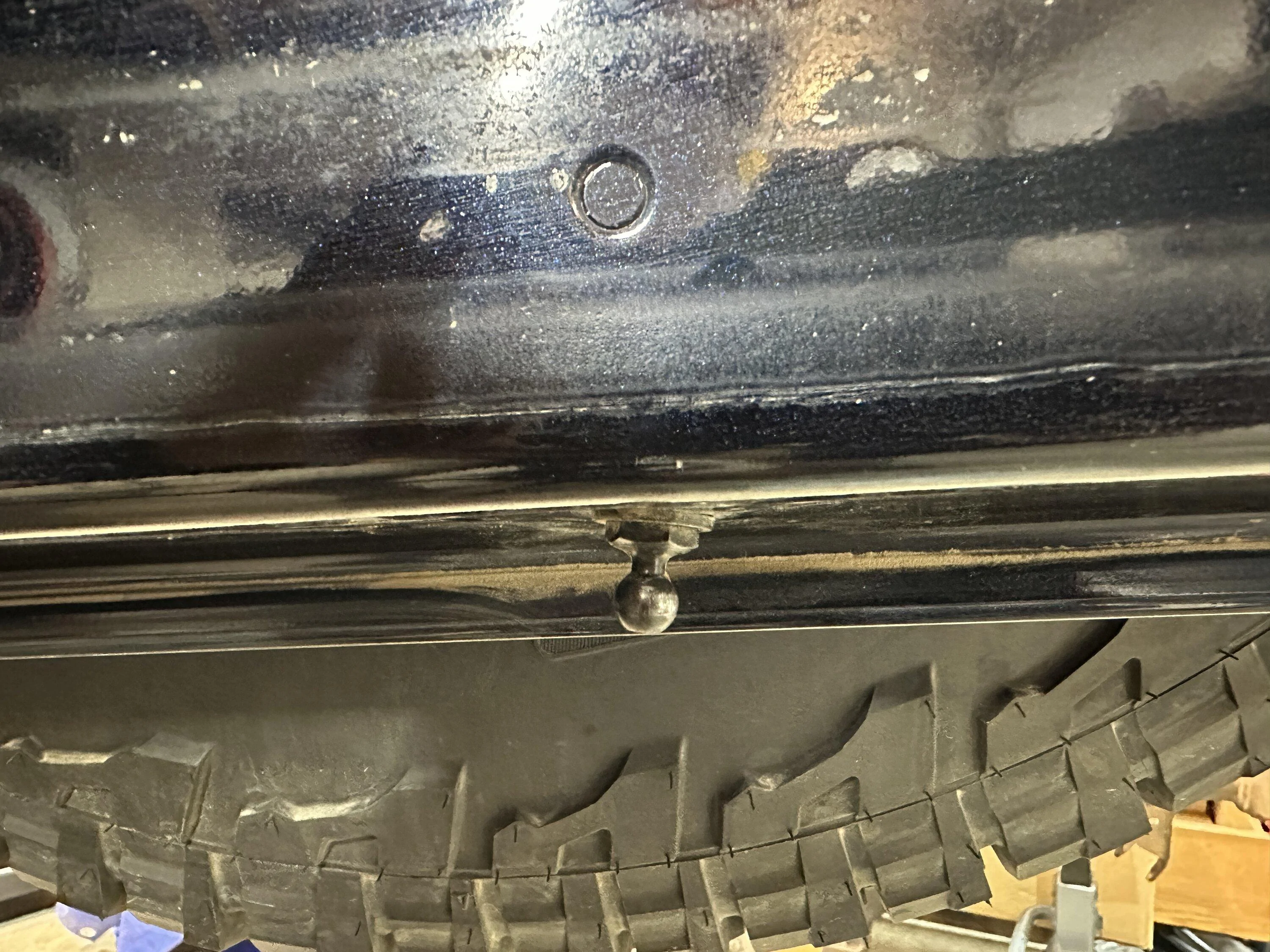

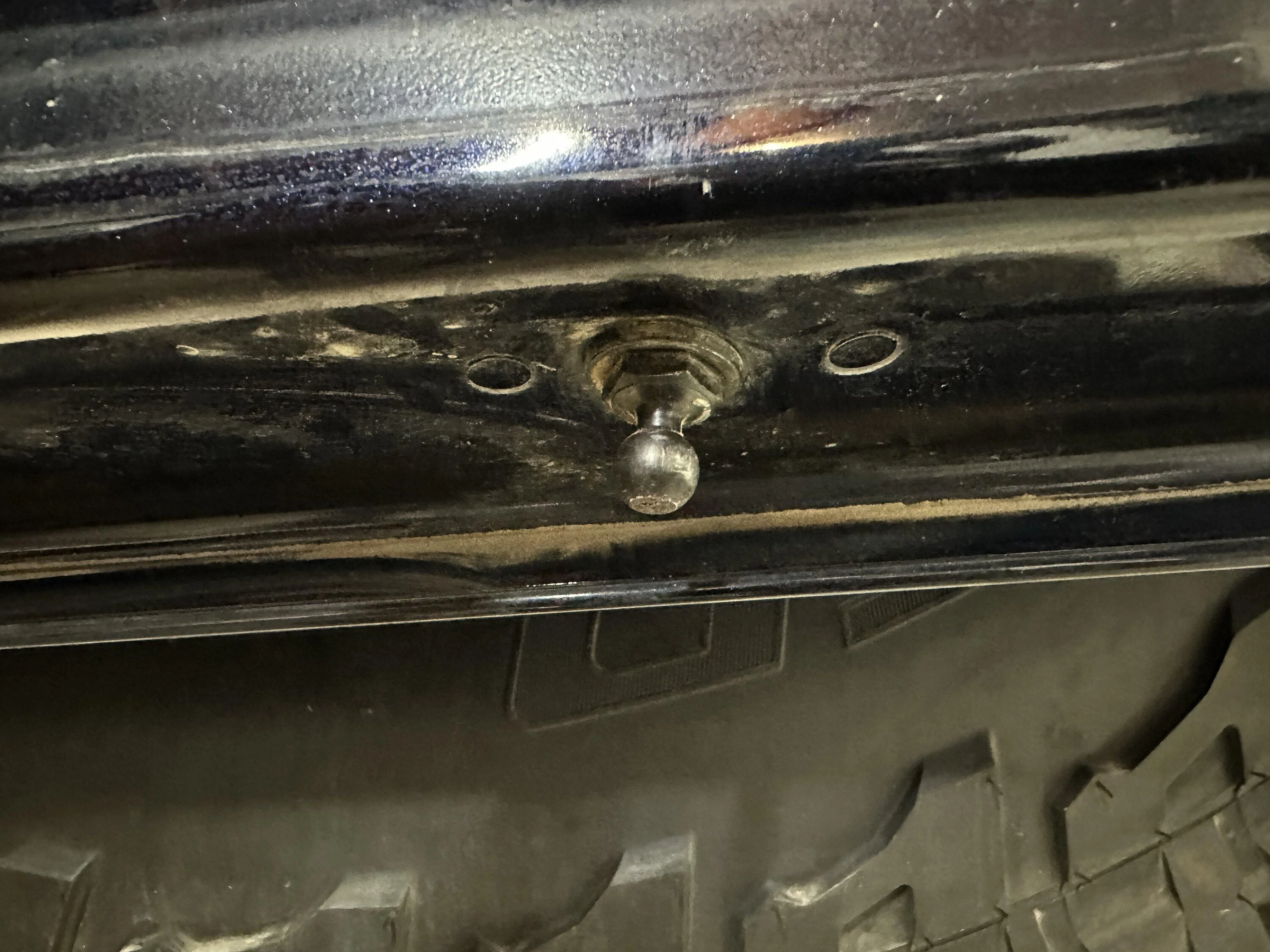

When I received mine, I went out to install it and noticed that my strut bolt going into my tailgate was fatiguing the tailgate, causing the metal skin to bend, almost to the verge of cracking. With time, I know that my strut would have snapped free of the tailgate, causing irreparable damage to my tailgate strut mounting location and possibly taking out my tail light.

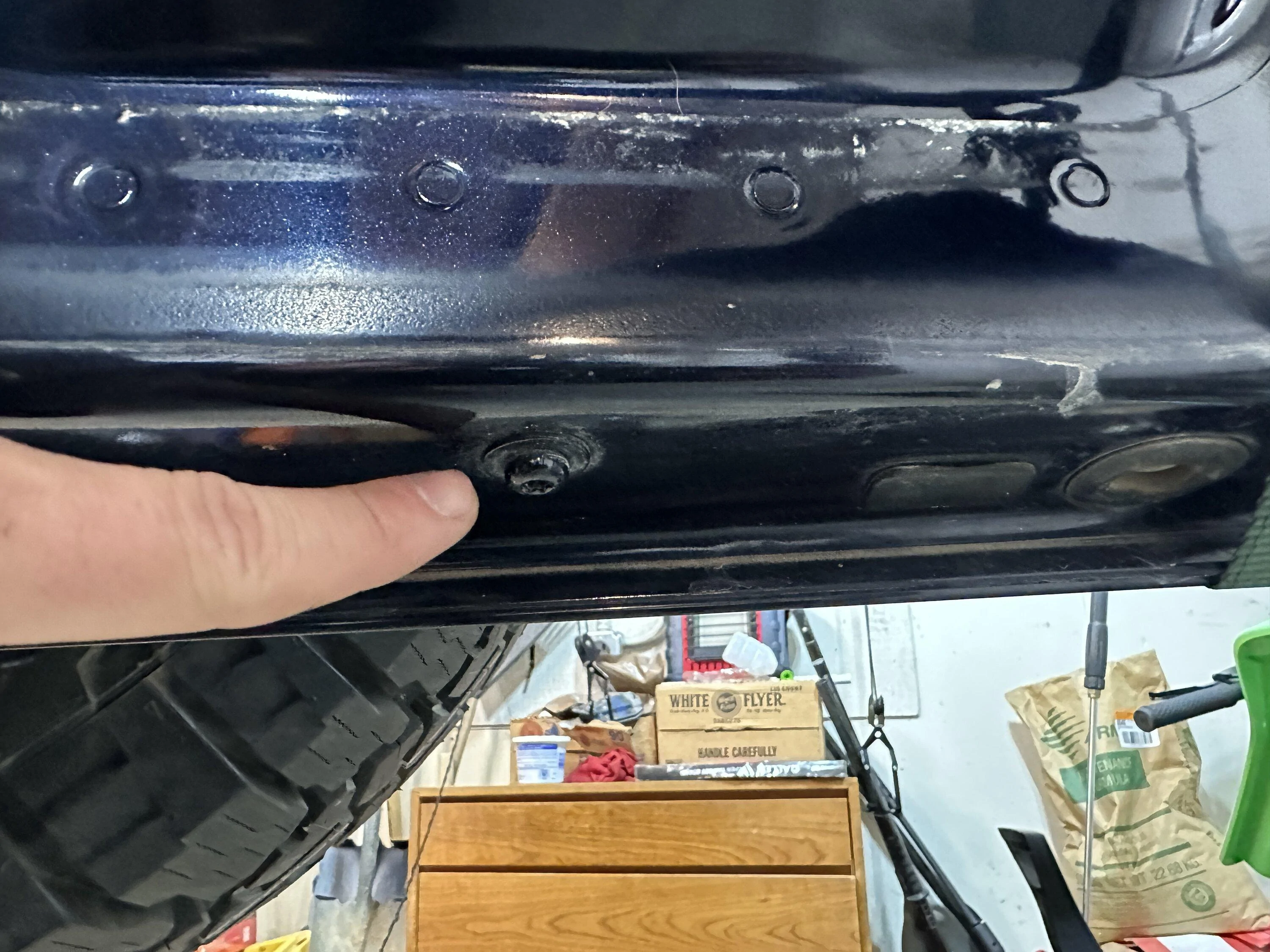

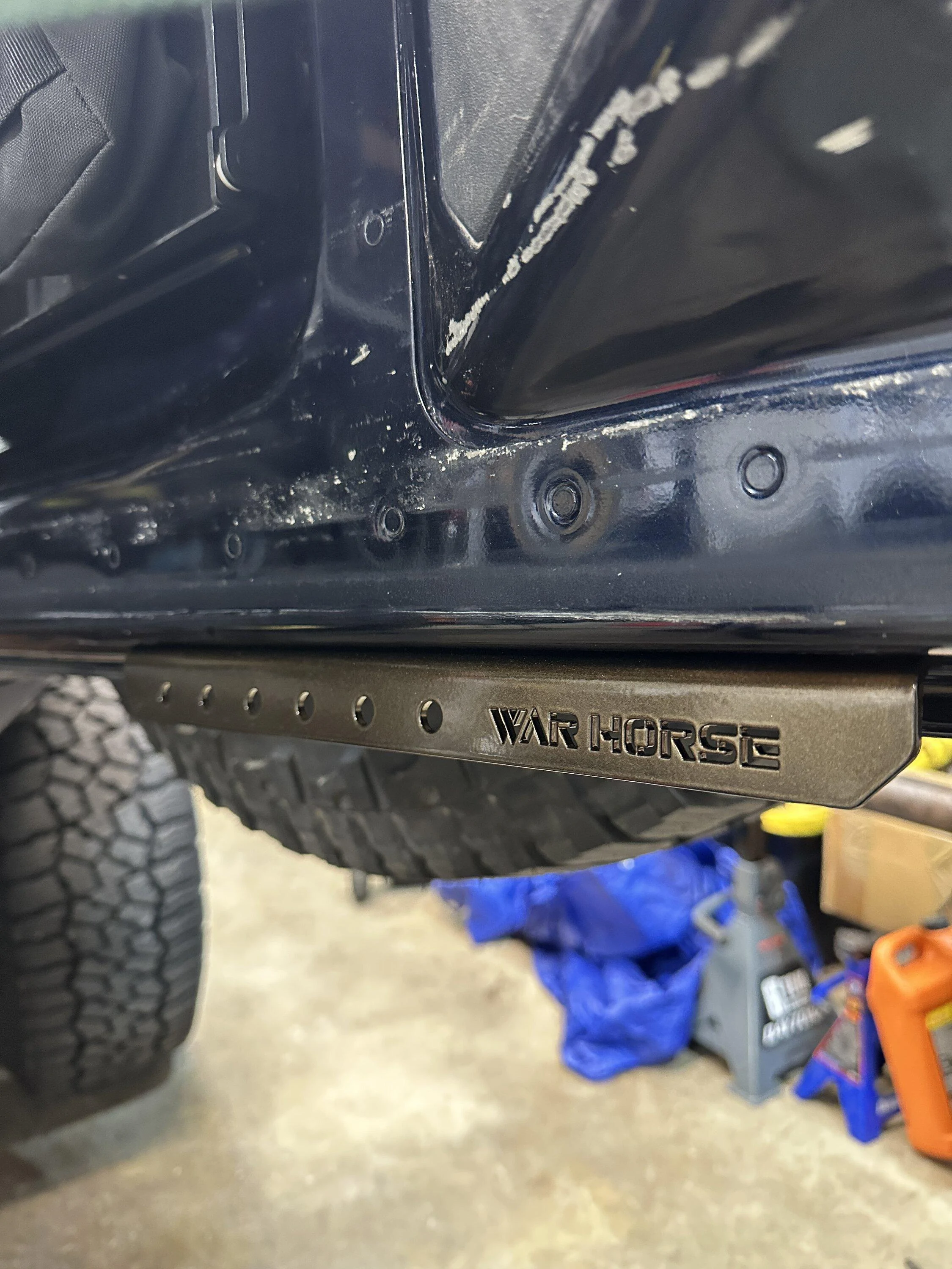

This product relocates the strut to the angle iron and not only allows adjustability. But also adds strength by utilizing another bolt location in the tailgate to create two points of contact, strengthing your strut mount in the process.
I’m a huge fan so far, went and got mine powder coated (comes in stainless steel).
Works on both OEM strut and Hammer built strut.

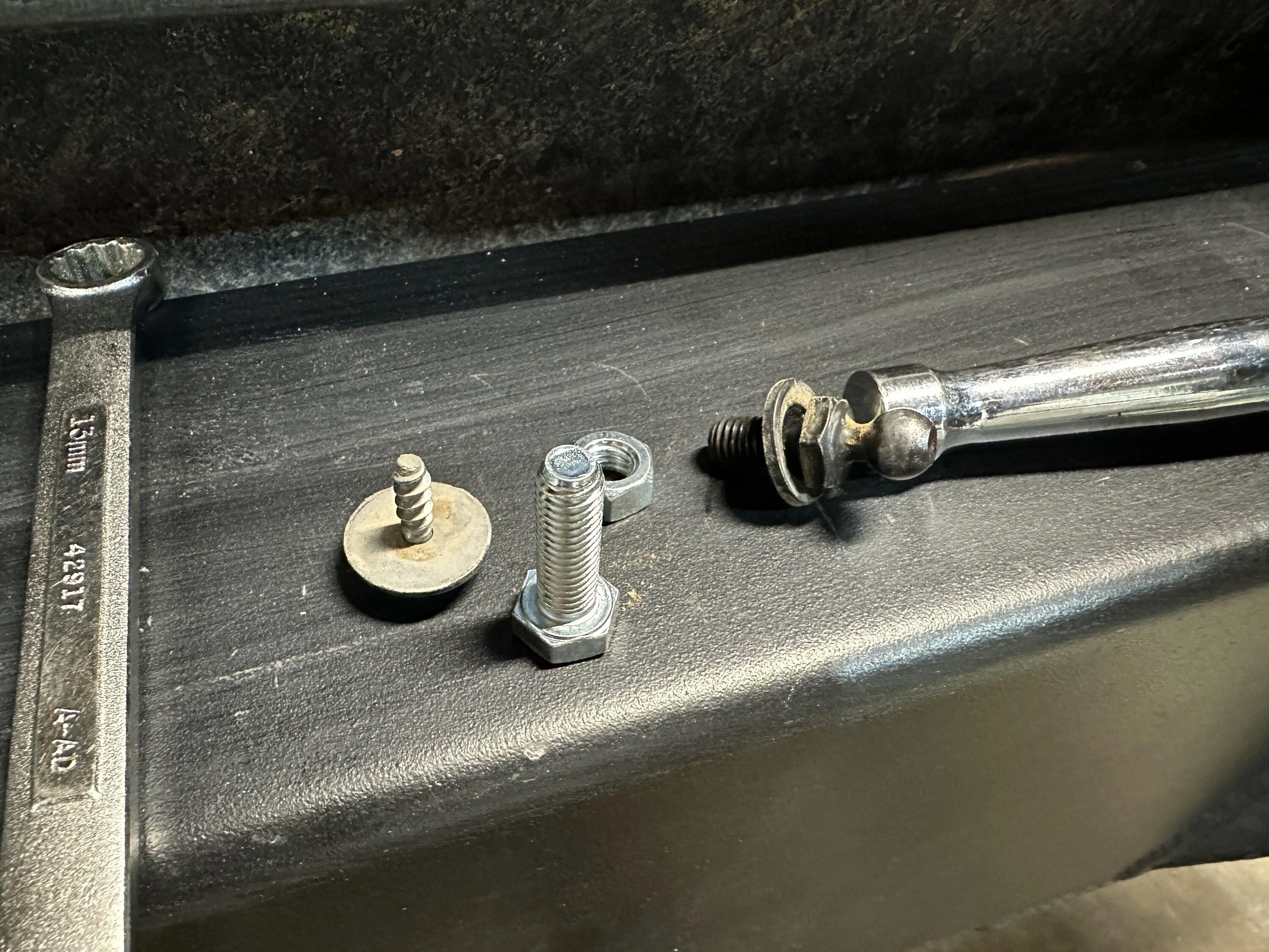

Takes approx 2 minutes to install with a half inch socket and wrench (or 13mm), a flat head screwdriver and a T30 torx.

It does not interfere with the tailgate or the interior space at all.
