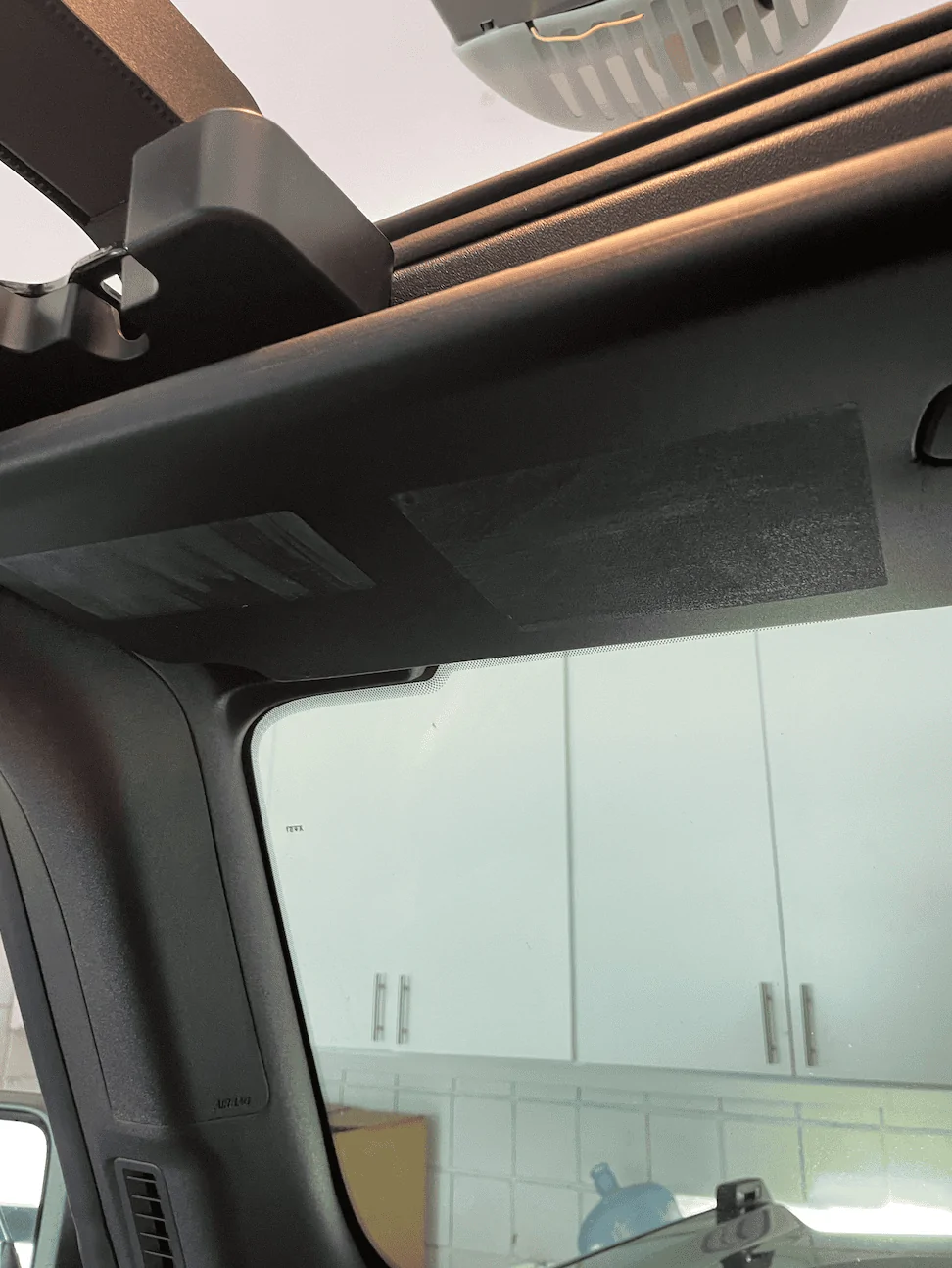

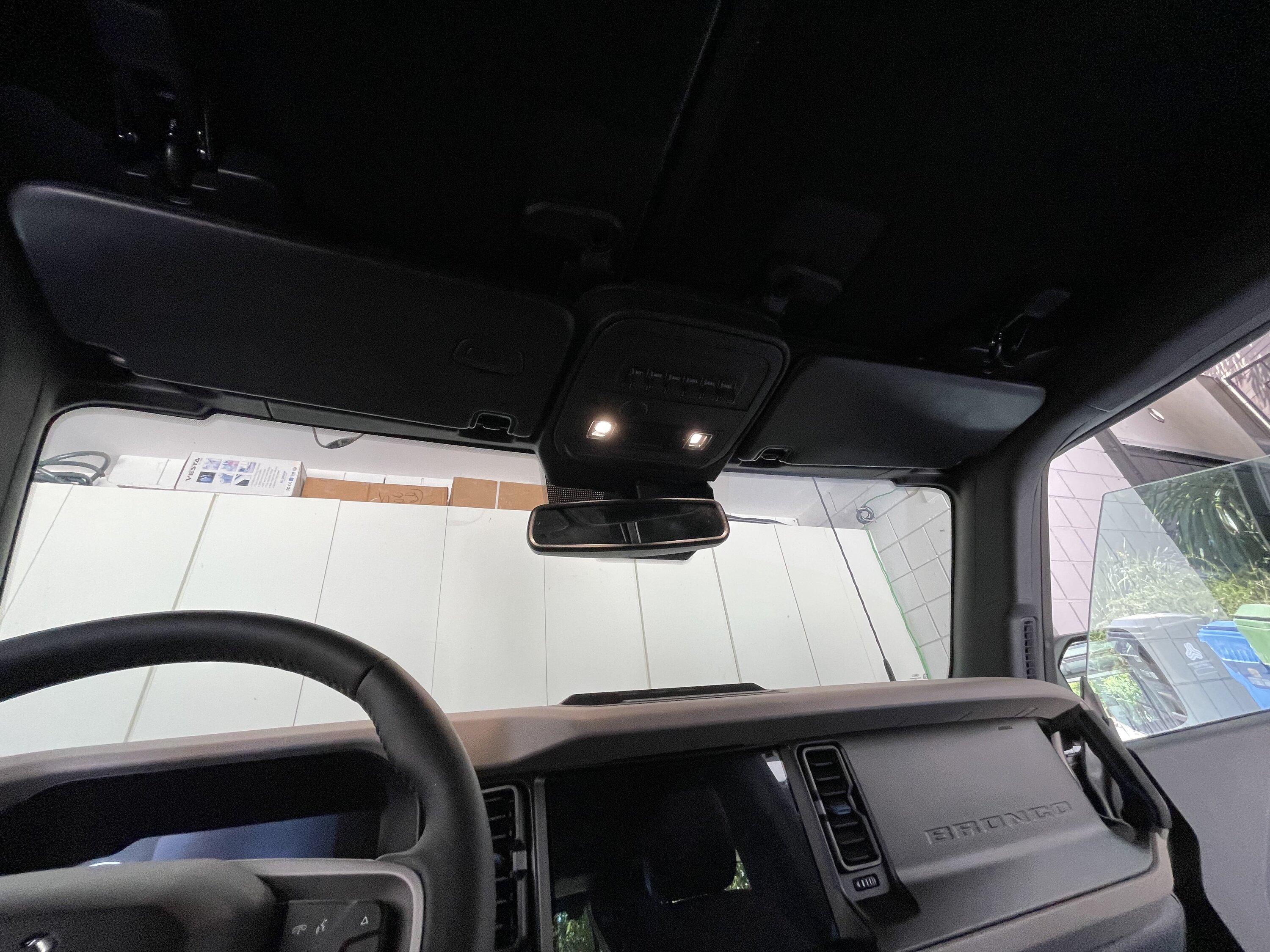

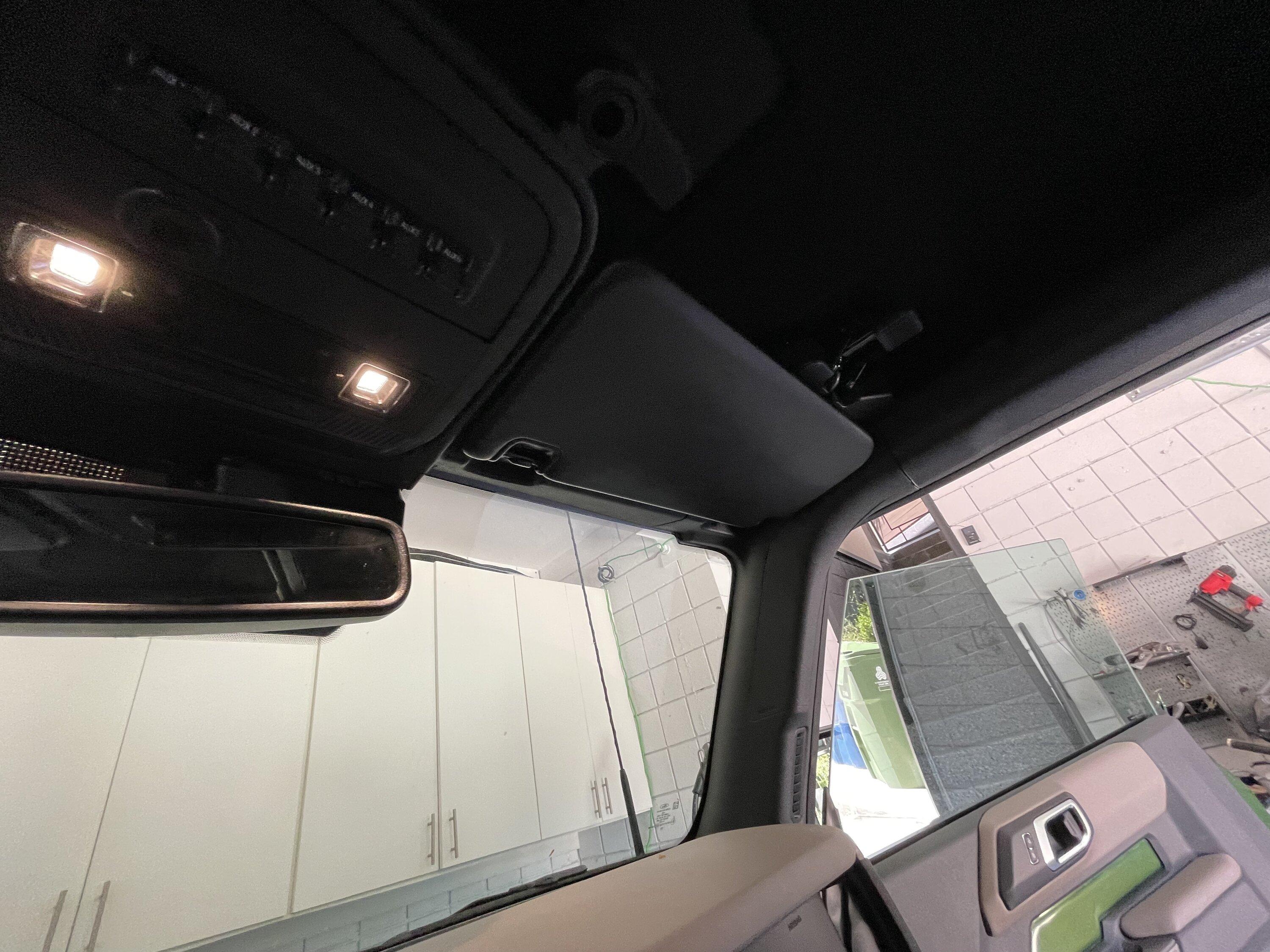

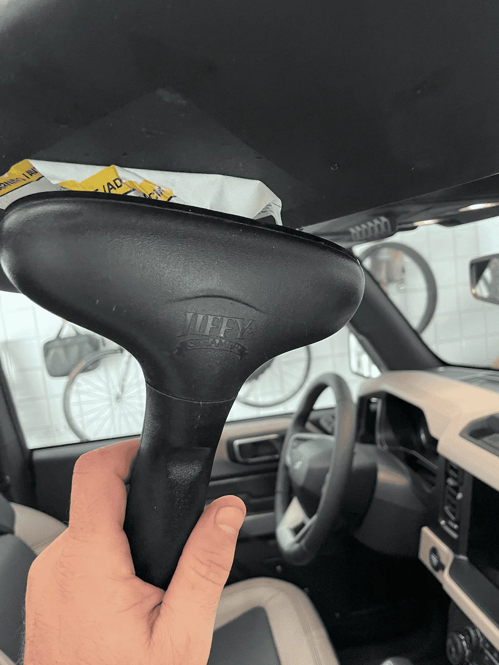

Removed my Warning Decals with a steamer this past weekend, and it took about 30mins. Using pliers once you get some of the sticker off makes it a quick removal holding the steam up to it and grabbing the sticker with needle nose pliers. Be careful not to burn yourself. Eventually you will need to twist the stick around the pliers to get the stick taught, as you slowly remove it.
Next step will be to remove the sticker residue partially with steam and something to help lift the residue.

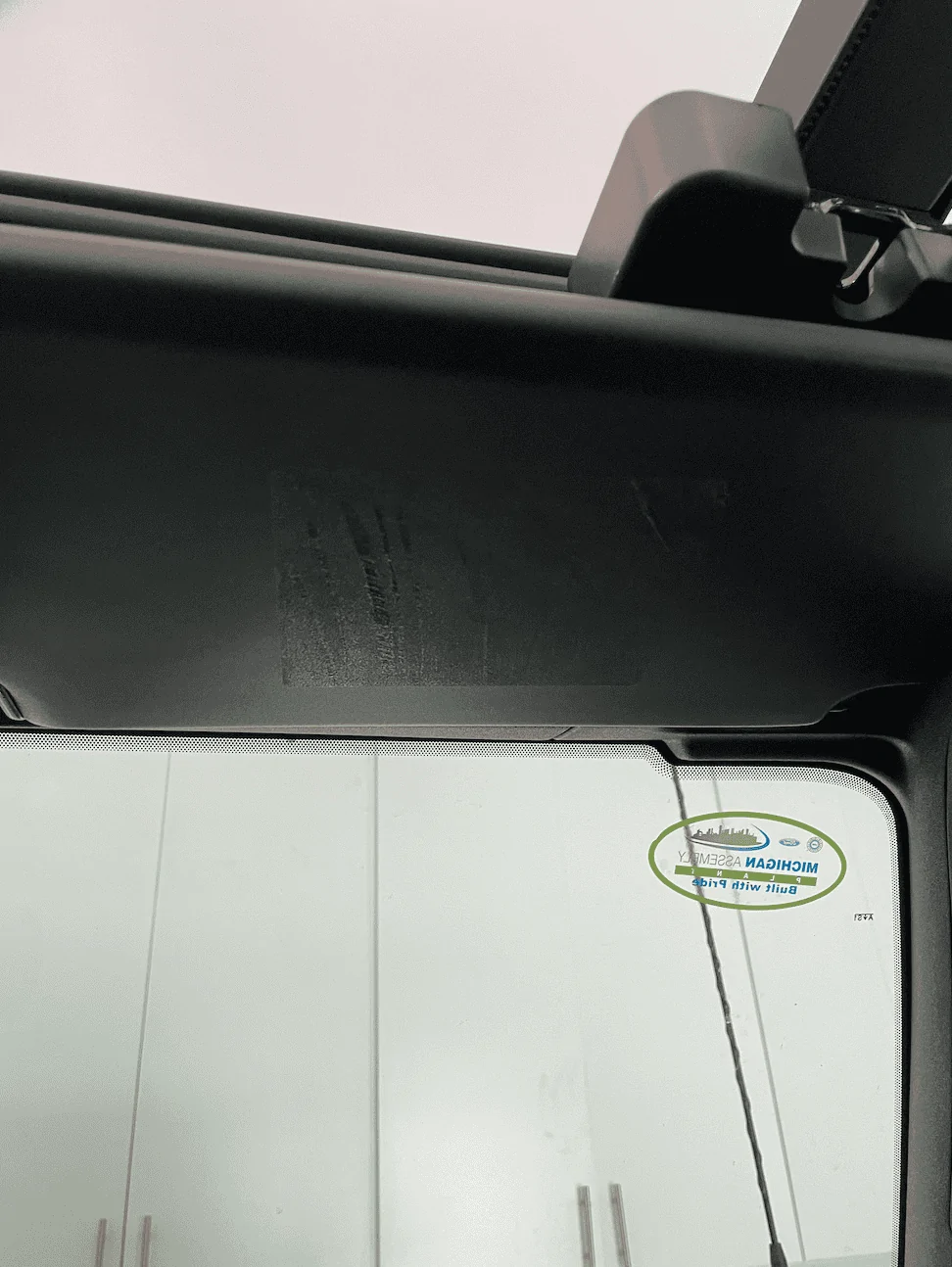

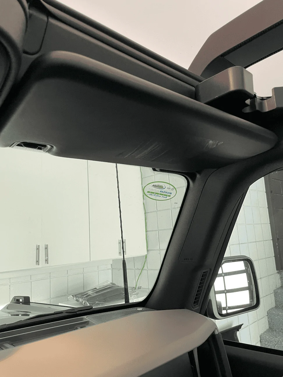

Just finished cleaning up the residue, It took me another 20mins. So 50mins of my time total, a steamer I already owned, and $5 worth of acetone. Looks perfect, and better than any sticker overlay.
