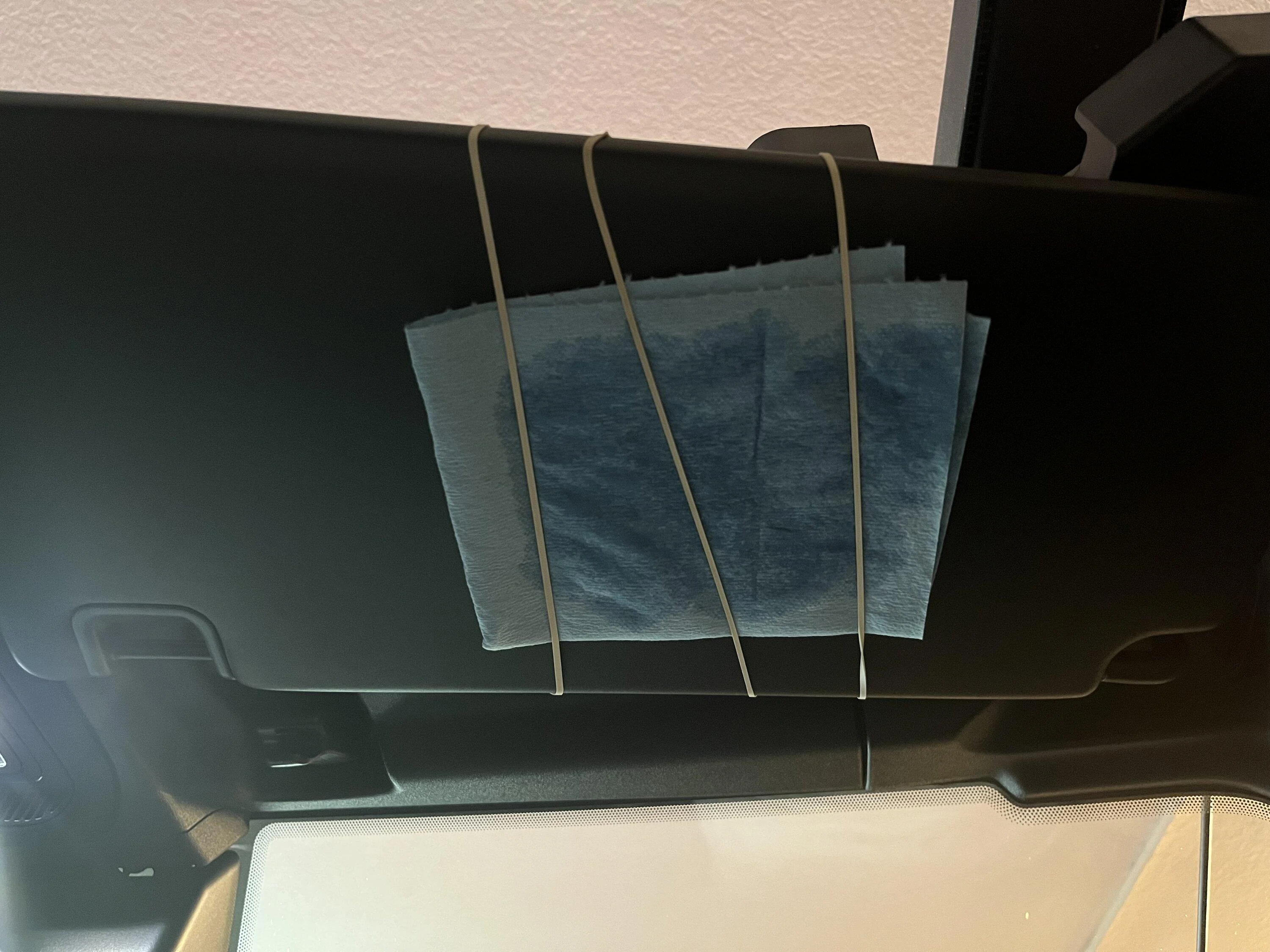

Final update:
Ended up taking the visors out all together - that was a good suggestion and easy to do (1 7mm bolt and it has a clip that slides forward to come out).

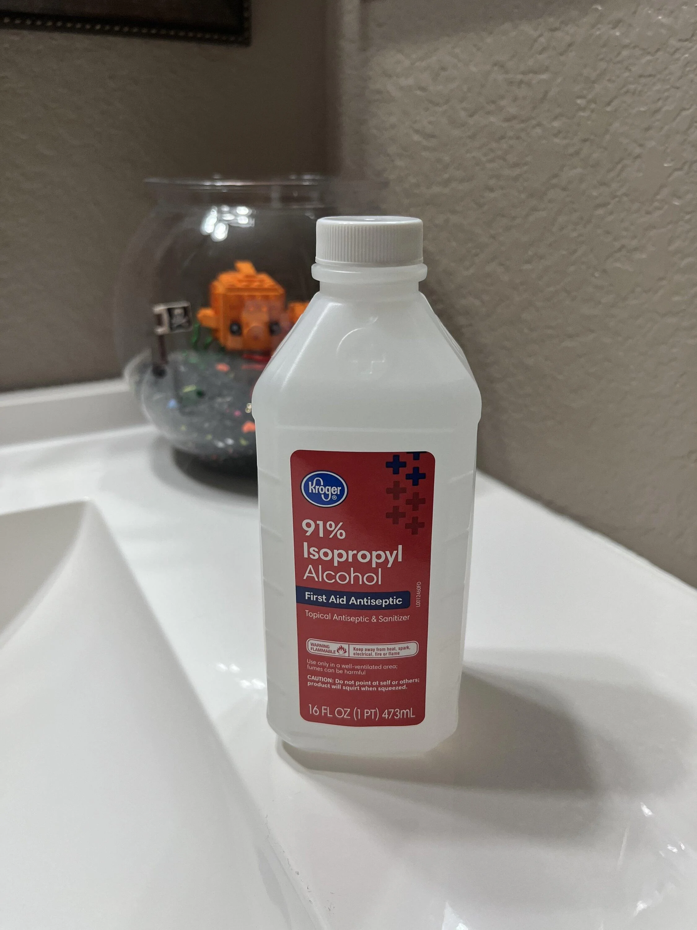

So, alcohol wouldn't touch this glue.
GooGone - the regular stuff - wouldn't touch it.
I had this GooGone for Super Glue stuff. https://www.amazon.com/Goof-Off-FG678-Remover-Strength/dp/B07NP8NZ5F
That stuff... well. It kinda worked. It would melt the glue pretty quickly - can see it turn white. But it dries or evaporates really really fast, and once it does, the glue re-hardens.
So, I started out wetting it down, and wiping with a paper towel while it was still wet. That was a bad idea. It more smears than comes up, and it dries so fast and gets sticky again bits of paper towel go everywhere.
So I moved to shop towels. That worked... better, but not perfect.
I got almost all the glue off. But cleaning that up, the chemical was harsh enough to make the plastic look off. It has a dull matte look to it now where the chemical was.
So - long story short... stickers. Go with the stickers. I'll let mine sit and see how a bit of dirt goes with it, but it looks horrible, and I'll probably end up with some visor covers at some point.
